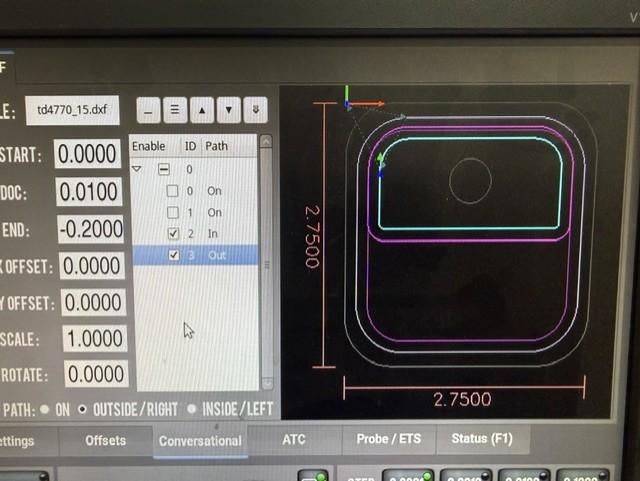

How do I tell path pilot to do a pocket in instead of just on contour from in imported dxf? running pathpilot V2.14
That isn’t an option. Dxf will only cut on either side or on top of the line in the file.
Boo, that’s what I was afraid of. I add a “toolpath” to my dxf and selected that to do the pocket.
