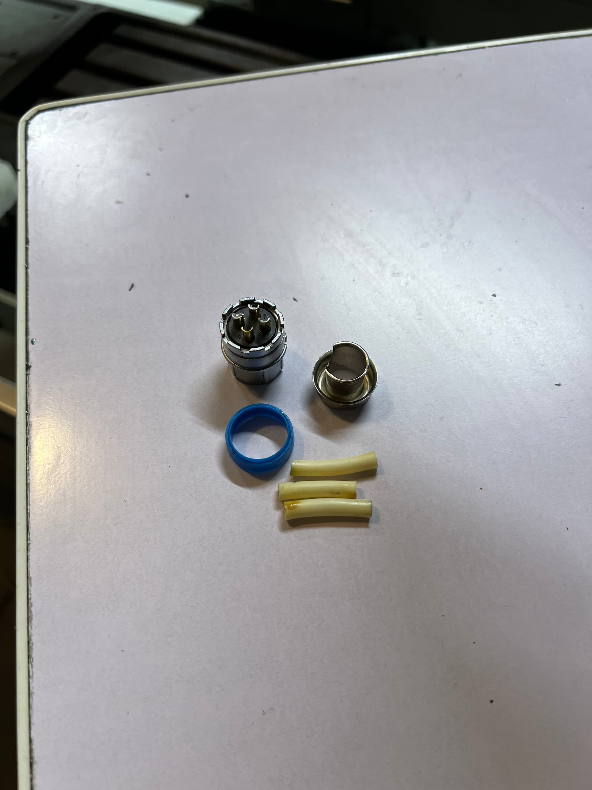

The flexible conduit attached to the X-axis motor on my PCNC 770 is broken at the motor connector. Is there a way to detach the three pins from the quick-connect plug at the panel so that I can pull the motor cable out of the conduit without cutting the cable?
Hi Andrew,
Unfortunately, there isn’t a great way to replace the conduit without removing the connector on the other end. These are soldered in and would require you to desolder them. If you’re a wizard with the soldering iron, it shouldn’t be too difficult, but I know firsthand that it can be tedious.

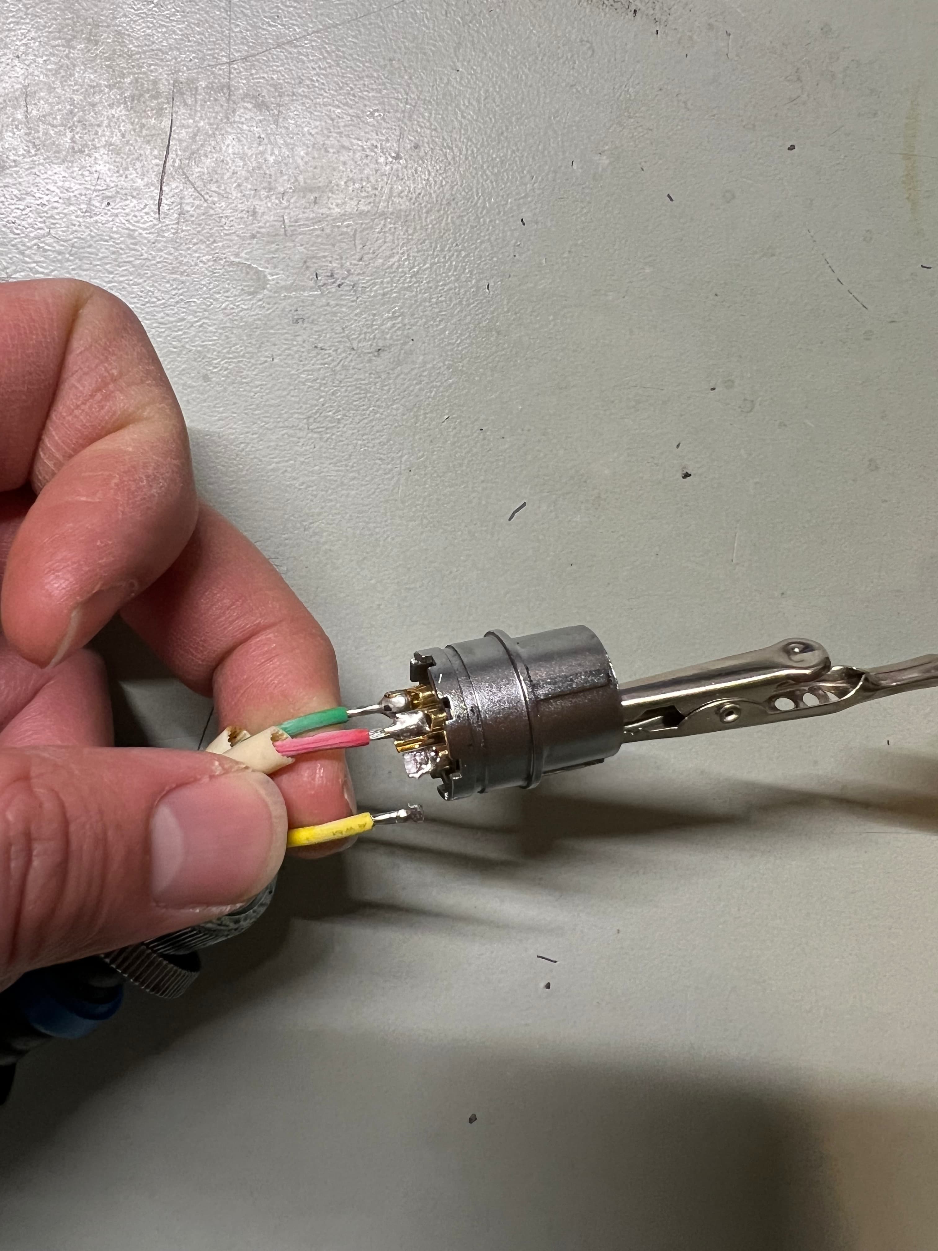

If you do decide to take this on, I’d recommend taking a picture of the wires on the back of the connector before starting; this way, you can ensure everything gets back to where it belongs when you’re done.
Thanks. Desoldering it wasn’t too hard. I used a “helping hand” to grip the pin I was working on in hopes it would help prevent the plastic connector from melting. I don’t know if it made a difference but it did work.
