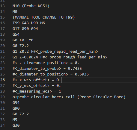

My probing operation from Fusion appears to correctly complete and zero’s my WCS accordingly however it is in fact NOT in the center of the bore, despite the controller re-zeroing in X/Y ??
The controller/path pilot probing routines all work consistently without issue, only when I output from Fusion do I see this. I have chased it around in Fusion such as the ‘override driving WCS’ despite only working in the singular G54 (it informs me it will do nothing lol)

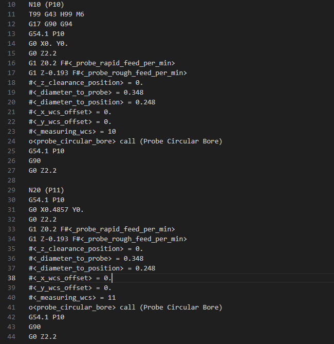

Fusion doesn’t ask what to set the forced WCS to so it defaults to the coordinates of the workpiece from the driving WCS. In the post from Fusion check the #<_x_wcs_offset>, #<_y_wcs_offset>, and #<_z_wcs_offset> variables. Try changing those to set location of the forced WCS.
Linke to the Knowledge Base: CAM Driven Probing
It appears to physically maintain the previously ran X0/Y0 location. The code appears as follows:
If I manually run the probing operation via the pathpilot prior to running the Fusion post version, everything is located correctly and runs well…
The code looks fine to me, what is the deviation you’re getting for the X and Y?

I am actually having issues with running the code below. Picking up two holes of the same diameter, first one works fine but the second one roughs the +X retracts and then slow probes the -X till it over travels.

You are correct that for any wcs location you can probe whatever feature you want.
Let’s say your using G54 and you have set its location to the approximate center of a 1” bore. In your Fusion drawing your part has a 1 “ bore and you use the in- process probing routine to find its center. When you run the program it will reset the G54 to the exact center of that bore where it happens to be, the next part may be slightly shifted, running that probing routine will reset G54 to its new exact location.
Now say you have a different part with a 2” bore whose center is in the same location in the vise.
A different fusion drawing with the 2” bore and similar probing routine is posted and run, same thing happens - the probing resets G54 to the center of the bore.
What you cant do is run the program for the 1” bore with the 2” bore part in the vise

This is what I had hoped for and anticipated and, unfortunately is not what is happening.
The ‘second’ fixtures bore is shifted by as much as .03 in X and .01 in Y and the controller ‘updates’ to zero after the probing operation, however the probe is physically actually in the same location as the ‘first’ bore (aka the last run parts)
