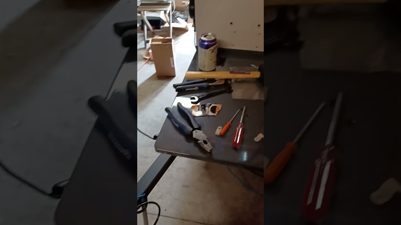

Pretty sure that we are going to have to address this problem with a service request. I’ve had this problem twice again and it does seem to be temperature dependent. Here in North Carolina it doesn’t get extremely cold usually. The first time it happened though it was extremely cold for our area. Both recent times it wasn’t terribly cold but as soon as I turned on my shop heater and got a little bit of heat in the shop it booted up. I’m mentioning all this in case you know of anything else I can do on my end to alleviate this situation. I took a couple of videos of how it acted before when it wouldn’t boot up and also I e after I cycled the power after the shop had warmed up a bit. I’m going to try to link those here also.
I actually have a job I’m running right now that I’m hoping I can baby it through before making any repairs if necessary.

Did anything else come out of this? I am having the exact same issue with my 8L Operator Console. Beeping, and it keeps trying to boot. It will eventually boot after 5 minutes or so, work for maybe 20 minutes, and then go back into a boot loop.
Yes and no. The final solution was to replace the controller. Luckily mine was still under warranty. No idea what was actually at fault causing the issue.
Yours is actually making it just a bit farther in the boot loop than mine was. Mine wouldn’t even display the American megatrends page…the only thing I would get is a black screen and the beep that I heard yours giving as well.
@Harrison_Reed Couldn’t really make out the beeps in the video. Count them and time the spacing between. Motherboards will beep to indicate problems. The number of beeps is the trouble code which then allows you to diagnose. A single beep typically means all’s well.

So the beeps were, I think, the initial beep you get when the console begins booting up. The issue is that, within a second or so of that beep, the machine will reboot again, beep again, display the American Megatrends splash screen again, and repeat.
It could be a code giving me information, but I feel like it would sit on the splash screen or something while doing that. Instead it goes black again and does the same sequence, over and over.
The other beep I’m tracking is the lower pitched double beep you get when the boot is finally successful and communication to the machine is established. I only get that after the console is able to go past the Megatrends BIOS logo.
I’ve replaced the CMOS battery, and that was the first solution I tried. It is notable that the time is completely wrong after one of these boot loops. I may try a hard disk restore, if that’s possible, and try to get the machine back on a clean install. It could be that the initial update borked it.
