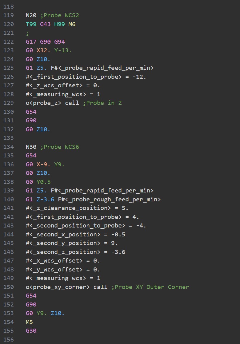

The new probe macros are broken in multiple ways.

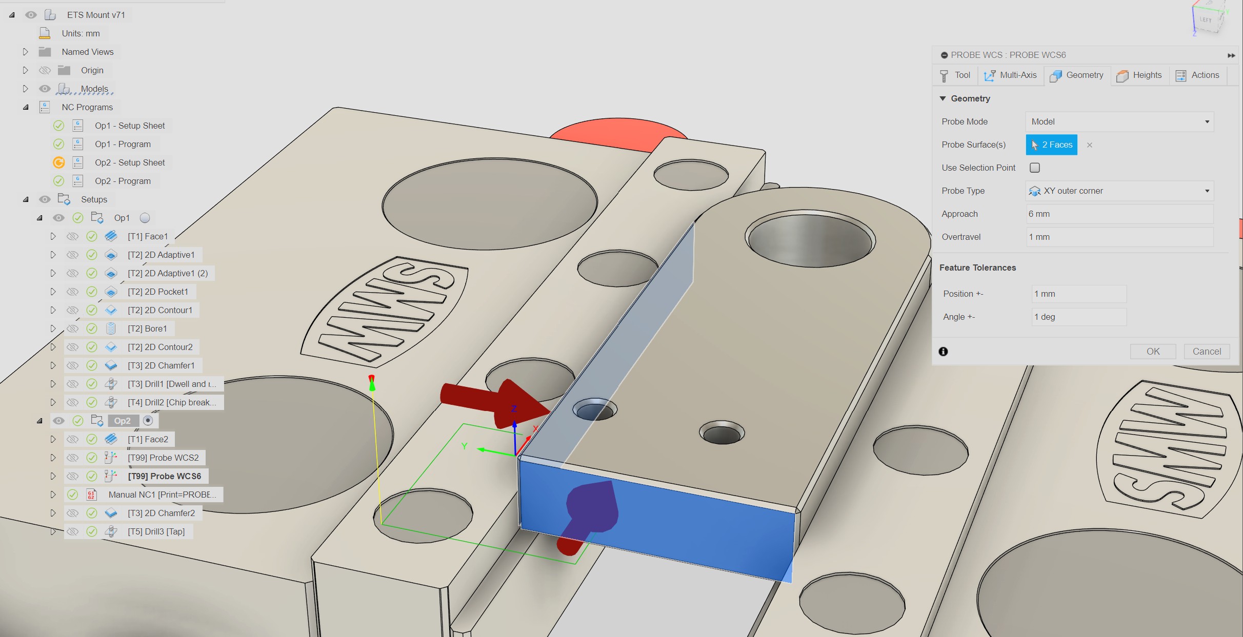

  1. When I use the built in probe routines I get the correct offset for x, y, and z. When using the new fusion probe macros, the z seams correct, but the X and Y will be off by a few millimeters. I believe the macro code and post processor is not calculating the variables correctly. It may not be taking into account my probe ball radius or fusion probe routine variables correctly. Or it may be putting the new origin location based on the stock origin instead of the model. (This is a second op, probing for the model, in fusion the probe mode is set to model)
  2. It appears the fusion variable “approach” and “overtravel” are calculated in a way that prevents certain values form being used. (If you set overtravel too low or high the probe will completely miss the work piece and a not align with what is shown in fusion. (position should not be affected by overtravel, looking at the post processor, the formula used, it is, and honestly does not make any sense)
  3. If the fusion “clearance height” is set to 0 from the retract height, and the retract height is say 5mm from model top, the post processor will not output a retract to safe z after the probe op, resulting in the probe dragging or crashing as it moves to the next probe operation. (It should move to retract height, should it not?)
  4. The built in probe routines moves to touch the workpiece, backs off, then slowly touches the work again, then backs off and moves to safe z. The built in macro only moves into touch the work piece once, then immediately moves to safe z (assuming you set a clearance height greater then 0, see #3). This causes the probe to drag, it should move away before moving to the next op. (or ideally act exactly like the built in probe routine)
  5. The fusion “feedrates” for link, leadin and measure do nothing.
  6. Finally, the macro is using the #<_probe_rapid_feed_per_min> and #<_probe_rough_feed_per_min> which are calculating incorrectly if your machine is set to use g21 millimeters. For example, my machine is set to use 635mm/min for rough feed, which again works perfectly for the built in routines. But this number gets output as 25mm/min and the probe moves extremely slow when using the macro. (635mm to inch = 25)
All these issues have nothing to do with my files or machine, you can test this with a new blank file and cube, using the default tool paths generated by fusion. I am using the passive wired probe from tormach with a custom tip, (not that it should matter), as I have all the probe measurements accurate in fusion and pathpilot.

Yup, I actually just received confirmation of the bugs from Norman at Tormach who actually programmed the macros. Here is his response:
I had some time to do testing today and I found the cause of the issue for the X/Y edge position parameters, the tool diameter parameter is not converted to metric, similar to the feedrate parameters. The Pathpilot team is looking into the issue, it wouldn’t be my favorite solution but modifying the macros to multiply the diameter might be a much quicker path since the diameter parameter is embedded much deeper in the code than the feedrate parameters.
I saw the same issue from Fusion with the approach value not being sent to the macros correctly, I’ll mention that in the email that I’m writing up for Autodesk.
I apologize for these errors, I thought that I had done thorough testing on the macros (and that I would avoid some of these issues by being clever and leaving inch/metric units out of the macros entirely) but obviously that wasn’t the case. Eg, looking back at my notes it appears that all of my testing was in inches except for one test for Z that I ran in metric. Correcting these errors will hopefully go out in the next Pathpilot update, but I can’t promise that quite yet since there’s more testing needing to be done.
