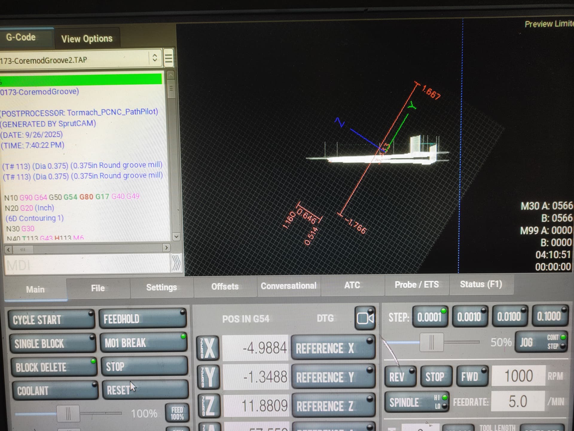

Path Pilot V2.12.5 update issue
Resolved:
For some reason the A axis view was checked after the update which then persisted.
Thanks for looking.
I just updated to 2.12.5 and noticed the preview screen looked funny. on further investigation I found the axis triad and the grid where rotated on the x axis about 45 degrees. The toolpaths are square to the window, but not the triad. I reverted back to V2.12.4 , but the issue remains. Has anybody come across this and how do I fix it?
Philip,
If you select the “view options" tab do you have the A axis display checked?
Thank you,
Norman
Norman,
Yep that was it. The update must have that box ticked as I haven’t use the 4th axis in a while.
Phil
