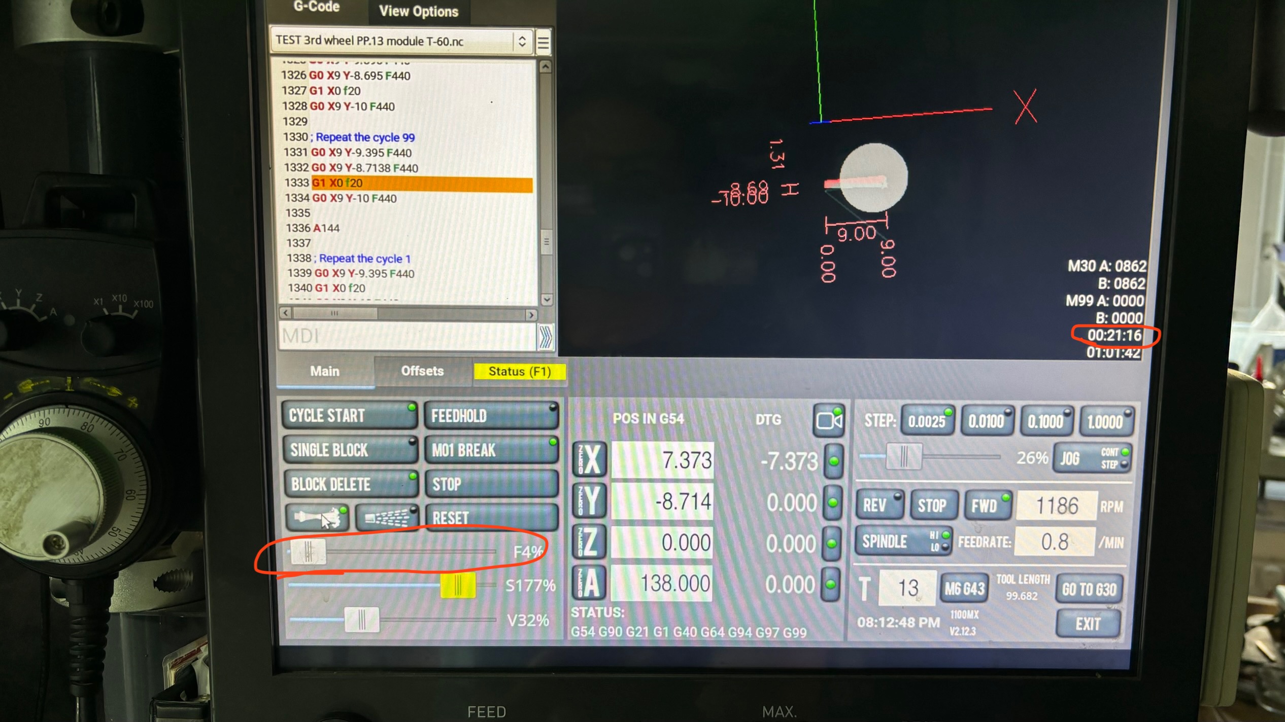

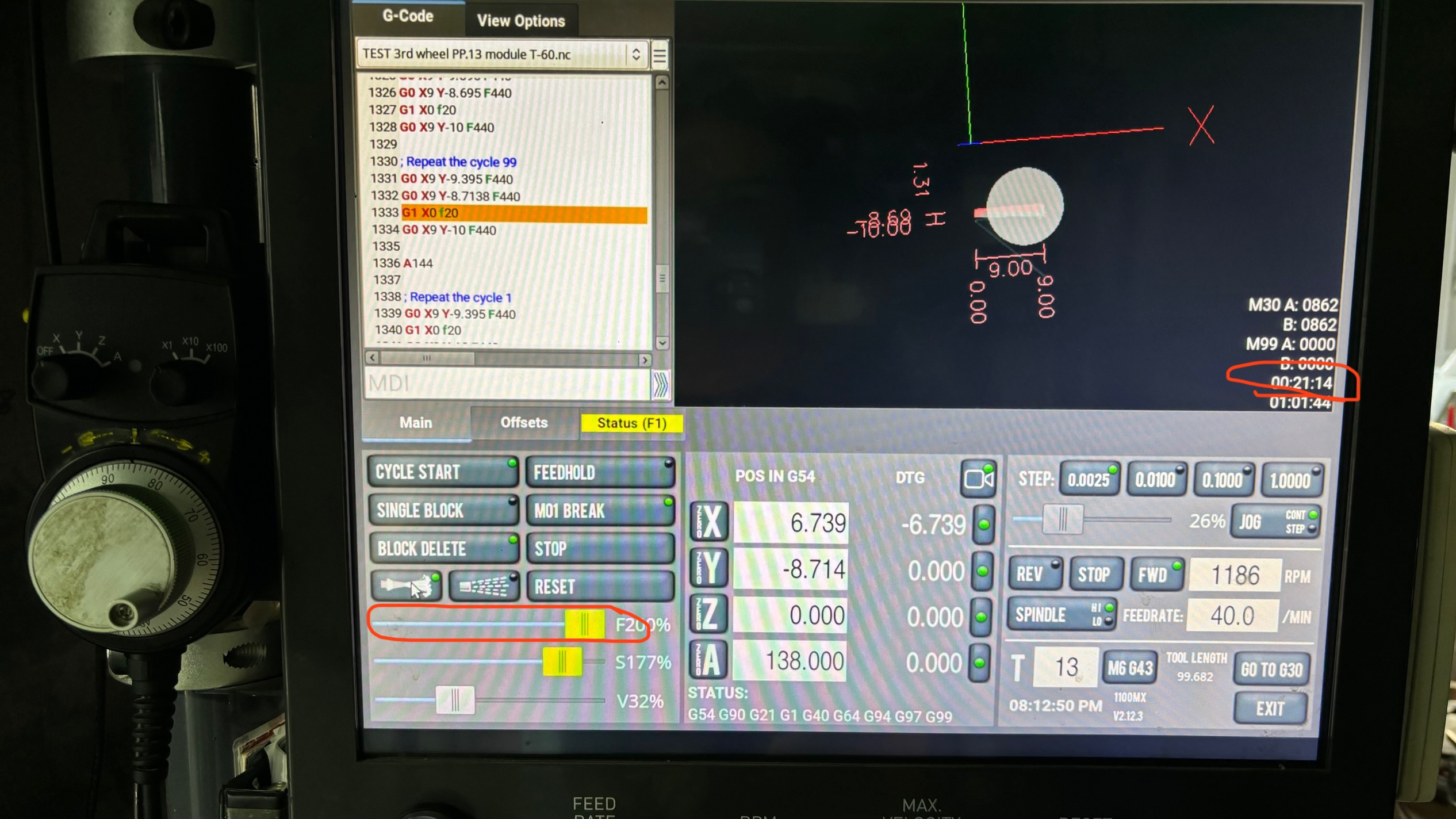

Path pilot program elapsed time and Time to program end
Is the time to end of program relative to the feed control speed? Or is it estimated on 100% programmed feed speeds? Or is the estimate updated so that my program that takes an hour at 100% on the feed knob will take 30 minutes at 200% on the feed knob? Is it updated and if so when or how frequently? Because when I turn the knob it’s clearly not updating.
The estimated run time shows how much longer the program will take to finish, based only on the program’s last successful completion time excluding time in feedhold. It doesn’t take into account feed rate overrides.
