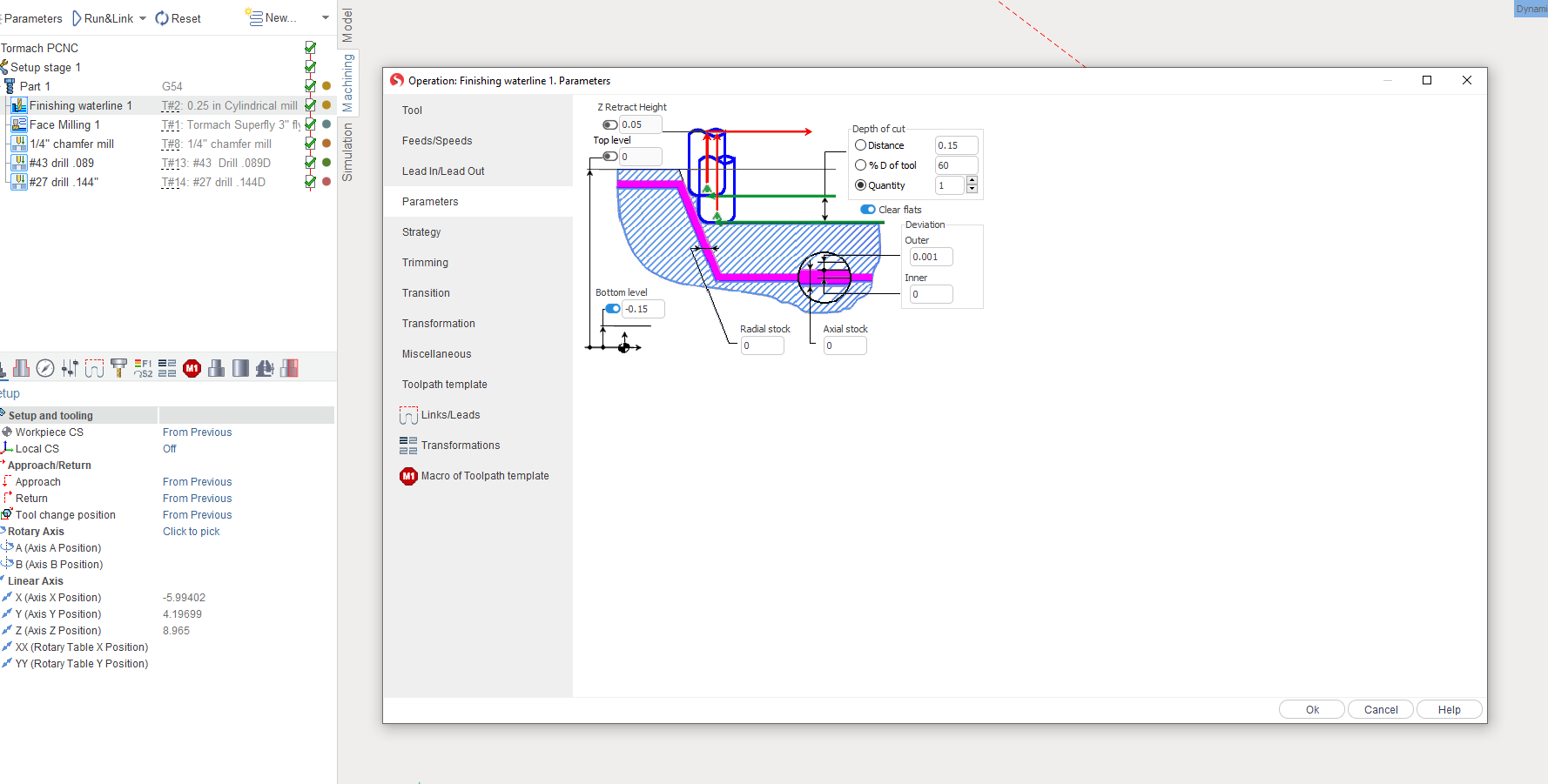

I have been working on some parts on my mill. I’m assuming there is an easy answer to this question. I have had a problem setting the depth in parameters. When I’m doing a milling path around the part I get this in parameters.
But if I am doing a drilling operation I get this one and can’t set a drilling depth.
Is there some setting that I have set wrong?

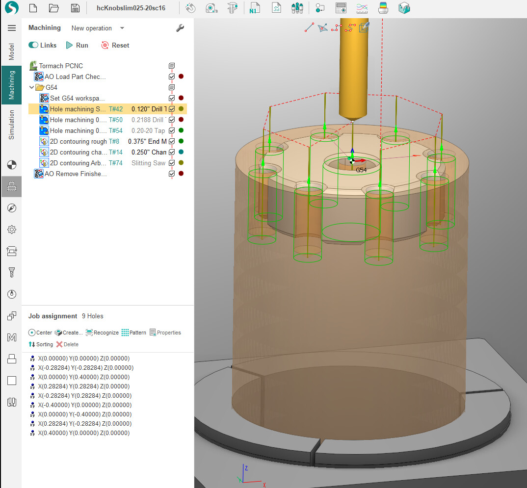

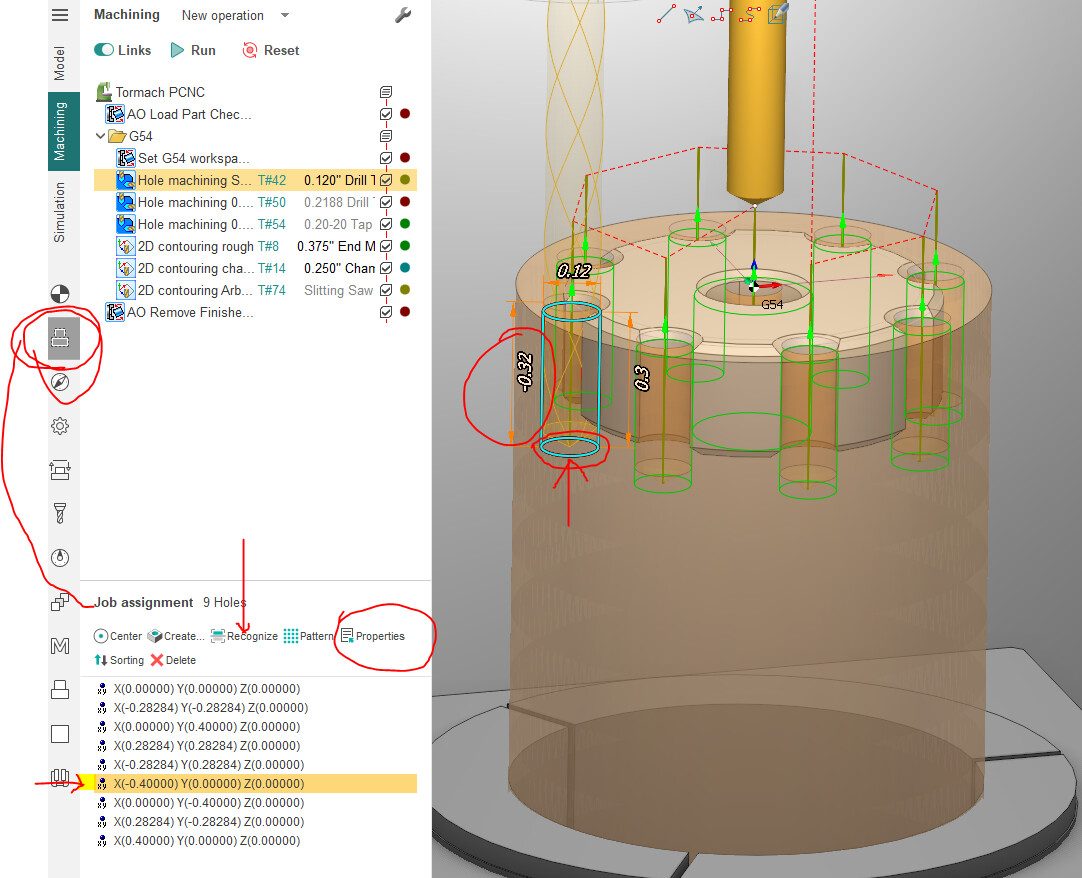

You need to set the depth and location of hole to be drilled in the job assignment tab.

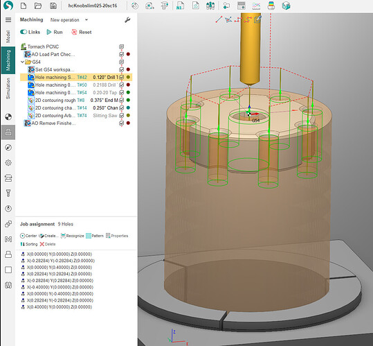

First select holes and add them to the job “this can be done a number of ways”
It should look like picture below.
Then click on the hole green lines to select it.
the diameter and depth will show up on screen like picture below.
you can set the depth 3+ ways
  1. job assignment , select hole and the select properties button
  2. job assignment, select hole on screen and change the depth numbers shown.
  3. Job assignment, select hole on screen click on bottom circle and drag up and down to desired depth.
  4. Sprutcam will recognize holes and add them to job assignment with depth set as per your model.
Hole machining is one of Sprutcams oldest and most refined operations. Read the way of the hole in the Sprutcam user manual :wink: BTW this is sprut 16 but only change is the tabs are down the side not across the top of the small window
