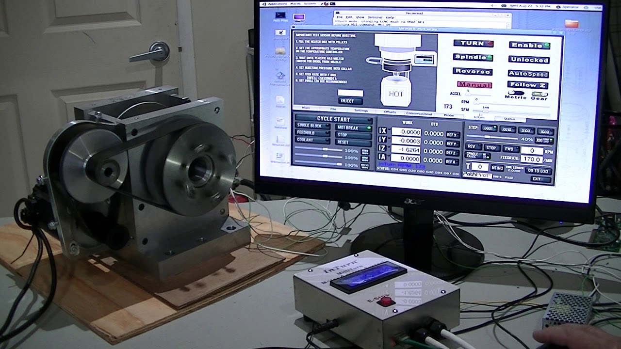

There was a 3rd party product called the In-Turn, several years ago that was essentially a relatively high-speed 4th axis (3,000 rpm max, I think) that might do what you want. It used a servo motor on the spindle so it could be indexed and featured a caliper break that could lock it in position. It had electronics support for a PCNC 1100 in Mach 3 and possibly PathPilot plus a lot of documentation.
You can see a video of it in development here:
I still have the parts, components, and docs for one that I’d like to move along to someone else if there is any interest. I never even started on the installation so it is all essentially like new.
