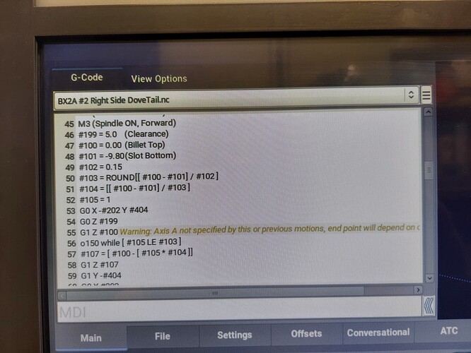

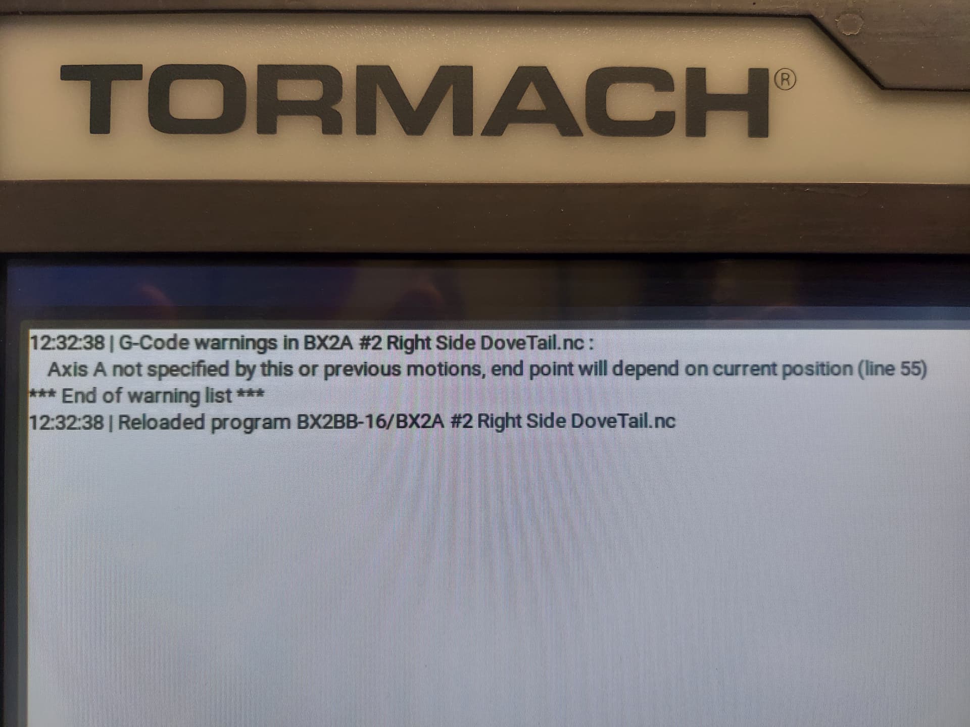

Just upgraded my 1100MX to PP V2.12.2 and am getting Warnings concerning the A Axis in code that has worked for over 6 months under V2.10.2! I do not have a 4th axis motor attached (Wish I could afford it now). Fortunately, it is just a Warning and not Fatal so I can ignore it and continue. I don’t think this is big enough to start a ticket, but I hope the programmers see this and fix it since it is anoying. One example follows:
Thanks for reaching out. We have seen this and flagged the bug to be fixed in an upcoming release.
