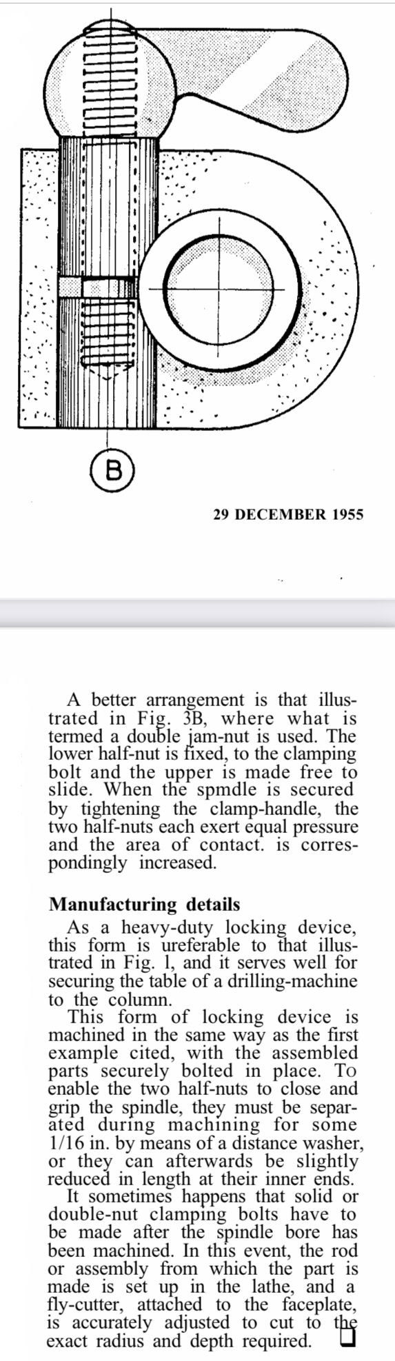

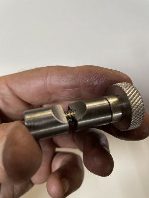

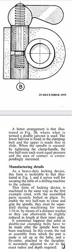

You could use a split-cotter type clamp that would grab the OD of your part if you’re making custom fixtures. They can have a surprising amount of grip, but I don’t think are available off the shelf anywhere.
Interesting. I would understand that this works for this application with a hole that is bored into the fixture block that is perpendicular to the recess which is located above or below it in order for this to seat/align?
It works by ‘pinching’ the round side of your workpiece and thus wedging it into place. Here’s a couple articles
https://bbs.homeshopmachinist.net/forum/general/34445-split-cotters
https://thebloughs.net/split-cotters/
A number of old tools use them to clamp shafts, my old Atlas shaper (in a few places) and South Bend drill press (holds the table in place) among them.

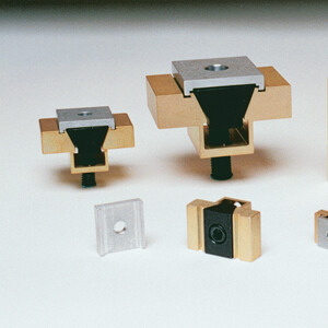

I’m a fan of these machinable clamps from mitee-bite. I’m currently (slowly) designing a fixture to hold a dozen coins with these. Usuallythey are used up ways but nothing says you can’t bolt them up the size of a block.
