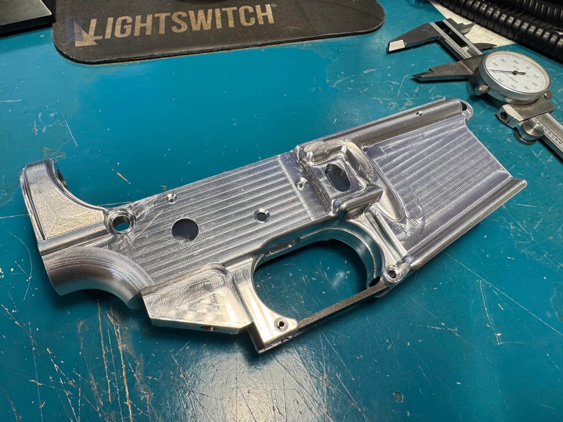

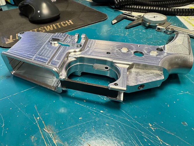

Hey All, I wanted to share some pics of my 1St airsoft AR-15 lower prototype and thank you all for the input for those who posted on my threads you guys have been a big help getting me over a couple humps, especially the Micro Arc Set up.
To recap the project this is a 3 Op part and the most complex part I’ve ever machined, even compared to all the milling I did as a toy sculptor, model maker and prototype creator for the toy industry for 20++ years and all that was organic toy sculptures and model parts.
· Op1 from billet in SMW mod vice,
· Op2 in my custom fixture that bolts to my SMW fixture plate,
· Op 3 is all indexed Micro Arc work.

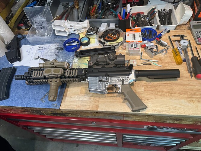

As you can see we assembled the gun, tested it with the part and it worked flawlessly, So Im pretty stoked about that! We still need to field test it in real battle (airsoft that is) to make sure were are truly good to go on function. Im currently working on optimizing my programming to make prototype #2, cut down on mill time and gear up for our production of these.
I do have several things that need improvement on the top side 4th axis rotation, but im getting there.
Input welcome!

Would you please talk more about the tooling and toolpaths you used for the magazine cavity? I have generally avoided traditional AR lowers due to this section usually requiring broaching. But it seems like you didn’t do that so now I’m curious?
For the magwell, when I modeled the lower I kept in mind all the corner radius and modeled them to match up a particular drill diameter, 3/16 for the magwell. My process was to drill out the corners first, then go in with my ½ 3FL for adaptive roughing, from both top and bottom. I overlapped all my top to bottom tool paths by .03. For these parts I’m not super concerned IF I end up with a slight step inside the magwell as it will not effect function and any small step will kind of simulate the seam an airsoft forged lower would have and were ok with that. I then went in with 3/8 adaptive with rest machining, ¼ contour. This 1st prototype has very small cusp left over at the edge of the 3/16 corners which I intend to address in the 2nd prototype.
I’m fairly new to mechanical parts machining in metal but not CNC milling in general. I’ve posted many questions on Practical Machinist and have learned ton of stuff from the guys on that forum doing metal work every day on real industrial machines. Many of them have said I should be broaching that, BUT I mean how are we ever going to get started IF we go that route. Cost of broaching is out of our reach at this point. The broaching tool itself is a big investment. Although the depth of this is very challenging it is still doable, I’m still working out the kinks in my process, programming and machining. I hope to have it pretty well dialed after prototype #2.
After spending 20+ years in the toy industry as a toy sculptor, model maker, prototype creator, 3D modeler, CAD and digital artist, I was one of the 1st people in the toy industry doing work digitally as far back as 2000. I used CNC milling in my process to mill toy sculptures, models and prototypes. I’ve done a lot of very deep and challenging machining and most of it was in toy sculpting wax. Metal work is a totally different animal and has its own set of challenges. The biggest is what we all know as metal workers, tool deflection resulting in side wall chatter which I’m working through right now. The trigger box pocket and buffer lock pockets are way more challenging because I need to get down to a .05 corner radius so the mating parts will fit in these pockets. I just got a new round of necked, long reach, short LOC tooling that will be better than the previous tools I’ve used on this one.
