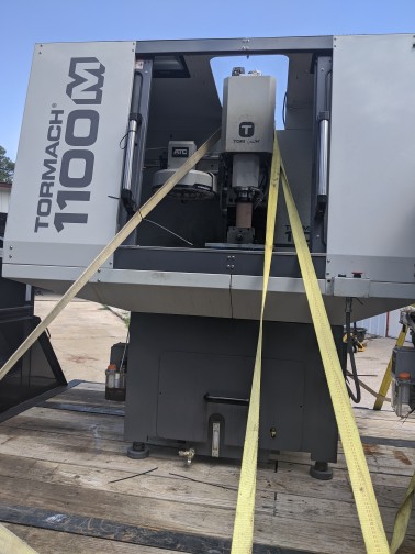

Can the 1100MX be moved lifting from under the stand? I purchased a complete machine and would rather not disassemble it to move it if it can be picked up with forks under the stand but will disassemble if it’s an issue.

Yes it can be moved that way. It’s one top heavy lady though. Like roll a pickup in a corner heavy.

I ran Z all the way down to try and lower the CG, Im only moving about 15 miles on my Skid Steer trailer.
Strap it down well and it’ll move ok. I moved mine across town like that with a wooden block under the spindle.
Note that the sheet metal on the stand is a bit thin in some of the places that a pallet jack or forks might like to go, so keep an eye out for bending when lifting underneath.

If you can screw into the deck of the trailer, adding cleats around the feet would help out.
