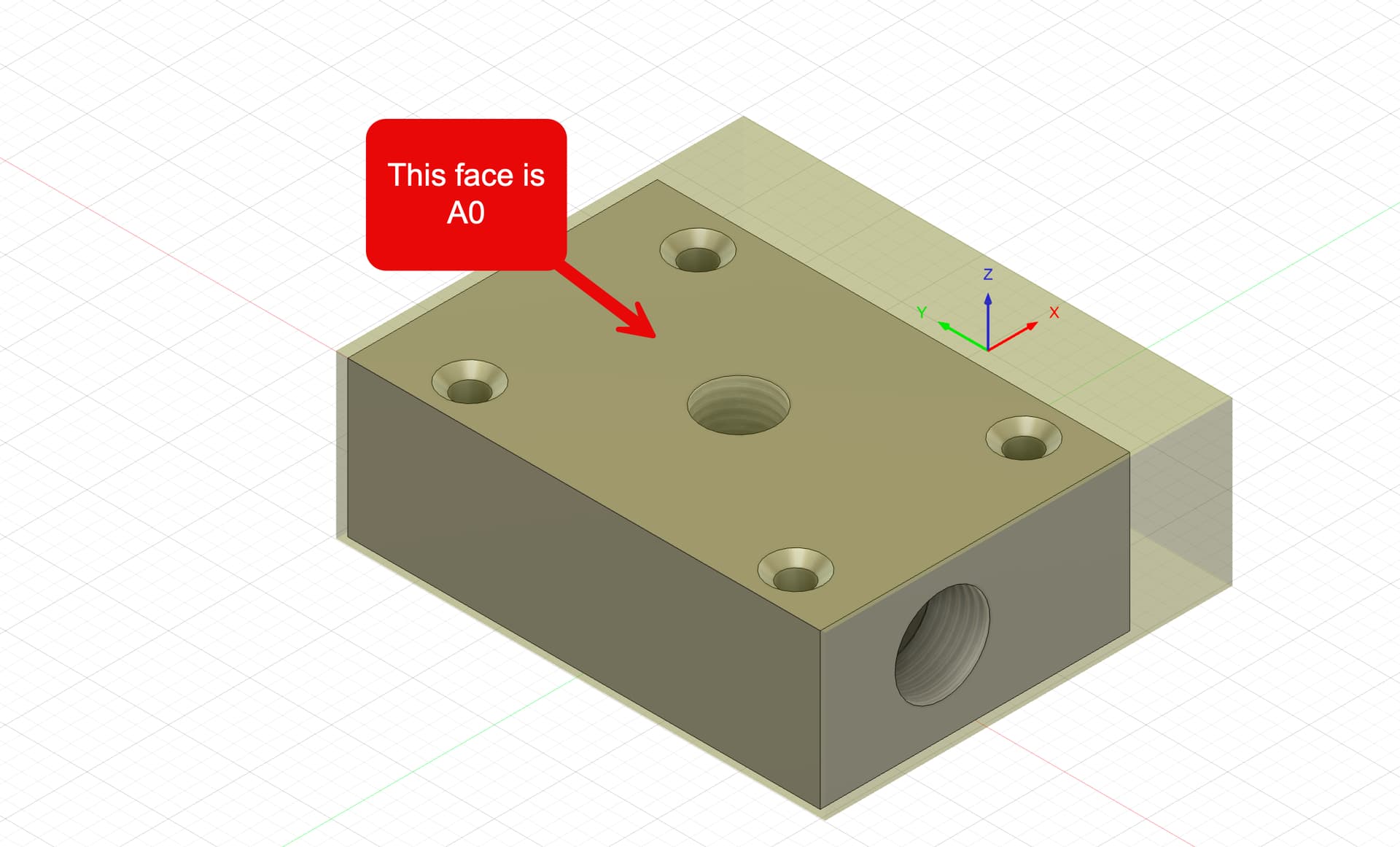

I have a part that I’m trying to machine on 5 sides. It’s a 2x3x1 block of aluminum with an extra 1/2" in X to hold onto in a self-centering vise. The operations are like this
  1. Face the 5 sides, starting with A0, then working around the part.
  2. spot drill 5 holes on the A0 face, 1 on A-90 and 1 on A90.
  3. drill operations, same holes, same faces
  4. Bore 3 of those holes on those 3 faces with a taper for an NPT thread
  5. Threadmill those bores
  6. chamfer/debur on all sides
Operation 1 & 2 go as expected but after the tool change to the drill for op 3 the part is in the A-90 position and Z begins to descend and drill then as it penetrates the surface of the part A begins to rotate towards A0. There is nothing in the G code that would seem to command this.
