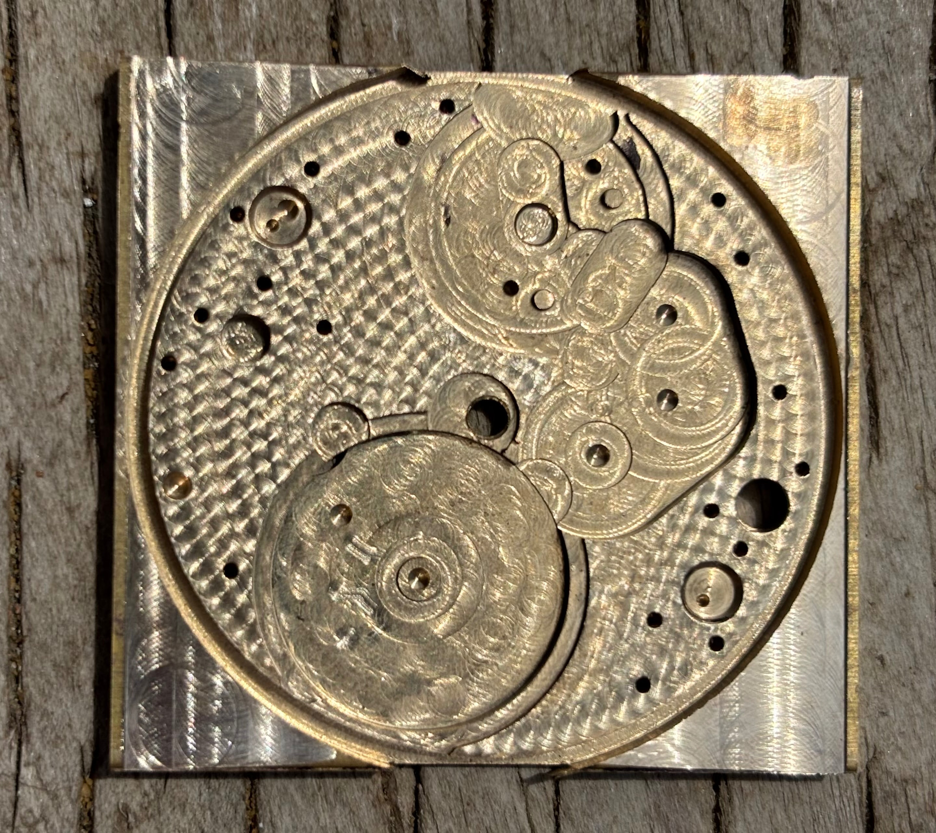

I intend to do it for cutting mechanical watch plates but it’s project 7 of 31 that I’m working on this week.
Very curious about what your making and how the finish looks.

What got me to this point is I’m experimenting with what sort of results I can get using engraving / machining to mimic real gilloche - fine machine engraving.
If you have any examples if gilloche that you’ve done, I’d love to see it

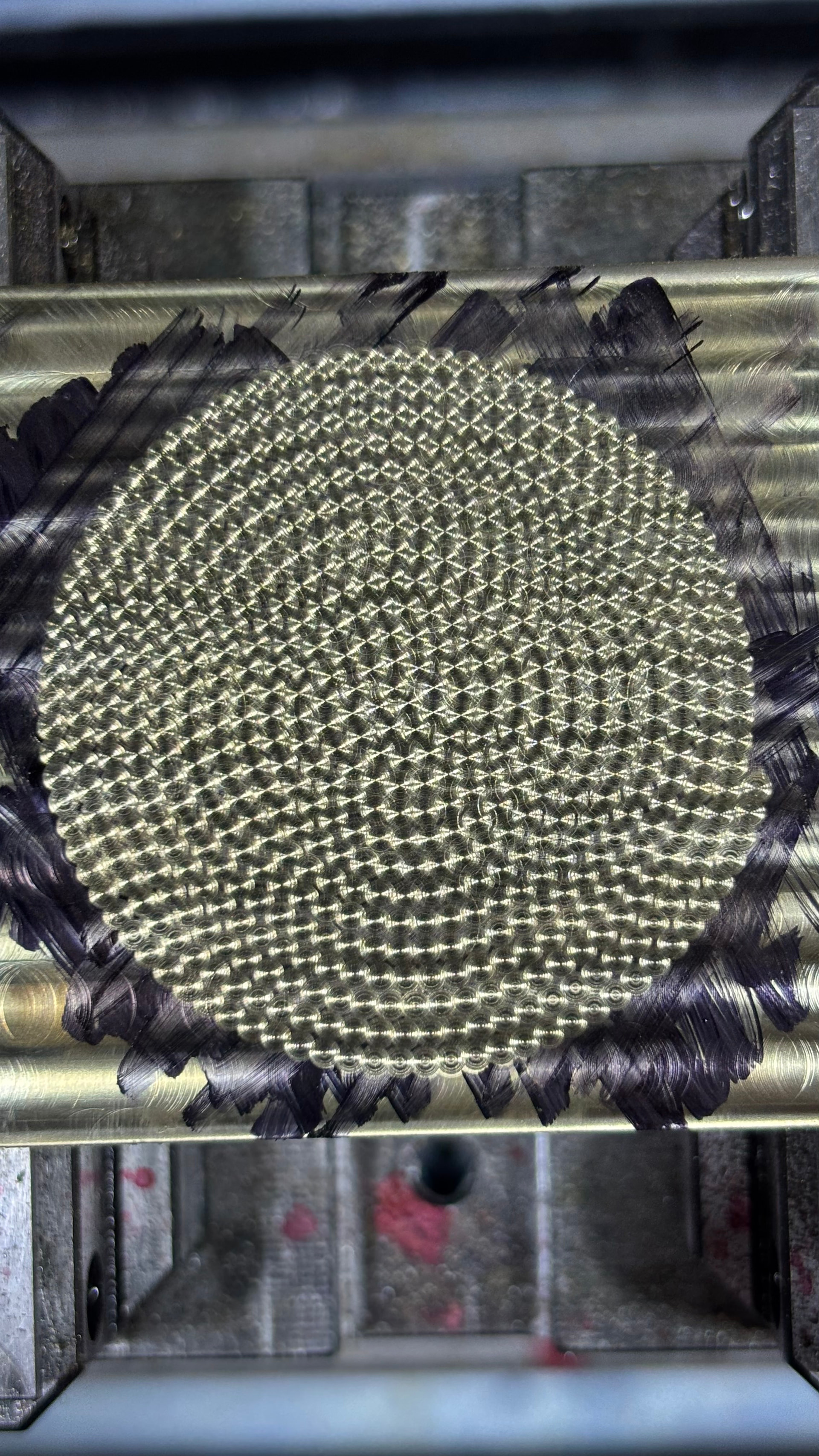

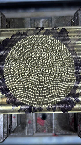

Not quite guilloche but not bad for a day.
I haven’t tried any patterns with a fly cutter and a rotary table yet.
Very cool!
Is that pattern made with a EM of some kind?
or the rod and diamond paste method…
Just hard to tell what that pattern is in the first pic
But very sweet
I tried a lot of things but the most repeatable was with silicon polishing buffs. The pattern was just supposed to look like pearlage. It needs a little more refinement.

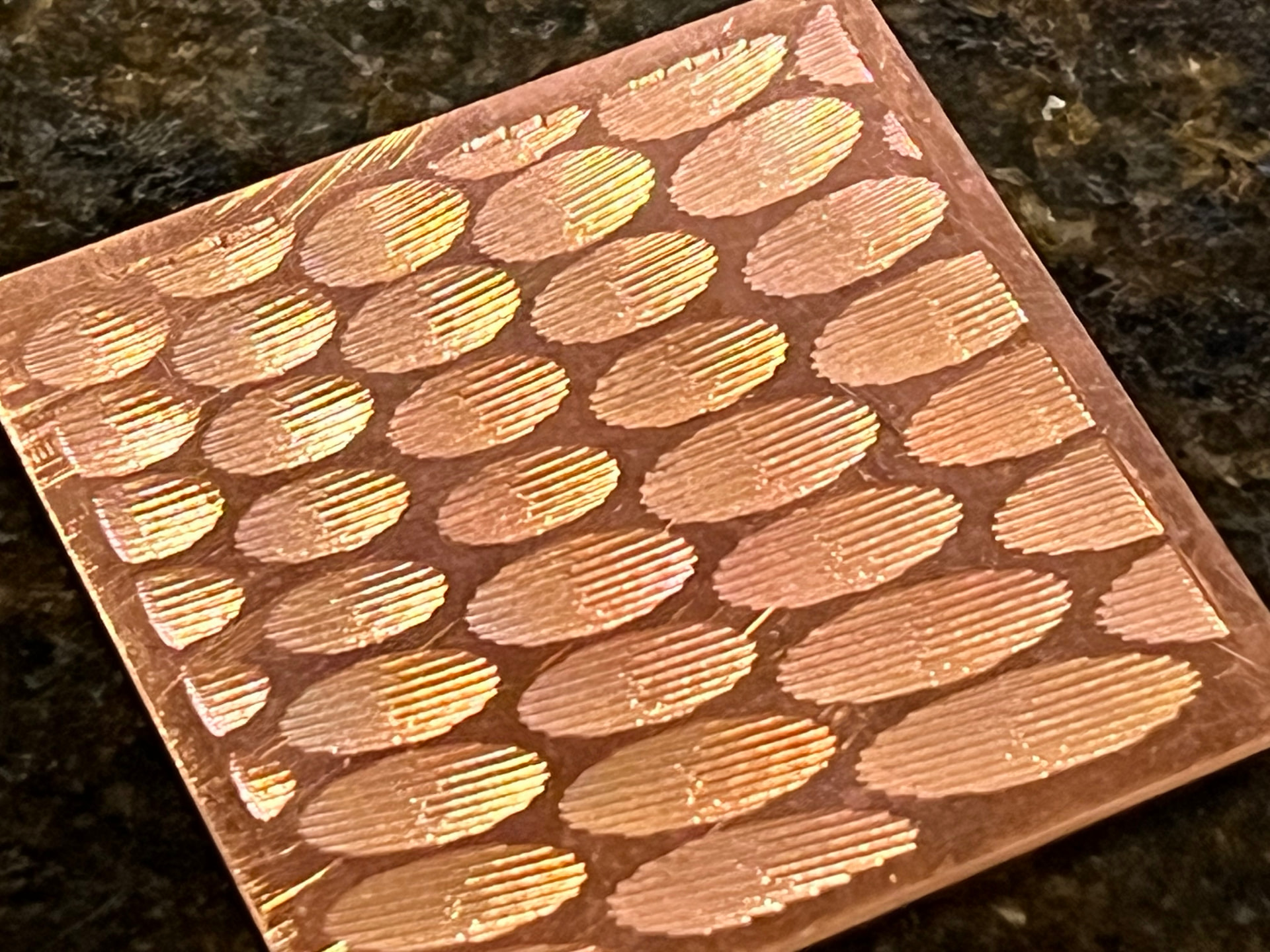

This is literally my very first attempt, as cut right off the mill.
I’m planing on transparent enamel so the tests are on copper. The square is about 1.5” sides. I generated a 3D model with varying size ovoid divots. The ovoids are about .008” deep. I then used the parallel 3D strategy with a .04 ball mill. If you look closely you can see that I varied the parallel direction to achieve a curved affect of the overall line work.
From my perspective, this came out remarkably good for a first attempt. The camera picks up everything. The scratches on the flats in between are very small and just catching the light.
The most obvious machining mark/defect is some noise in a vertical line in the centers of the divots. This is caused by the backlash compensation that kicks in a the appropriate middle of each cut where Z changes from down to up as it climbs back out.
I think that a fine steel or brass brush might soften or remove those marks.
I’m now in the middle of trying more tests and patterns.
It looks really good. I haven’t made it to the enamel yet but some of your problems might be solved with an ultrasonic cleaner and solvent and lapping. For all the jewel quality you always have to polish everything. Also I think the enamel can be quite forgiving as the glass sort of self smoothes everything. But it could be just the opposite and enamels simply refuses to stick to any surface that isn’t already perfectly smooth.
Enameling on (at least) copper, steel, silver & gold is somewhat surprisingly a chemical bond between the glass and the metals. In particular the metal surface develops oxide because of the heat before/as the glass is melting as the glass flows and fuses the oxides are absorbed into the glass at the metal glass interface.
To prepare the metal the single most important thing is a clean surface, for copper this usually means a pinkish mat surface out of a pickle bath or a scrubbed / mechanically clean surface.
Adhesion is not usually a problem, regardless of texture, it’s the coefficient of expansion difference between the base metal and the glass, there is a relatively narrow range that will work well for the first base coat. Nothing more annoying than pulling a piece out of the kiln and listening to it start crinkle and crack as little bits of glass fly off as it cools. Subsequent coats of glass on glass are more forgiving but still need to match COE to some extent.
With gilloche, transparent are used (what would be the point of covering the pattern with an opaque!) at that introduces the additional issue of firing to the point where the oxides defuse into the transparent glass. This actually is essential to develop the transparent’s color (some colors more than others). Oxide remaining on the metal will of course reduce the sparkle.
I haven’t examined the my first piece with an inspection scope yet but I’m willing to bet that the center Z change marks are just little ripples due to the backlash comp. A fine polishing compound used lightly with a soft-ish lap may be enough to reduce them without destroying the cusps created between the ball mill tracks.
