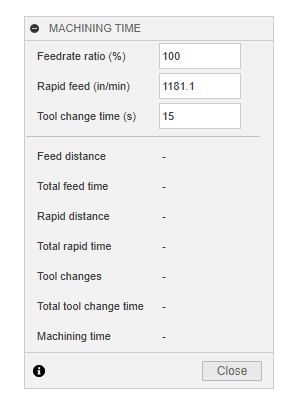

Has anyone played with and dialed in the feed rate ratio % setting in Fusion so it will yield more accurate machining time results? OR at least get closer than what the default is? IF so, what settings do you have? I have never changed mine I only just learned about it per a conversation with Andrew on the Fusion forum.
I have mine set at 92. It’s not perfect, but close enough to give me a reasonable idea of the program time.
You also need to adjust your rapid feed setting so it properly matches your machine’s capabilities. This is more important for roughing operations than anything else but if you’re doing a long adaptive rough, you will notice a difference there. Though it’s still imperfect because these machines have a slower Z rapid than XY. I have mine set at 300 (XY rapid for 1100mx) and again, the overall simulation estimate is fairly close.

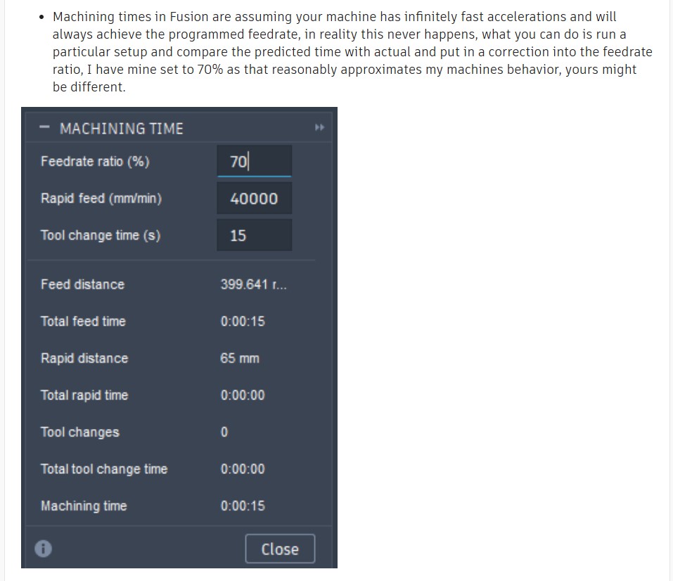

I asked Andrew on the Fusion forum about this, and he has his set to 70%, so it would be interesting to know how accurate the 92% on a Tormach MX is. Here is his response. He runs a 50 ton BEAST Okuma MACR A5CII BT50 35HP table is 21 foot long X 6’. So its interesting he has his Fusion setting at 70%
I do realize all that, thanks for the input, Im just trying get is set so the numbers make more real world sense. For me I have a 3 op part we plan to sell and the times are very high right now, so Id like to see more realistic numbers. At some point when I get the CAM dialed in I will time the runs to compare.

As for Andrew’s 70% compared to my 92. The difference is meaningless because the machines are completely different. Also, he has his max rapid set to almost 1600in/min which may be correct for his machine, but I doubt it given it’s size. Even if it is, the explanation is right there in his post, assumption of infinite acceleration is going to have a greater impact on a machine that has to accelerate a larger mass to a higher speed.
