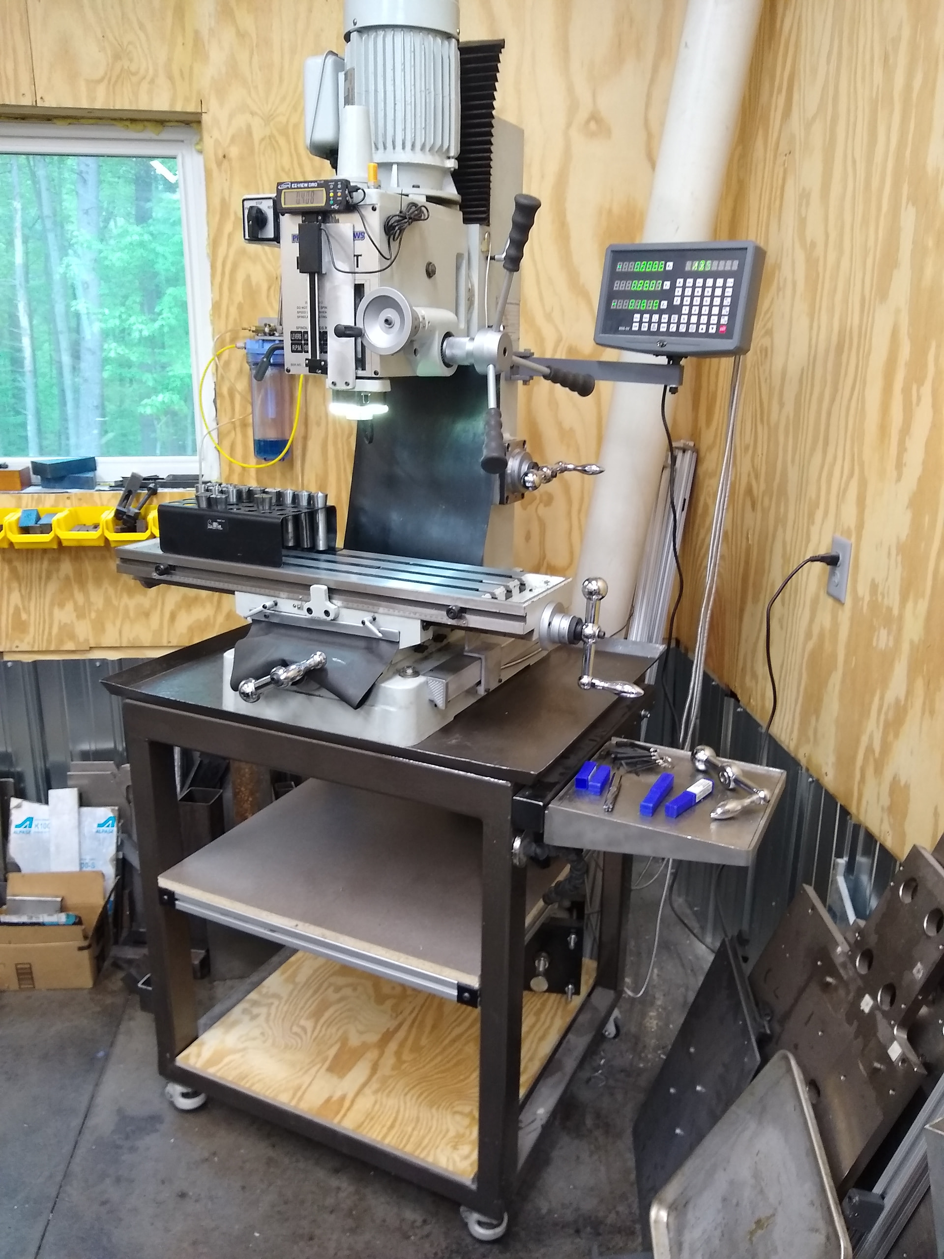

I’d rather not spend time to make one (3d print).
*important: I cannot purchase from Ebay.
thank you!

I had a light ring on my Precision Matthews 822 mill. I purchased it from Super Bright LEDs. I measured the quill diameter and found the appropriate size light ring like this one…Headlight light ring.
However, I then had to purchase a 120volt to 12 volt converter and wire it all up ( I 3D printed a junction box). After it was all done, I thought it worked well but then discovered that there were actually shadows from the tooling that fell on the workpiece. It was a fun project but not sure if I would go that route again.

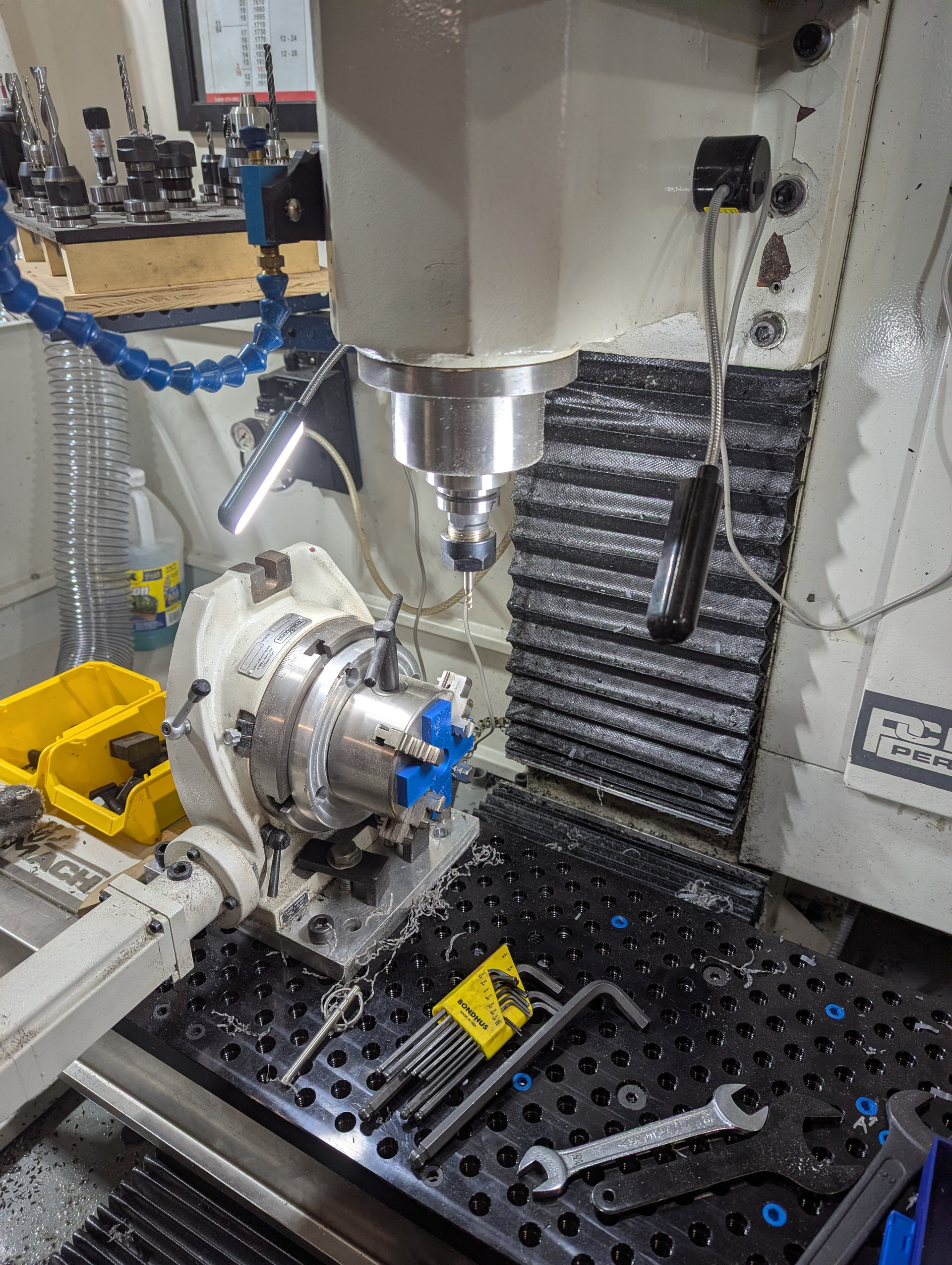

I ended up selling that mill and bought a large Sharp knee mill and decided to go a different route. I purchased what they call a “sewing machine light.” They are magnetic and attach anywhere. Sewing machine light from Amazon. I don’t use flood coolant with my Tormach, so not sure how they would hold up against that.

Headlight ring lights work very well, this type is very bright: https://www.aliexpress.com/item/1005002043042040.html
Does a ring light provide any additional illumination that is useful/noticeable if you already have two enclosure flood lamps?
