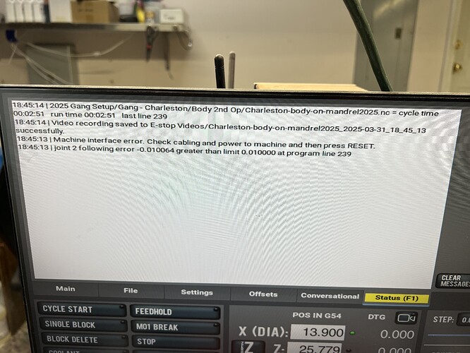

Can someone please explain what could be causing this error code? It’s a program I’ve run for nearly a year and now it will stop mid program with this error. I have no clue what’s going on. Thanks in advance!
I’m a novice so I’ll try to answer any follow up questions as best as I can.
What version of PP are you running? If you edit the program conversationally and Save As a new program does it still happen?
What all has changed from when you ran it successfully and when it failed?
I was running 2.12 and recently updated to 2.12.2.
There hadn’t been a change to the program since Oct 2024. I’ve run this program and several others successfully up to today.
I’ll have to try the save as idea and see what happens.
I did alter a few non critical dimensions since posting my question and I did not get the error code. No idea if that did the trick or not. I ran a handful of parts before having to call it a night. Will see what happens next time though.
If you see something like this again, can you grab a log file and send in a support ticket?
