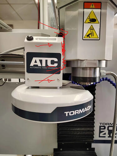

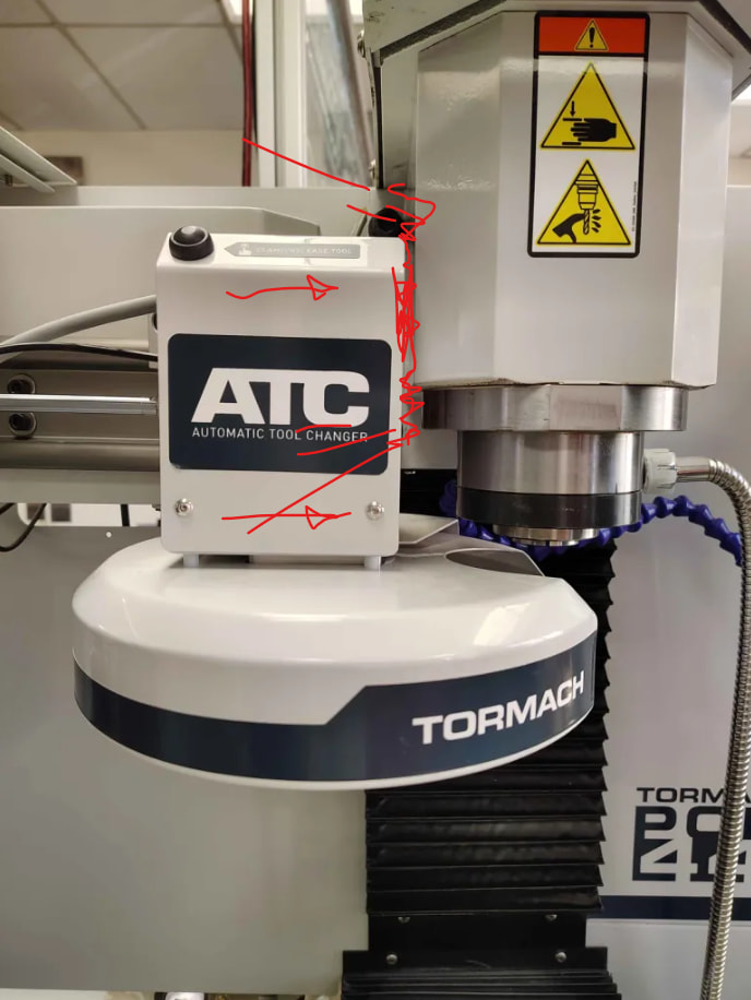

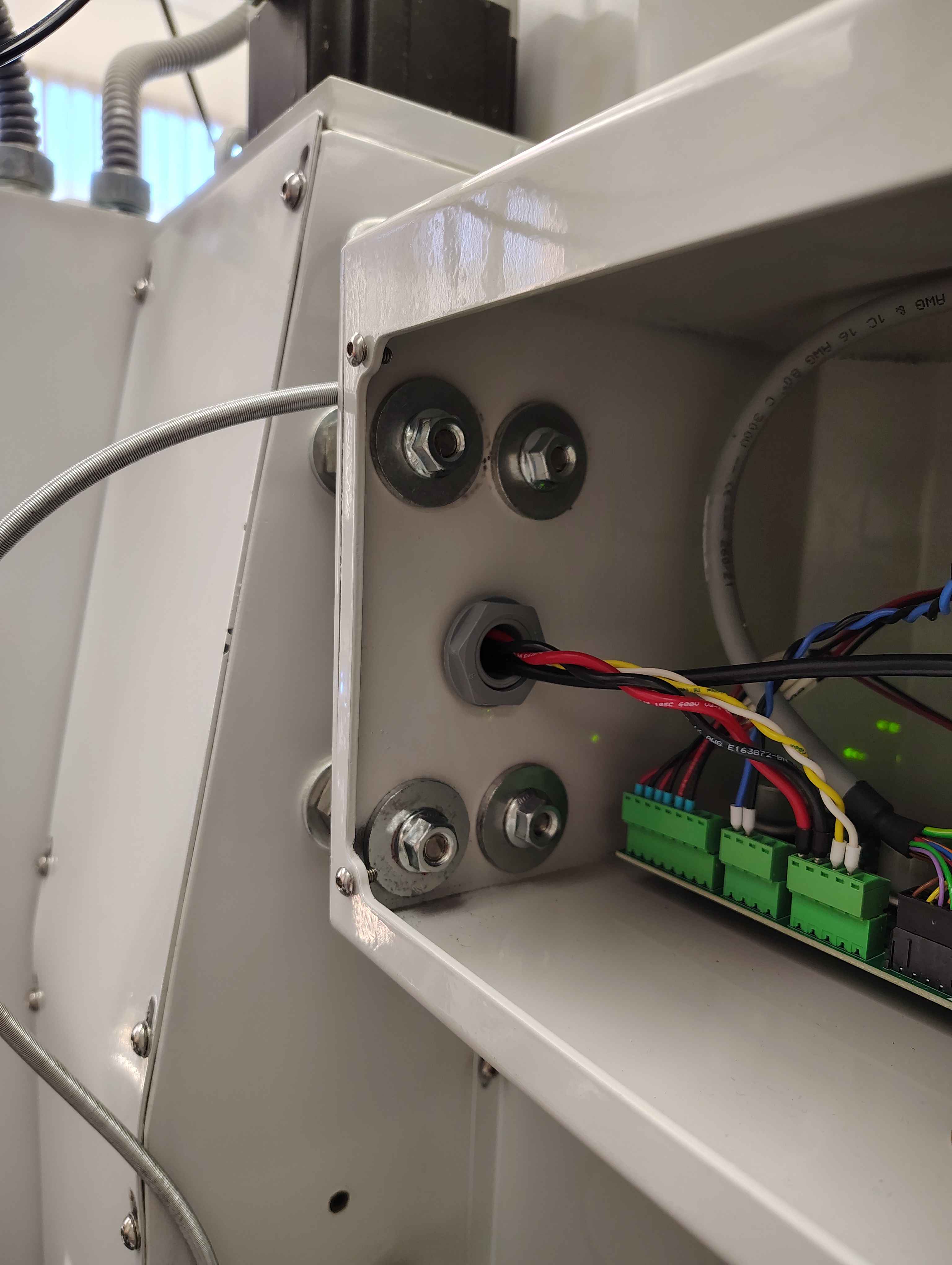

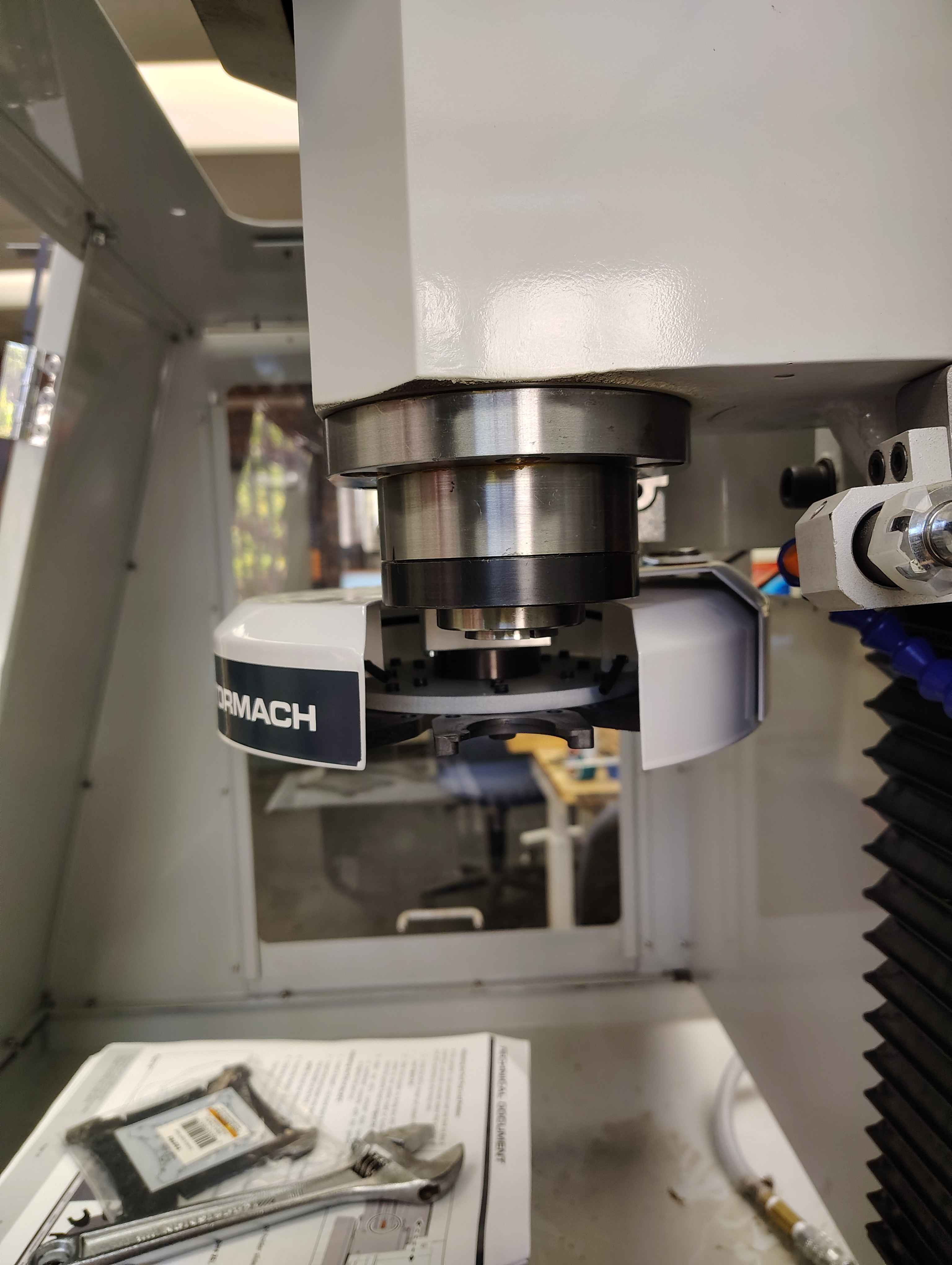

The main problem is that the tool tray is misaligned in the Y axis, so I loosened the Adjustable nuts on the back. This starts to align it, however once it gets aligned, the ATC starts hitting the z axis head.
The ATC’s jam nut and coupler are already maxed out in the leftmost position, so I cannot get it any further away from the spindle without misaligning it again in the Y axis. Ive been following the manual I have on hand, but I cant find anything in there regarding aligning the atc in the Y axis, so I’ve been following this video: https://www.youtube.com/watch?v=HNNd7KiZ6eA&t=630s
Any thoughts on how I can align both the X and Y axis? I have not touched the fixed nut since I never saw anything telling me to touch it.

You probably need to take a breather and go back to the beginning and look at the main bolt adjustment and sadly, I would go through the whole instructions and confirm it was installed/assembled correctly…who knows what has been done to it in that sort of environment…maybe a good time to get a 3-ring binder and create a maintenance log while you are at it…

This looks like a case of (someone that thought they knew what they were doing found a box of equipment (the tool changer) and installed it. Unfortunately they just bolted it up and said done.) if I were you I would check every instruction as the tool changer is very finicky and any mid steps can cause headaches forever. Probably a uninstall and reinstall job.
