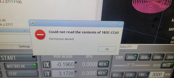

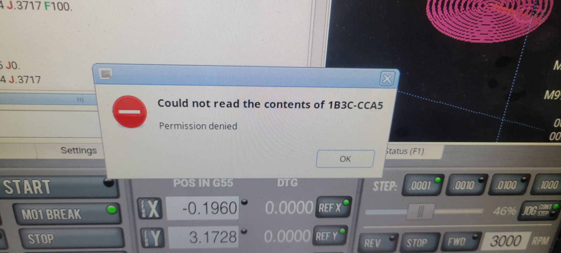

The other item: few weeks ago, before the supposed power flicker, and this present issue, I got this warning on my screen. One time. And have since ran good parts on the machine up until this issue (though, perhaps they were bad, and I didn’t catch it until now?)

That error you posted a picture of is a red haring. That is related to your USB drive. I see that error when I’m using cheaper USB drives and most of the time PP sorts out how to read the drive by time I acknowledge the error.
