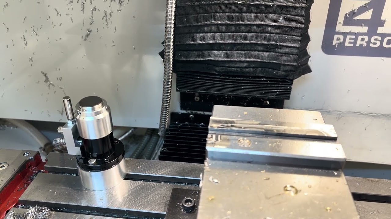

I can now measure tools CONFIDENTLY with my budget ETS!
For reference, I have it wired in series with the 303 and 304 wires which go to the MX3660 input which AFAIK is low voltage and separated from the rest of high voltage E-stop stuff (unless I’ve missed something).
The E-stop button still works as it used to and pushing the ETS all the way down also initiates an E-stop.
I would imagine that some of the other series of machines have a similar input somewhere so that no one has an unnecessary crash. I see no reason to ignore these two wires on your install of a similar ETS.
Yes, we should be protected by it being NC but if the first switch/contact shorts out to closed and never opens upon contact, then at least you have a second one to stop before you break carbide or crash…
A bit heavy handed and very defensive, but if you absolutely, positively, must not ever overtravel the toolsetter…it works!
Most people don’t do this because e-stopping is a massive pain and your tool measuring program should never allow a crazy move.
You should really be able to confidently measure your tools without having to do this. But maybe you are a new machinist.
