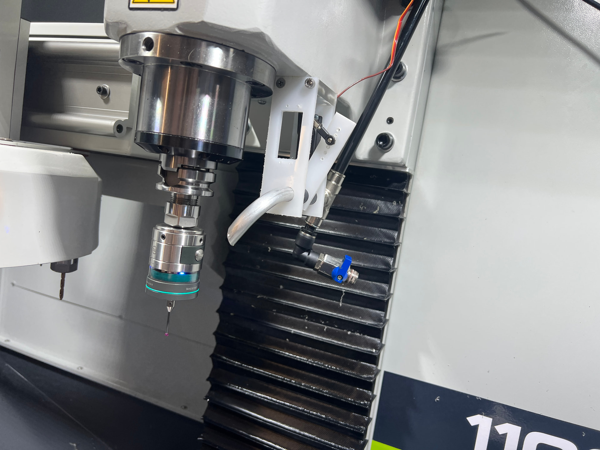

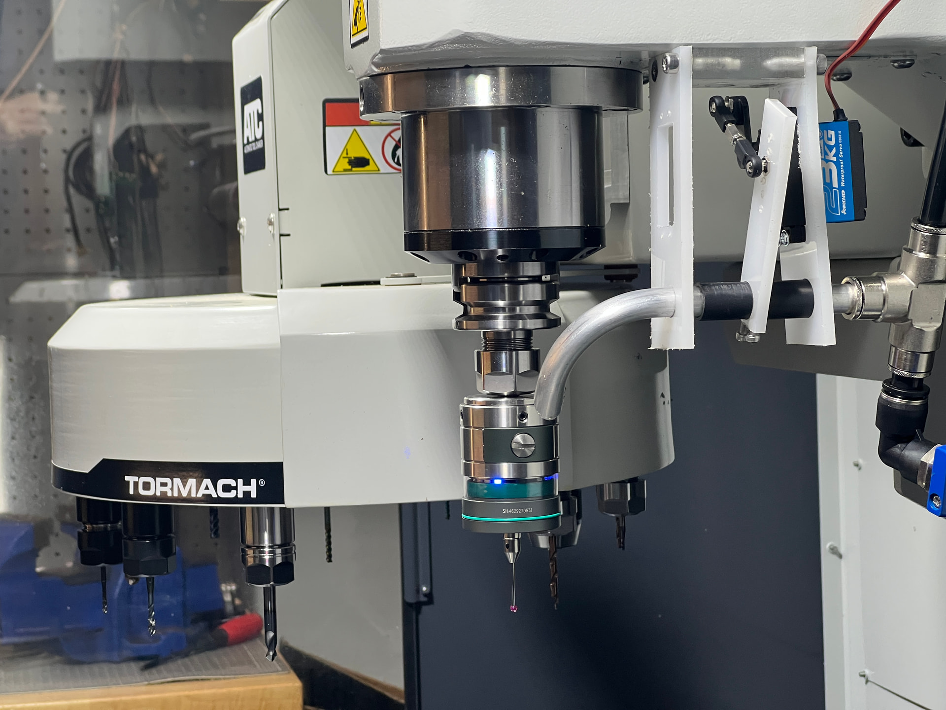

I’ve rigged up an Arduino on USB to detect when tool 99 is in the spindle, and then “ground” the brown wire of the receiver via a small relay which wakes the probe up - means batteries last for a year or more with the 1200ma LiPo

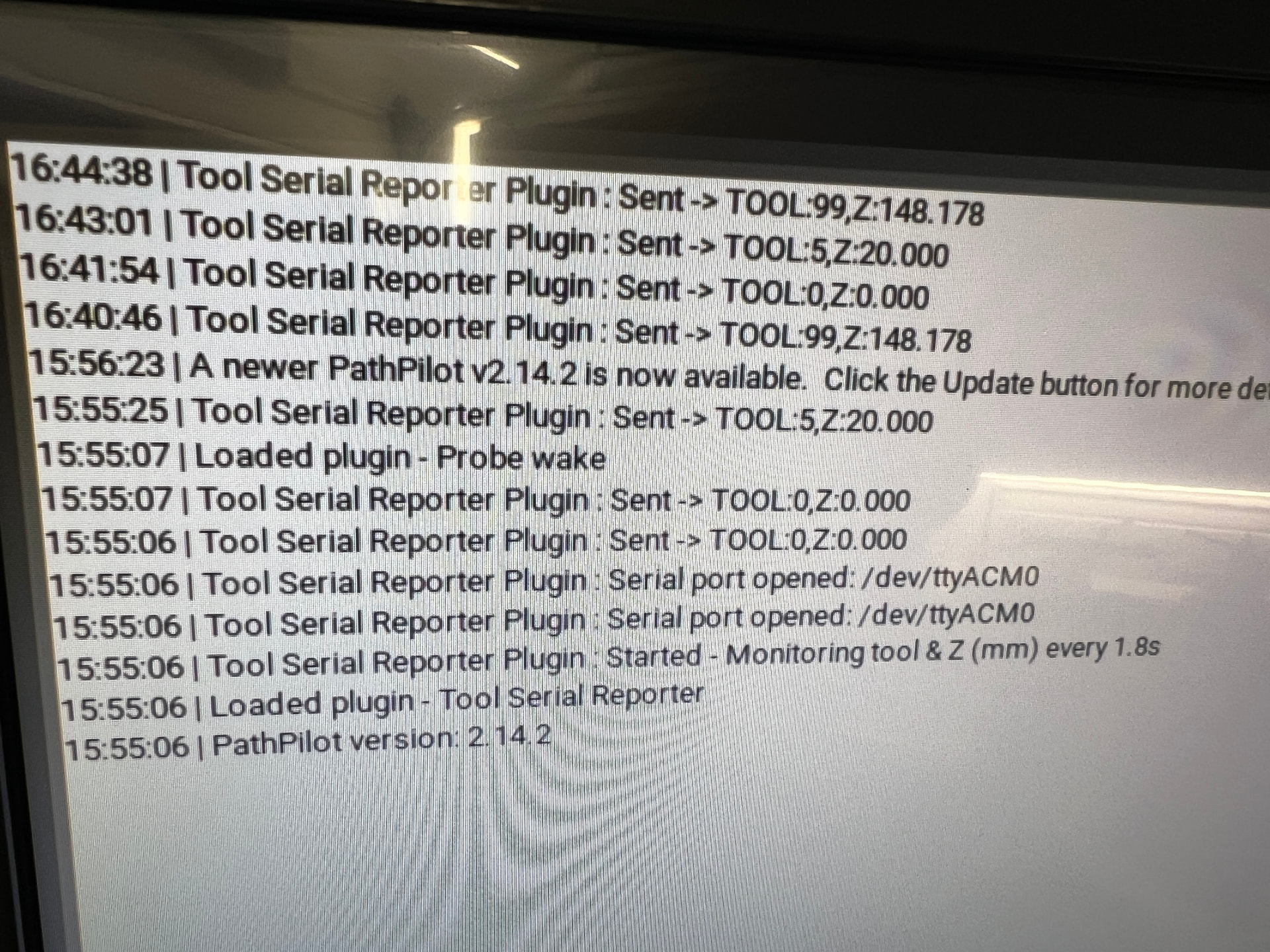

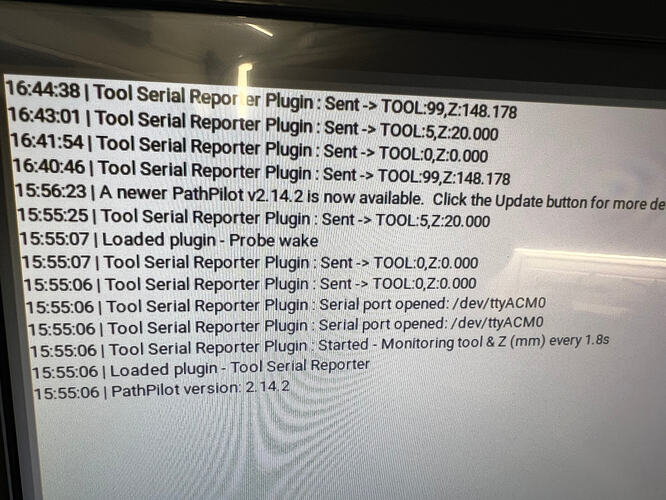

I have there files in the folder “gcode\python” (you will need to rename .csv to .py)
ProbeWake.csv (2.0 KB)
ToolSerial.csv (4.0 KB)
ui_hooks.csv (8.4 KB)

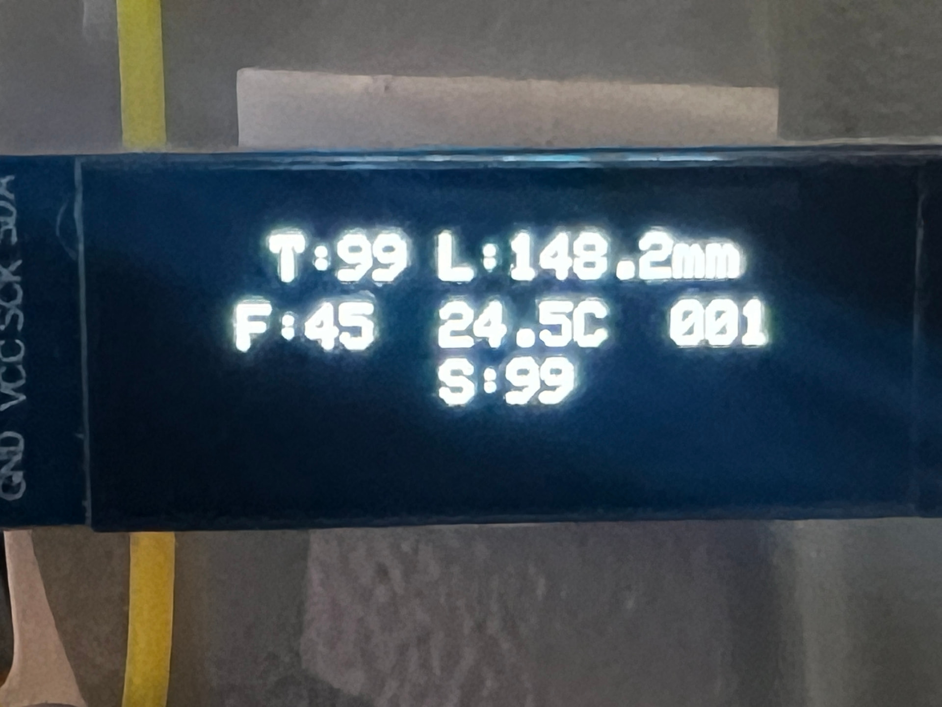

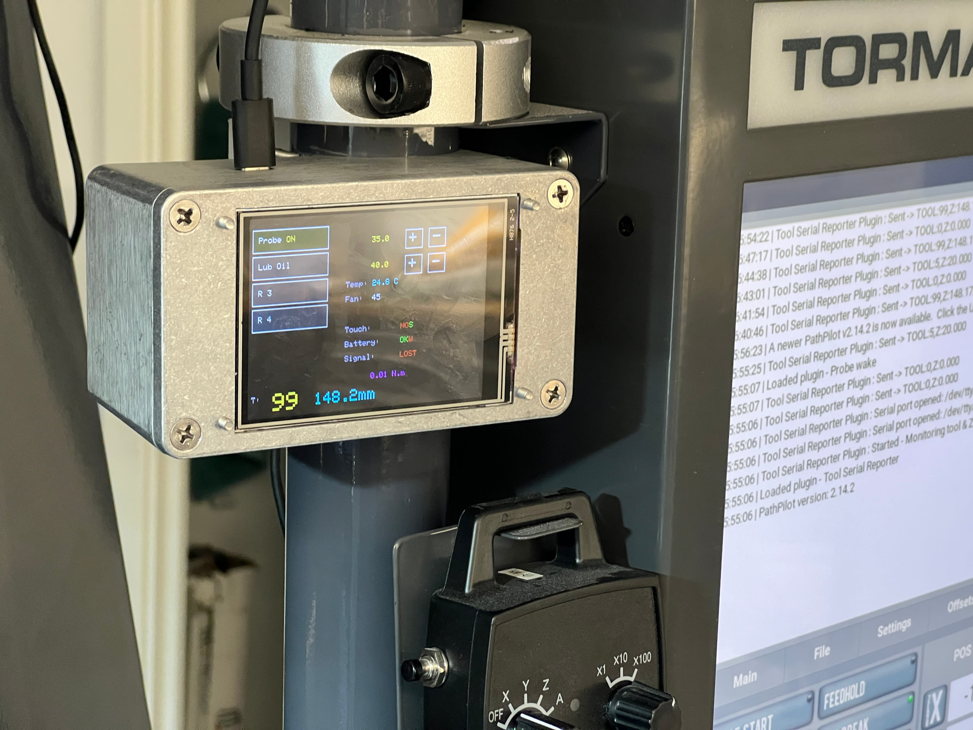

I am using 2 x EPS32-C6 (they talk over WiFi to avoid a long USB cable from PP panel to control panel). Code is a bit longer than necessary because has a few other “bits”:-
  • detect Tool 99 and activate GP-800 probe
  • detect Tool Length and adjust angle of servo directing nozzle
  • interrupts power to auto-lubricator, and holds off until Z- starts to move (will add use adjusted timing later)
  • PWM control of rear panel cooling fan - its too noisy - small NTC sensor detects panel temperature and speeds up fan as needed.
  • a few additional relays/mosfets just in case.
    MASTER code for front near PP with TFT touch-screen and SLAVE code for ESP32-C6 in rear panel (also small OLED just to show basic “I am awake” status). Change .csv name to .ino for Ardunio IDE programming
SLAVE.csv (13.7 KB)
MASTER.csv (12.7 KB)
eh .. my documentation is not a strong point - hope haven’t crossed a few versions, but working fine this end :frowning:
One one the “spare” outputs is for a DIY oil skimmer.

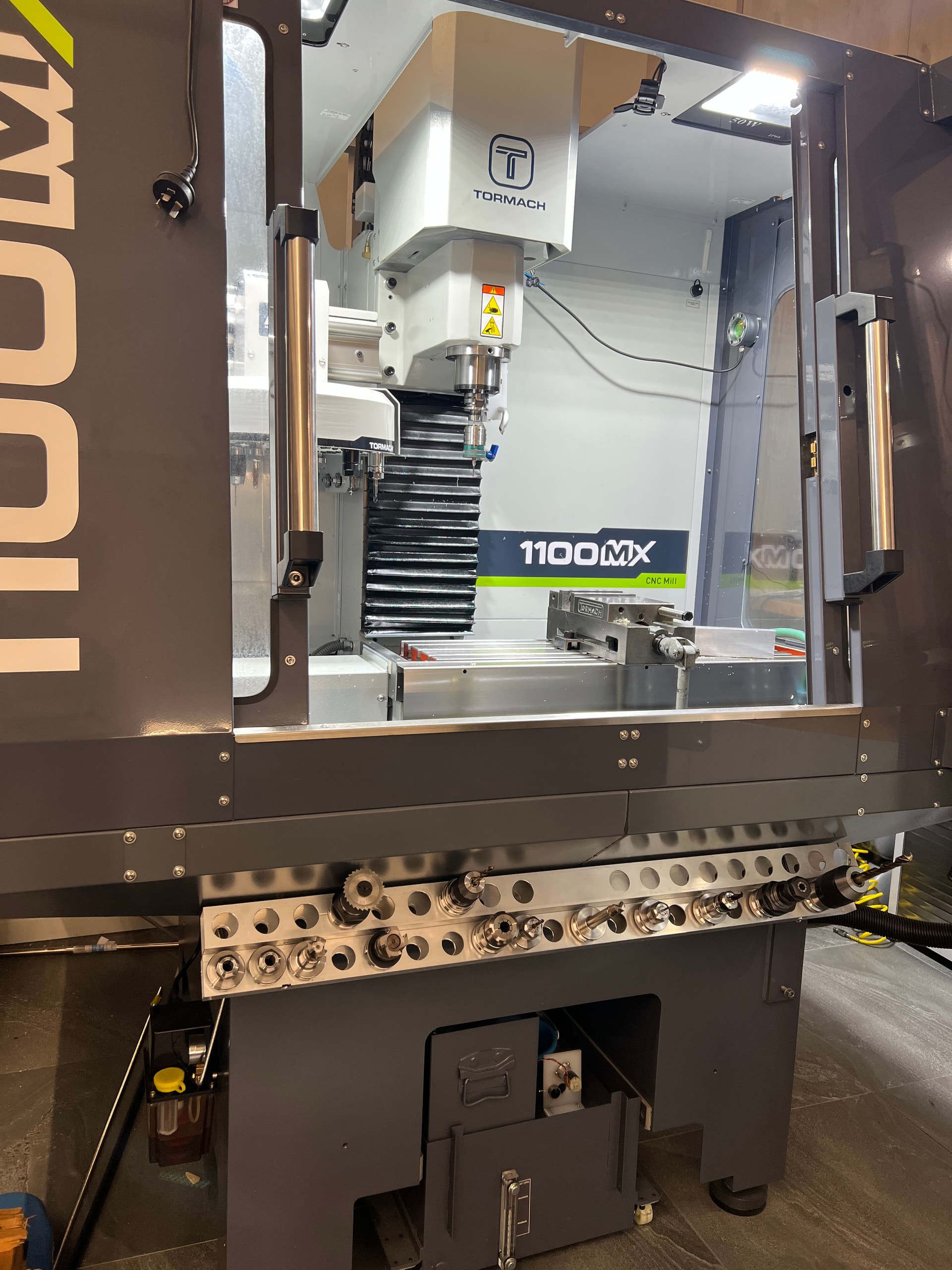

A few photo’s attached - whatd’all think of my BT30 tool storage location?
oh yea- also - don’t forget to inhibit flood coolant when T99 loaded.
