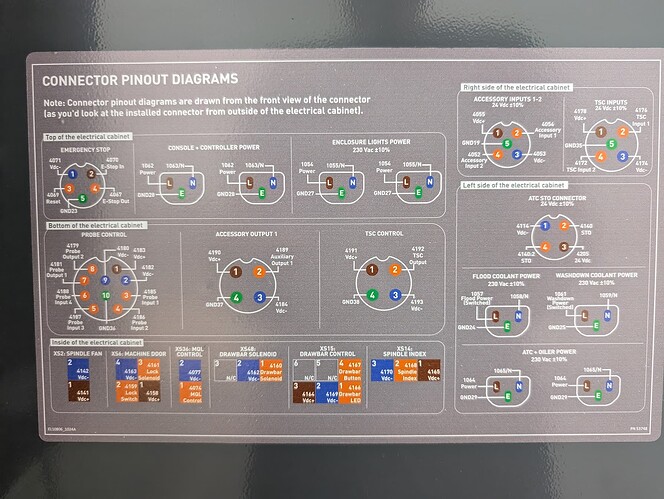

I’m trying to set up a 3rd-party tool setter on my 1500mx.
The 1500mx manual says to wire an ETS into the Accessory 2 port. But I think that may be left over from other Tormach models. I don’t have a separate accessory 2 port on my 1500MX, only one accessory input port with 2 input wires in it, and those don’t seem to do anything with the ETS.
I read through the install for the 1500mx wireless probe and tool setter package, (which I don’t have as it was expensive, and I don’t need a probe, just a tool setter). The receiver for that plugs into the “probe control” port. After some experimenting, I wired my ETS to “probe input 3” in that port, and set it to pull the input down to 0vdc when the tool setter is pressed. This makes the “ETS input” indicator on the “ETS setup” screen turn from off, to red, whenever the ETS is touched. So I thought I was close there.
However, if I try to use the “ETS spindle Reference” button, I get an error “Probe not ready within 10.00 seconds”. I’m guessing it needs to see that the wireless receiver is active on the other inputs. I’m open to jumping those inputs if possible, but the timeout makes it seem like there may be some active communication happening there.

As far as I can tell, all the IO in this machine is 24vdc and comes from the servo drives. The servo drives connect to the PC through Ethernet cables (EtherCAT protocol) Each servo has 5 inputs and 3 outputs built in. See port CN1 on this diagram from the servodrive docs:
servo pin out.pdf (323.0 KB)
Tormach has a ribbon cable running from each of the drives to a Tormach-made IO board that reroutes them as necessary. So all the I/O is communicated to the PC via the EtherCAT protocol (I think). Unless you add the USB I/O module, but I don’t have that, and I would worry about speed/lag if I were using a tool setter through it. I’d rather buy a separate ethercat I/O module if I needed to.
relevant pages from the electrical prints:
1500MX IO board diagram.pdf (66.2 KB)
1500MX IO diagram.pdf (62.3 KB)
And here is the very helpful ports pinout they put in the electrical cabinet:
This morning I double-checked and tested all the inputs on connectors J3, J4, J5, and J6 on the IO board. The only one that had any effect on the “ETS input” indicator was wire 4187 on J6, “probe input 3” .
