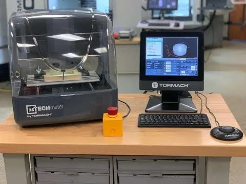

I’m not sure how long your surfacing op is but I ran an xsTech (non pro) for a 3:30 cycle as fast as I could get it to run on aluminum, so if that little thing can run for 3 hours, I don’t see why an 1100 M can’t surface for an extended period of time.

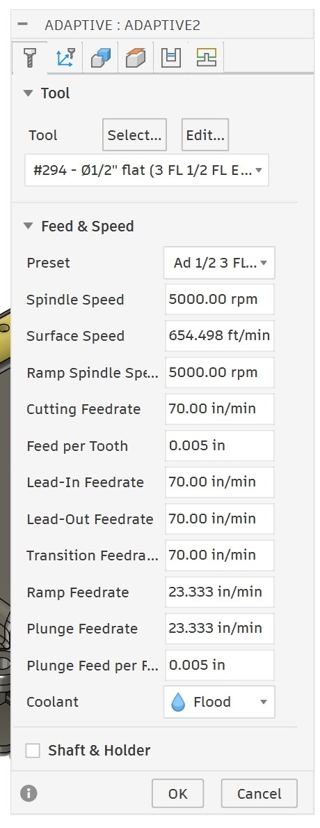

Here is an example of what ive been running my 1/2 3 FL rougher at and its been very reliable. Im running this at .5 max DOC .06 optimal load. Machine time is 58 mins according to Fusion.
How would this compare to what you guys are doing? would love to hear it.
I think thats pretty good. I have a 440. Before I made anything I ignored all the “Wizards” and just would take cuts & adjust feeds & speeds till I felt like I bogging or felt like the machine was struggling/growling. I’ve noticed different end mills of same size vary a little.
I run almost exclusively 3fl end mills on aluminum. 0.5 DOC 0.03 WOC up to 70 ipm feed rate @8k rpm with 1/4 end mill is my rule of thumb recipe. With 3/8 id be slightly lower feeds, probably 55ipm. 0.002-0.003 ipt is where i usually fall. With an 1100 id expect to be double that ipt. I can go faster but with my limited power it can get sketchy. Once spindle starts to bog I cant power out of it. I have run 80ipm & 9000rpm but felt like i was pushing hard. I use to run higher rpm, but recently started running lower rpm to conserve spindle life, I hope. So I know that if im in this ballpark im good. I have noticed at 7500rpm same doc & woc I get lots of vibration & sounds, at 8k harmonics smooth out.
I have a 2 flute insert that I clear @ 0.2 DOC 0.125 WOC 8500RPM 50IPM, comfortably.
If you haven’t done it, go run test cuts & keep notes. All the f&s calculators are a guide. So many variables can skew those calculated values. To know what your machine can run just test, you will feel more confident.

The Fusion parameters of WOC/DOC/Feed are an MRR of 2? I had some recipes that might be able to get that on my 440 under some conditions. If it were me wanting to drop cycle time, if this is somewhat steady state roughing, I would clamp a blank to the vise, start cycle and adjust up the feed and speed slider overrides manually to see if you can get through the adaptive at closer to 7000-7500RPMS and 100+ inches of feed before playing with the max roughing depth and optimal load. Don’t have all the parameters but FSWizard says you have more in the machine, but it all “just depends”…hence why your approach of learning how to fish with FSWizard instead of using ProvenCut is the right approach.
