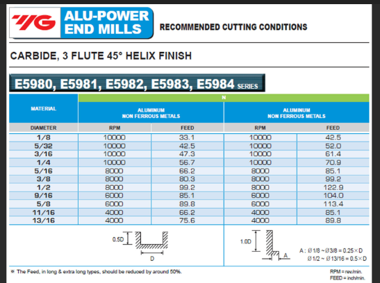

NYC CNC, youll prolly find a lot more informative views on there than here, since hes showing you in the videos optimizing the toolpath, has helped me a lot when i started with my 770M, I went from running a haas ec400 (big boy horizontal) in school to the 770 so it was kind of a backwards learning curve for me. He has a good bit of vids using a 440, 770, and 1100. PS, if you want cheap tooling right now get the emills off haas, there just rebranded YG1 Alupower emills. I run 3/8 tools normally and i can get 1.5MRR, I know i can get more out of them yet, but this is what id be comfortable with for a long period of cut time. And you can get almost mirror finish. By the way, the feeds and speeds do have to be adjusted, but i would start with light radials on some scrap pieces at 1XD axial, and run the speeds and feeds listed and go from there. For example, i run 3/8 emill at 80ipm, 1XD, axial, and .05 radial, 1/4 Emill at 60ipm, 1XD axial, .04 Radial, 1/8 Emill at 40ipm, 1XD, .025 Radial.
