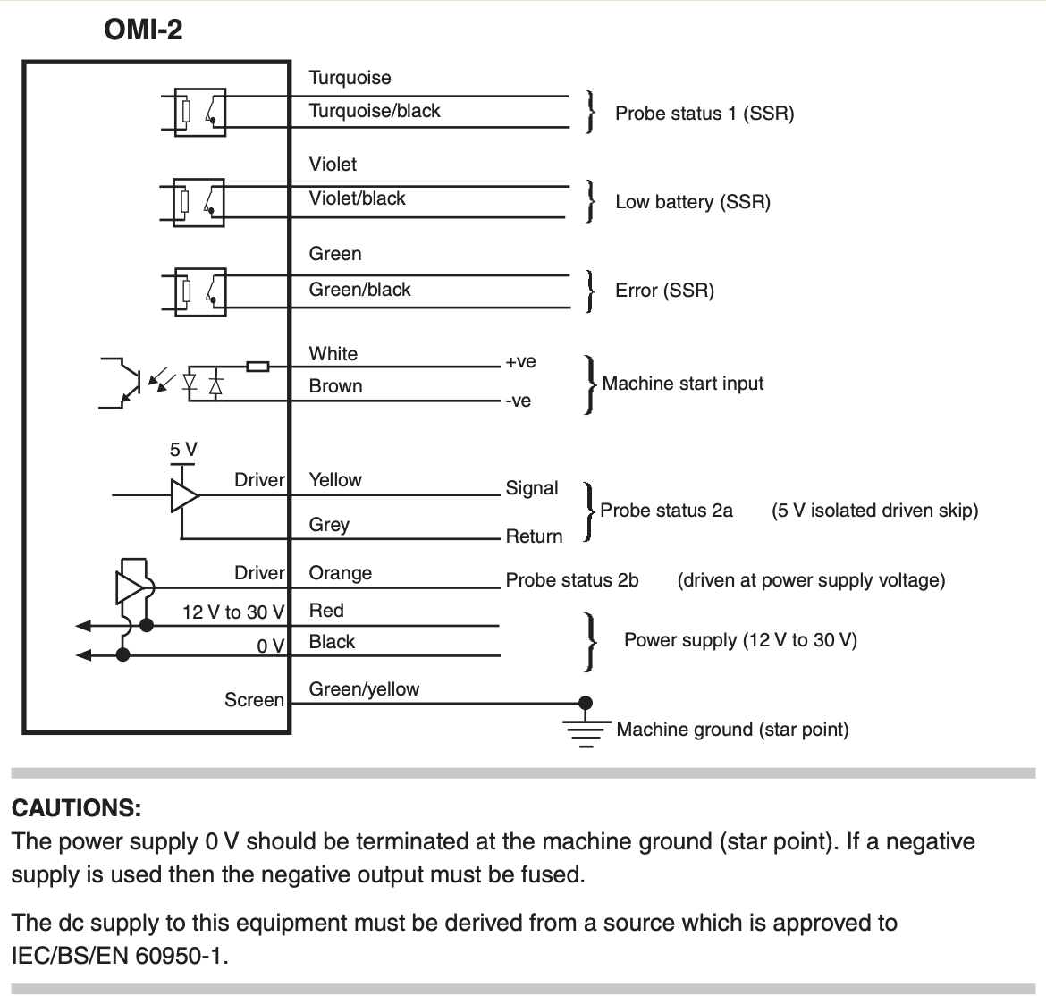

I bought a new Renishaw OMP40-2 (probe) and an OMI-2 (the receiver / interface) off Ebay. Trying to figure out how to make it work with the PCNC 1100 s3. Renishaw’s manual is beyond my understanding. Just wondering if any of you guys have made any attempts at something similar. The OMP40-2 is wireless, which is the big driver here. I”m close but no cigar yet; I have the probe working and the receiver wakes up, but so far, can’t get PP to see it. One issue is Tormach’s PP is looking for a Passive probe, NC circuit; and the OMI-2 can be switched to NC instead of NO.

First thing we need to know, is if we are looking at the same wiring diagram and not another variant.
OMI-2
GND / +12-30VDC Power
GND/Power (-ve/+ve) for the internal relay contact for “start input”
Group A contacts are similar to what I have for the GP-800 for status but yours can run a different -ve/+ve than the main power
Group B contacts are also similar but yours can run a different -ve/+ve than the main power
The -2 (I was looking at 2H) provides a single pin voltage signal and does not close a contact.
You probably need a relay to take the signal from the OMI-2 and use it to trigger the relay which will close the two input pins on the 1100 S3 if you are wiring to the same two pins as the passive probe. On some of the older Tormach interfaces, those two are the only pins that are wired and there is no voltage at the other DIN connector pins. If you have a probe or ETS that is working, then you want to mimic what it does. Active on my machine switches the logic in PP from looking for NC to looking NO on the two pins.

It’s my understanding that you need to provide power to the OMI on the Red & Black Wires. Also, Terminal 1 Signal is activated thru Turquoise & Turquoise/black wires. This should be a NC circuit that is controlled by Pins 5 & 4 on the Din Plug. I thus wired the acessory DIN plug as follows to the OMI-2….
Pin 1… 5 V measured output on Tormach– NOT USED
Pin 2 NOT USED
Pin3 12.5V measure output on the Tormach to RED wire on the OMI
Pin 4 Common / Ground – Wired to BLACK on OMI + Turquoise/black (Probe status 1 (SSR)
Pin 5 Turquoise – Probe Status 1 (SSR)
When I plug the DIN PLUG in with a battery in the probe, the probe lights up and after a couple of seconds, the OMI sees the probe and shows two green lights on it’s display. When I trip the probe, one of green lights on the OMI goes red as would be expected.
However, PP is not recognizing the proble being present. I can change SWITCH one to NO or NC on the OMI, no difference in PP. I have Pasive probe checked in PP, but PP never shows a green light on the Probe monitor indicator regardless. I can switch from Passive on to off on PP and nothing seems to cause PP to see the difference.

I think I need to confirm what change is taking place in the OMI when the Renishaw probe is tripped aside from just seeing the green LED on the OMI turn red. According to the OMI-2 manual, it would appear that probe status 1 closes or opens the circuit SSR circuit for the turquoise and turquoise/black wires. However, I don’t see any difference when I measure the voltage on those 2 wires with a VOM. I tried looking at it with a small O-scope I have, but couldn’t make any sense of it. Once I can measure that, I can hopefully use that signal to close a separate SSR that will close the circuir between pins 4 & 5 on the Din circuit. Since all I’m doing is closing the circuit, which is what happens when I plug in a passive probe, I won’t have to worry about frying anything. Accordign to Tormach’s own data, the passive probe ONLY uses Pins 4 & 5 on the DIN plug; PINS 1,3,&6 apparently are used an ETS. I’ll try getting some more measurements tomorrow night.

My main problem right now is I need to have the OMI-2 give me change in state, when the probe is touched. The OMI indicates the probe was tripped, but I can’t nail down what elso changed. The manual indicates that Probe 1 status (turquoise & turquoise/ black wires) should change, but I can’t confirm that. So right now, I have a probe that indicates it changed and OMI led turns red from green, but I can’t get that change of state into the Tormach DIN plug. I can’t find verify that change of state on any wire set coming from the OMI. Even when I change the NC / NO switches on the OMI, nothing seems to change or make sense. EXTREMLY frustrating.

The OMI, OMI-2 and OMI-2H are all different and we should have started with you posting your installation manual and wiring diagram on here instead of me trying to find them at the end of a long day…
Can you now confirm that this image matches the installation manual supplied with your device?
If it does, then when the OMI-2 has gnd and power on red and black, when the probe contacts an object or is touched, if you put a voltmeter in continuity mode to the turquoise and turquoise/black wires, it will either beep or stop beeping depending on if it is configured as NO or NC or if in Ohms mode, it will go from open to 0 ohms (or vice-versa). You will not find voltage on those wires. They are there to open or close the voltage/current from the machine control inputs. It is an SSR output (the other two models have different wiring, so my earlier comments may have been confusing you) so lucky for you, you should not need an external SSR…
Red and black need to be GND and 12-30V from somewhere else. A separate wall power supply if you are not confident to find one in the machine would work.
Do not connect the GND or 12V (black and red) in the Tormach DIN plug.
Do not use pins 1-3 on the DIN plug for anything.
Machine start input also needs power
The last thing is if you have modified the DIP switches to put them back the way you found them and verify they are correct…
