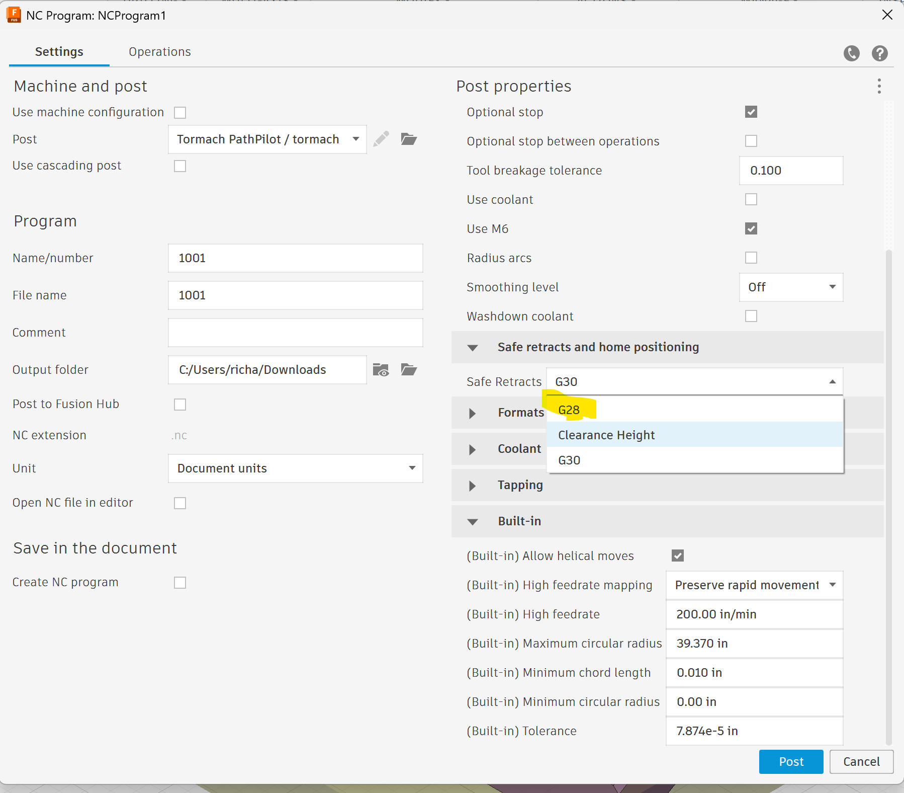

On my previous machine, I programmed a G28 position and when a job was completed, the machine went to this position instead of g30. Two questions:
  1. How do you program a G28 position in Pathpilot?
  2. Do you simply change the post as show below from G30 to G28?

Thanks guys. Looks like what I really wanted to do is change the g30 position. Now it is working as I wanted:
Thanks for the video reference.

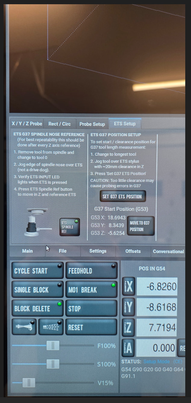

Ashraf,
Perhaps I am mistaken, but I believe the ETS does not use G30 as its reference position. Check out the ETS G37 Position setup below:
You are correct.
I had them confused (because G30/G37 were rolled up together in my mind).
  • G37 - XY centered on the ETS and at a Z at a safe height for your longest tool you would touch off
    • but if it’s Z0 for the machine absolute, it’s a long way down to the ETS
    • might not be able to use for tools you don’t want to leave in the ATC or won’t clear the ETS
  • G30 - safe tool change location
  • G28 - end of cycle location

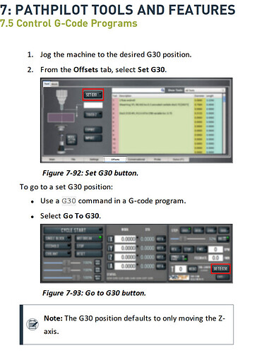

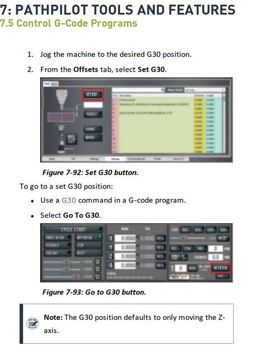

For what it is worth, I was on the phone with tech support today for another issue and I was told to use G30 as the end of cycle position. They did not recommend G28.
I am sure that tech support knows their stuff and their answer is probably more correct.
G30, as defined by LinuxCNC, which is what PP is built on, is the specified location for tool changes and they have protections built into PP for G30.
G28 has an almost identical definition and use case, save for the fact that G30 is specified and used in the tool change chain of moves.
The absence of a safe Z axis move being built into G28 as identified here, appears to be the one limitation to using G28 with “reckless abandon”.
