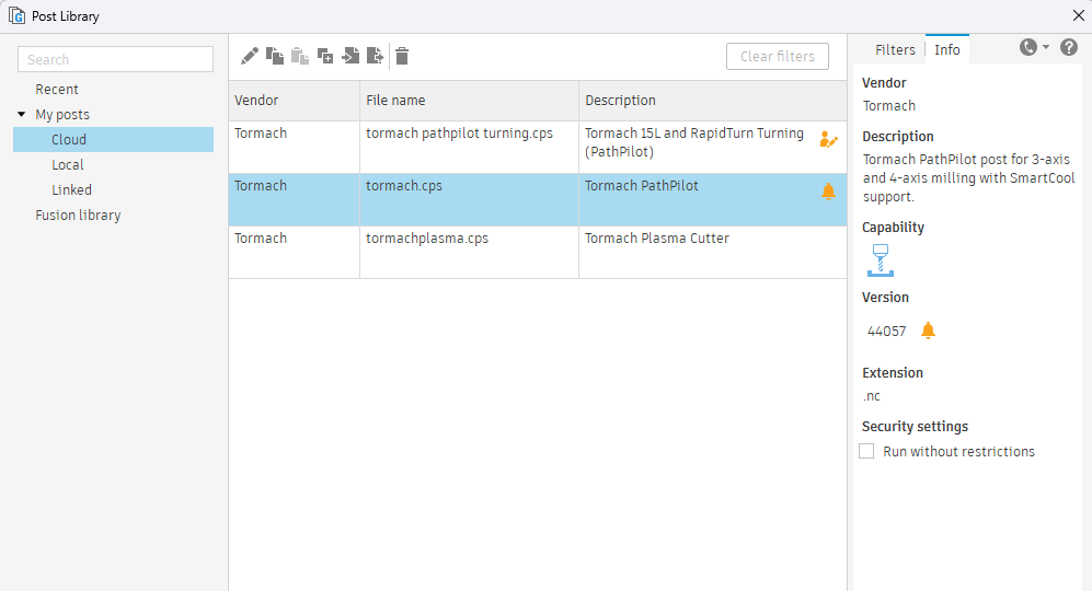

I searched the knowledge base but didn’t see anything - what are people using for a post for the 24R with the ATC? Is there a standard PathPilot Fusion post that works as a starting point?
The same post in Fusion works for ATC and NoATC versions of our machine. If the machine has an ATC installed then PP will grab the tool and keep working, if it doesn’t have an ATC (or the desired tool is not loaded in the ATC) then the operator will be prompted for the tool. Nothing has to change on the outputted file.
This video covers these scenarios https://youtu.be/tOVniEH3uTc
Where can I download the Fusion post?
It is built in to the platform. You should be able to see it listed on the Cloud in the post library. Look for Tormach PathPilot.
Thanks Davie. Didn’t even occur to me, the last time I set up a new machine was years ago and I couldn’t imagine it being this easy :joy:
