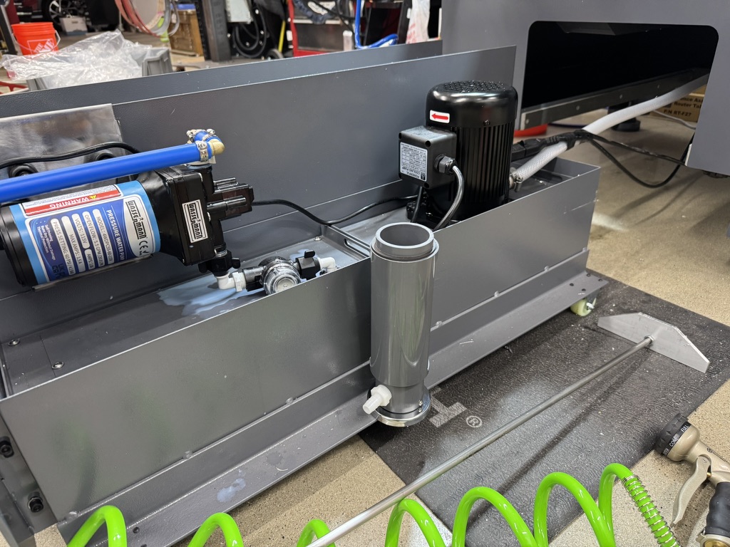

I installed a NexJen Technologies oil separator Our Products | Nexjen Technologies. I put it on a wifi controlled switch so I can run it periodically when I’m away from the machine. The coolant seems to last well if you keep it as oil free as possible. The coolant in my lathe is over a year old now and is still fine.

That’s a skimmer rather than a coalessing separator. The functional difference in my mind is that the skimmer just runs a belt through the coolant but doesn’t really move much if any coolant around. The NexJen (which is just one version) actually pumps a significant amount of coolant through a box that separates the junk from the coolant and then returns it to the coolant tank.
I find that preferable for leaving the coolant in the machine for longer periods without use. Time will tell.

I have a skimmer and have found it to be only marginally useful, especially for a situation like leaving the machine unused for a month at a time. To be most effective, the skimmer must be running pretty much all the time because it only affects a small area of the sump. As it picks up oil (and some coolant) the catch can fills and if it’s not monitored and emptied, eventually, it will overflow back into the sump. Since oil floats, the first thing that ends up overflowing is all the oil that has collected. Since the catch can is under the machine, that means you need to pull the tank out and check it periodically, not a major issue, but not ideal if you’re wanting to walk away for a long time.
The nexjen arguably has multiple advantages here. First, it processes MUCH more liquid per unit time. It actively pumps coolant through the filter rather than passively pickup up stuff as it floats by a belt. Excess coolant returns to the tank while the oil gets trapped in the unit floats to the top. The unit itself is mounted on the outside of the machine and is clear so you can see when it’s time to drain the oil. Draining the oil is just a matter of opening a valve and collecting the runoff. All in, a much better approach IMO. For what it’s worth, I have no association with any coolant filter manufacturers don’t have a nexjen yet but it’s on my shortlist of additions.

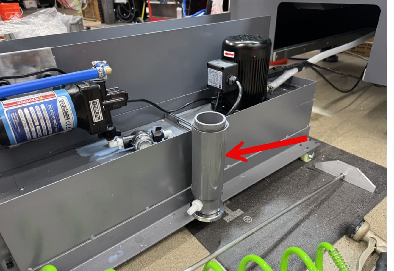

One more addition to these and my earlier comments about NexJen is that on my 1100MX I was not able to use the 3 ball float pick up. They make another type pictured below that fit into my coolant tank. I am not sure what the layout of the 1500MX tank is but on the 1100MX tank the internal baffles and height prevented that. I do have to keep the tank topped up for it not to capitate as well.

I go t the NJT-1500 not the LP. I don’t think these smaller machines including the 1500MX need a larger pump. The 1100MX has a small coolant tank so the larger pump is a problem as well as I had to swap the pick from the 3 floating balls to the tower style in the photo below because the 3 ball will not fit in the 1100MX coolant tank.. I worked that out with NJT directly before ordering. Contact Bob Kretchmar there at NJT very nice guy. rkretchmar@nexjentech.com
