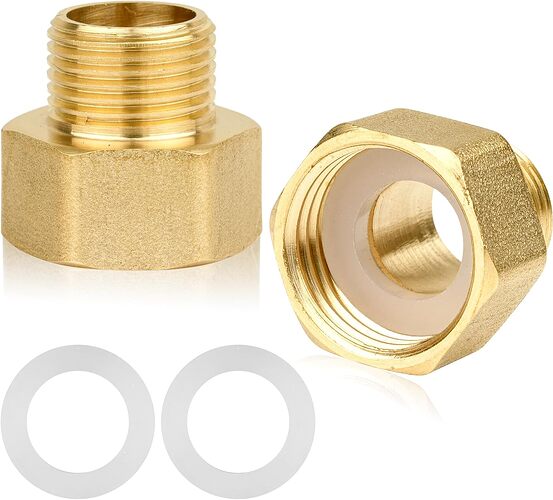

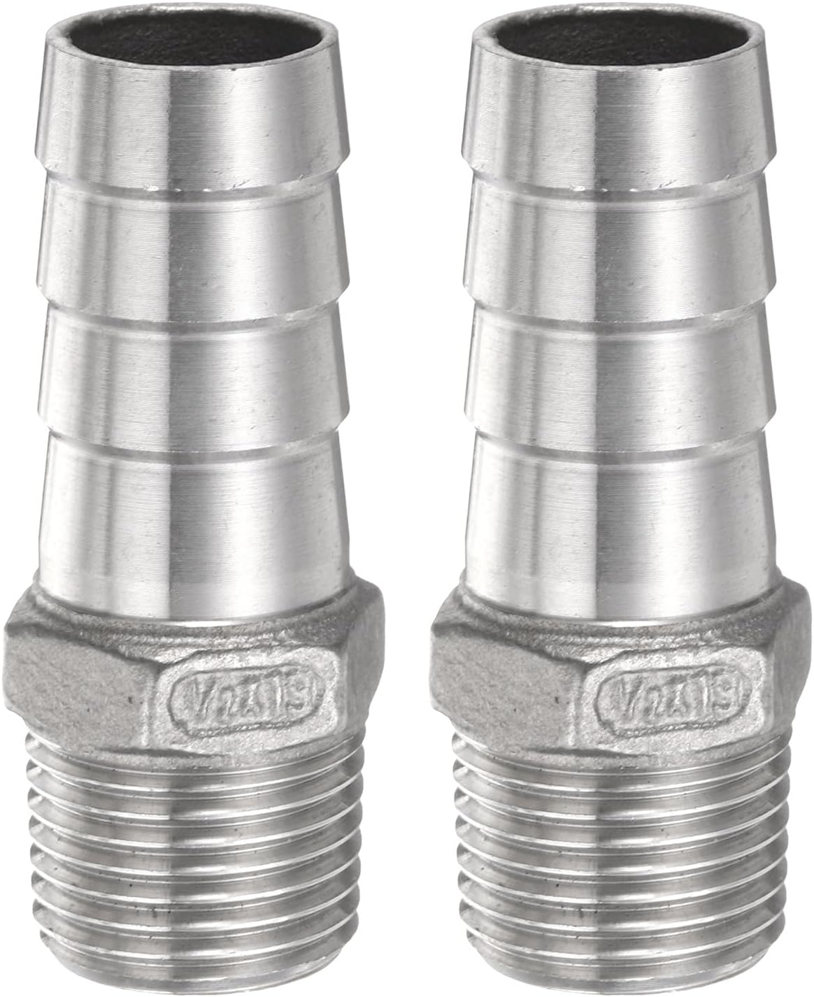

I am based in the UK and I recently upgraded the pipe between the pump & spray head on my 1100MX (2021 model) to one of 1/2” diameter. The items I purchased from Amazon, which have all worked absolutely fine were;
Hope this helps.

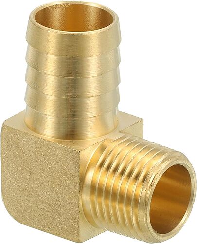

The pump on my machine is the standard 1/8 hp pump. The 19mm barbed x 1/2” adapter screws directly into the pump. I then have 3/4” PVC pipe all the way from the pump up to the spray head. The 1/2” threaded end of the 1/2” to 3/8” adapter screws directly into the cut-off tap of the spray head then the elbow fitting screws into the adapter to connect to the pipe from the pump. Flow certainly improved over the factory setup. Previously I would open the door when the machine was running to brush away any buildup of chips without turning off the coolant… I tend to get a little wetter if I do that now :slightly_smiling_face: and it certainly improves chip removal.

It looks like the 19mm barbed x 1/2” uses the British parallel thread (shown as G 1/2 on the Amazon URL). The pump itself has almost no official information available (no manual exists, nor detailed thread information), but I did see it is marked as both NPT and BPT in anything I’ve been able to find (both of those are tapered). There was never a clear consensus for documentation. From what I can tell the NPT and G 1/2 in this case have the same thread pitch, but other details differ on what a “perfect” thread match is. I am guessing that the the 19mm required the teflon tape for sealing.

I too had difficulty finding the information. As it was, I disconnected the pump and by chance had a different fitting, but with the same screw thread as the barbed fitting that I could test on the pump to see that it fitted before ordering. The same went for the spray head, so I could be certain I was ordering the correct fittings.
As a matter of course I always use tape on screw threaded connections if at all possible and did so in this case and to date there have been no leaks. The only leak I did discover after this change was in the enclosure where a joint needed better sealing as with more coolant being sprayed, a small amount was escaping through the panel joint.
Because the piping is quite thick and to a certain extent stiffer than the smaller piping supplied as standard, rather than using the moving train track, I routed the piping (if looking at the enclosure from the rear) to the righthand side then through the gap at the top of the enclosure and to the right of the mill head. It then loops down the side of the mill head, then under the head to attach to the barbed end of the elbow joint. By giving it enough slack (but not that much that there is any chance of entanglement with the mill head) there is enough piping to cover the full distance moved by the mill head in the Z-axis. Where appropriate on the back of the enclosure I have tidied the piping with zip-ties.

I ordered the same pump design direct from Asia because I needed taller for a smaller footprint reservoir to fit inside the 440 stand. I think there are only a couple of manufacturers that make the same design with many distribution channels. The specification I was sent (from the distributor house that is the manufacturer) is that the outlet is NPT and it scales up depending upon the pump HP and flow curve desired (they seem to offer one smaller size to alter the flow. I opted for the largest NPT offered to do that with a different outlet fitting.
NPT is what I used and it seals correctly with standard teflon tape.
