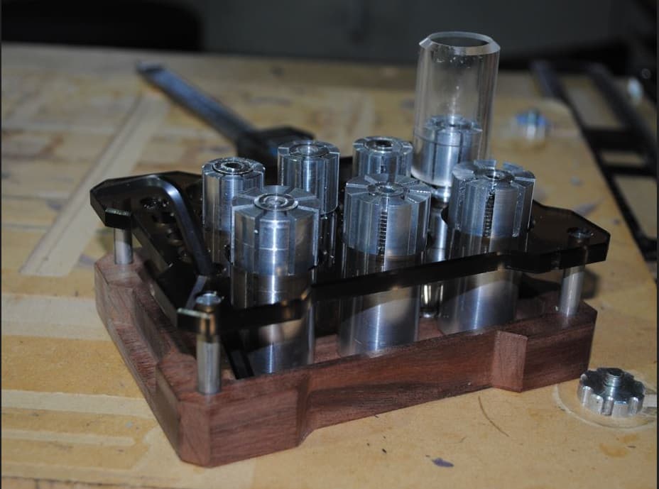

I make small ones out of material drops to use on lathe and 4th axis. The ones shown below are blind and lock from back. I have others that lock from the front. Great for mill ops on tubing and or making gears. They mount in collet blocks or 3 and 4 jaw chucks. Can be quickly sized to fit material .

So when making these I assume you use tool steel for these. Do you harden them expanded or just loose? Do you finish with a grind to final tolerance?
How do you design the outer jaws to stay parallel when the jaw expands? Or do you turn the O.D. after the center expansion bolt is tightened. Also guessing the clamping range is less than 1/32 or 1mm similar too a normal collet?
My train of thought is drill a round bar then cut the taper with a MT-1 taper cutter, then cut the jaws with a slitting saw? I’m just afraid the jaws are going to start wiggling after the first couple saw cuts. I am making it as short as possible 11mm 3/8” so it might be ok.
The ones shown are made from 1", 3/4", 1/2" alum. bar drops. Just like soft jaws!
They work great for holding tubing, large gear blanks and round stock for lathe operations. Brass is expensive, bore the brass drop and blind mount it in arbor. Run lathe ops and you end up with almost no waste.
Anyway you can make what you need from tool steel, brass, aluminum or whatever.
Just a solution to a work holding or fixture holding problem. I like the blind arbor style enough I applied it to a number of other tools I use like cnc router and table saw to hold custom fixtures in locations.
