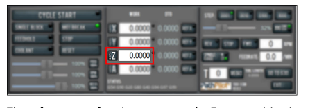

move tool over ETS and on the tool offset screen tap button to set tool height
Then move this tool over and use it to touch off the top of the MATERIAL using a piece of paper or other method. then zero the Z work offset
Locate X,Y work offsets on the material as with any program
At this point you are done with all setup! the machine knows where all offsets are and you are ready to run and cut

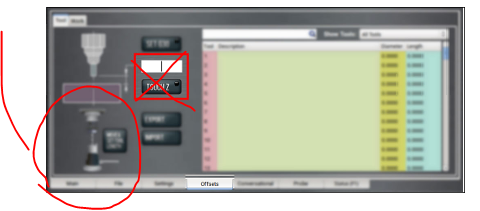

This is Not correct for the 24r router ets
After you determine the height of the ETS that value is stored here

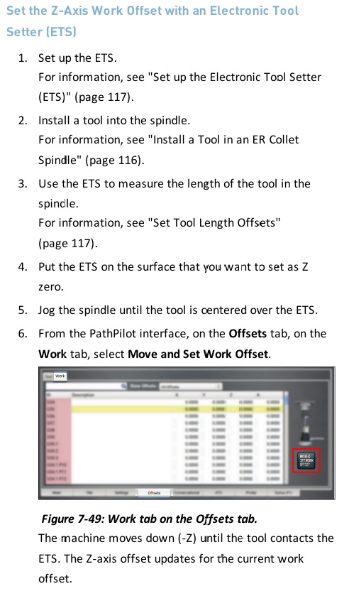

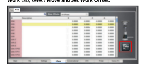

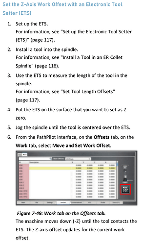

you can move the ETS to top of material then set Z work offset using the below method
first load tool and set tool number
touch tool off on ETS like all normal
now move ETS to top of part and with same tool
move the spindle over the ets on top of the material and
press button on this screen to set Z work offset
then move ETS back to location
And set XY work offsets and you are ready to run program
Tormach even provides a kind of location tray that you stick down to router table so you can move ETS on and off that tray and the machine always knows it is located in the correct place for g37 program ETS touch offs.
This page does explain this well. Some of the manual is confusing but this part is clear
I dont use this method much and did not want to confuse people more by trying to explain it also.

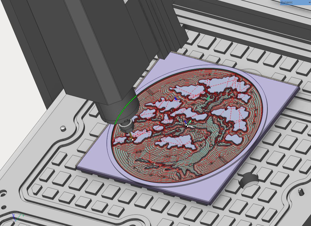

I loaded material and did exactly what I detailed above and was cutting this in less than 5 minutes
this is example of the very first code I ever run on my 24R just a couple hours after the crate arrived.
