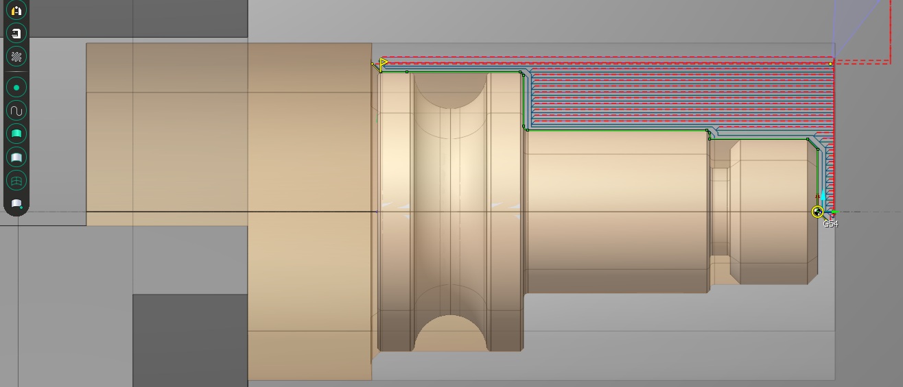

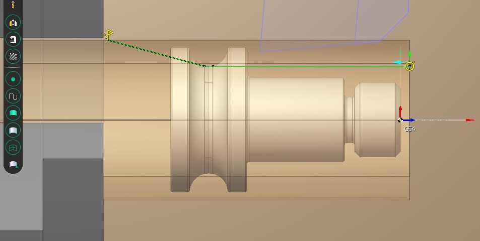

I’m importing .IGES part files exported from Fusion 360. Well they import just fine. But when you create OD Roughing operation the profile of the part is wrong. See last picture.
So I created the part in SW then exported an .IGES from SolidWorks, imported into ENCY 2 and then created a OD Roughing operation and it works. See first picture.

I have seen this before. Best I can tell is some programs will export a crippled iges model.
Not clear why or if it is a bug or they did it on purpose. Might try step files.
I remember having to export files in another format like step then loading them in my cad and exporting them again as iges to sprutcam or ency2.
I know of only one issue with spherical shapes that iges files and sprutcam has always had an issue with but your model has none of these.

Hi Lane, Thanks for responding. I’ve tried the step through Fusion 360 and that doesnt work any better. I have exported my files into Solidworks, then exported as a iges file and that works most of the time.
Doesn’t Ency 2 have a way to create the contour manually. I’ve tried to figure that out and cant seem to create the contour manually. I’ve got the contour editing toolbar to come up but I’ll keep playing with it until it makes sense. Any tips would be appreciated.

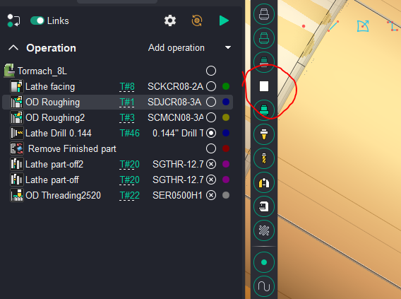

To manually create the contour
I make sure workpiece visibility is turned off so that selecting the contours is not block by the workpiece
Then I add a operation like contour and select the tool to be used for that operation
Then go to job assignment and delete anything it might have auto added when you created the operation
With job assignment tab highlighted and empty “

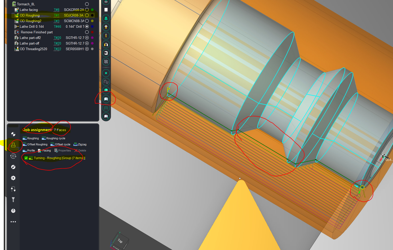

I then select the surfaces of the contour holding the shift key down. “try to select each surface from front of part going back toward spindle in order.” I use surfaces “shown in blue” as selection method. edged selection also works but not as well imho
Then in job assignment window choose the type of operation from the list of roughing types.
When you do that it creates the operation with the selected surfaces as the job assignment and should say something like “turning-roughing [group(7 items)]”
Then I grab the yellow flag or circle and drag them to locations to start and stop the path, and direction. then move the approach and return legs as desired to account for stock size and other model surfaces not being machined
Ency does the best that it can to understand the tool and the profile type and creates the profile like shown. it will try to only reach of turn surfaces that type of tool can access and ignore ones that tool can’t reach. “note area it did not try to reach because the tool and path type wont allow it”
Reset and run operation to see the tool paths created for the contour selected’.
To be honest this works very well but takes some time to experiment with what works best for you and the way you setup jobs and operations. I spent some time and just tried different operations, with different tools and different ways to select the profile or contour and then run to see results. move the circle and flag around, adjust settings and run again and keep changing setting until I understood what each one did.
Most of the time its easy to get setup and you will have good lathe code in a matter of minutes
but you have to be careful. it does not always create good approaches or returns and I check everything carefully to avoid drama.

Thanks Lane. I was able to play around and try different tools and operations and it worked. Your explanation was very helpful.
