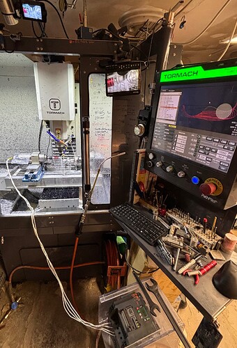

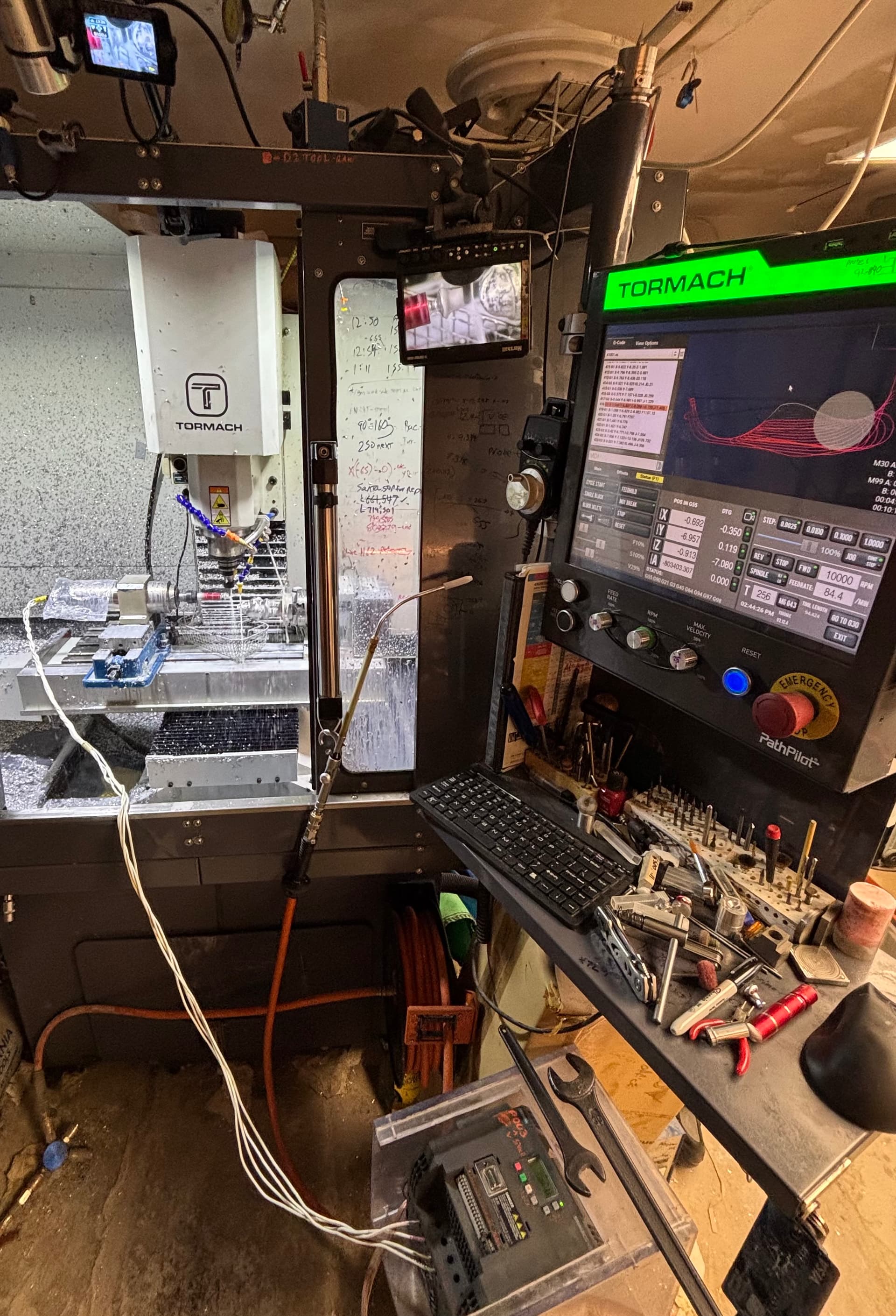

You could always just wire in an external VFD and hit the go stop buttons on it. That’s what I do. I load a second spindle onto the table and have a totally separate vfd for it. It’s not as turnkey as what your talking about but I don’t have to power down either.
Depending on the vfd you can wire it up with a little control board to do rpm, go, stop, reverse and Estop without to much hassle.
Many thanks Dr Jones,
This is a very interesting idea, I love the simplicity, and was thinking it could work but then realized that I may not be able to take advantage of it as I need to use the lathe to do some ID and OD threads, so need the rotation sensor that the RapidTurn has to ensure the multiple passes of the thread cutter are all overlapping. I guess a threading capability could be implemented, but it starts to potentially need a micro controller feedback loop etc… Please correct me if I am missing something, I need to think about this some more.
Thanks again for this creative suggestion with picture, happy to see the usage model is not unique and others like yourself have tackled similar needs.
