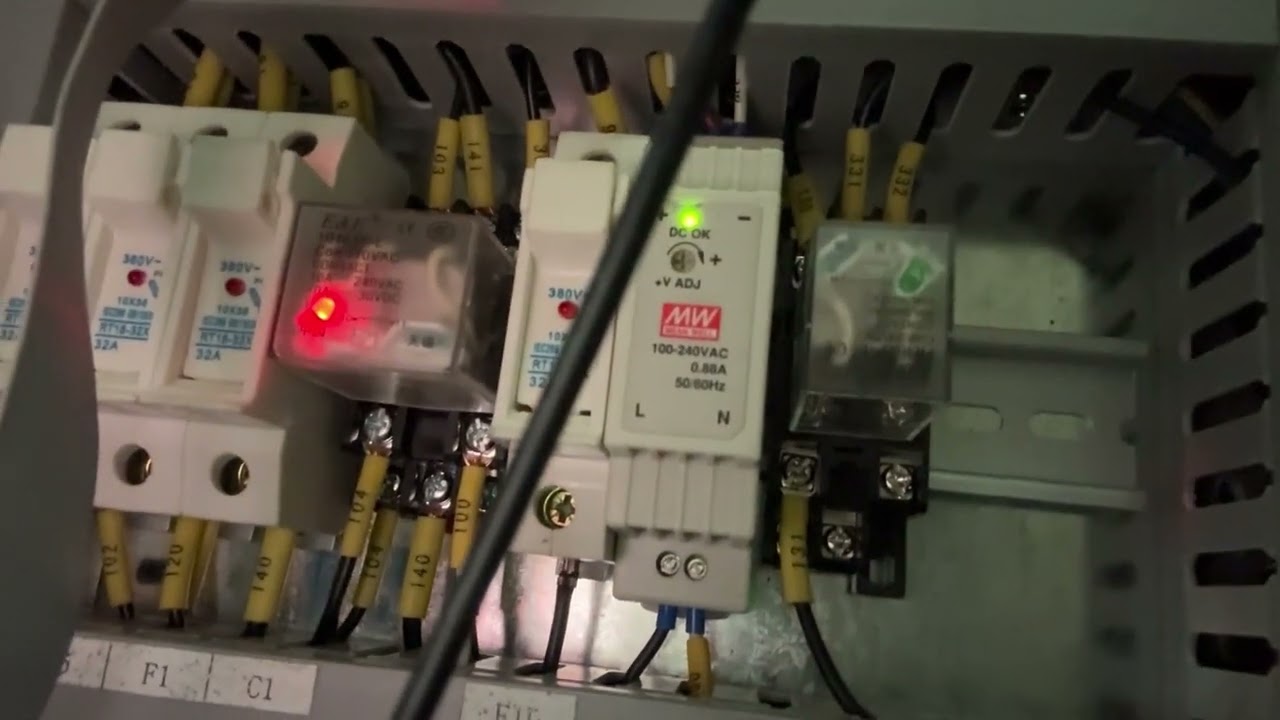

Verified C1 energizes (red LED illuminates and remains on)

Since you have reseated the serial cable. You could also try and verify the terminal block wires are tight. Literally put a screwdriver on everyone and check they are tight.
Working in an industrial environment most of my life you would be surprised how often reseating cables and tightening terminal block lugs actually works when weird stuff happens. The slight vibration over time can cause things to loosen up. After that its a hardware troubleshooting kinda game.

You didn’t provide test results of:
  1. 110V voltage input at the 24V and 48V power supplies
  2. appropriate DC voltage out of each of them
It sounds like they aren’t getting 110V if you have no motion or coolant.
Yes, there should be a noticeable sound when the machine is enabled with the push button switch actually makes the contactor to close the contacts and provide high voltage to downstream components.

As for voltages, the 24vdc power supply seems to be functioning, I get 120vac in and 24vdc out. I did not check the 48vdc power supply directly, but the fan is running (which is 48vdc) so it seems to be okay. Any other ideas?

If you have a fan spinning, then it should have 48V supply but I’ve had voltage on that supply but no voltage at the individual component that needed it (my ATC control board went silly and eventually got it to reset after following procedures for it). I’d still want to confirm the MX3660 is getting voltage at the designated supply terminals before assuming it is.

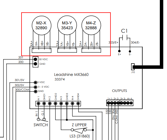

0V across 304/303 on C1 when machine IS ready.
15VDC across 304/303 on the C1 when machine IS NOT ready.
This seems strange because I only know of a 24VDC PSU and 48VDC PSU? I don’t know if this is normal, I can’t find where 303/304 originate in the electrical drawing, so I don’t know what the expected voltage is.
edit:
Oh wait, they originate from the MX3660 controller.
I’m going to try the more advanced communication troubleshooting at the bottom of the page you linked.

For anyone who comes across a similar issue, this turned out to be a failed MX3660.
