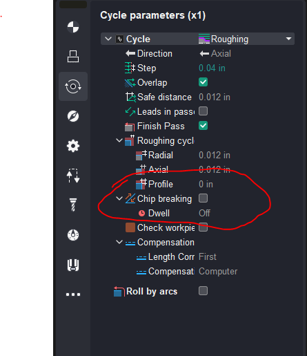

Noticed this was not in their manual and figured I would post a note showing this feature I find very helpful when running aluminum in a lathe. Ency added a chip break option for the lathe profile cycle.

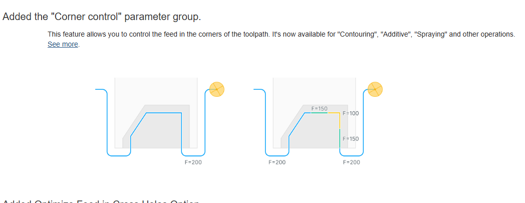

Another very nice cam option I found that has been needed for many years that helps cam setups for a 24r router is a way to control feed speed when approaching corners. Router setups can be a straight forward to setup with cookie cutter type tool paths but corner feed speed makes this a problem. This is part of the manual but I decided to add note about it because it’s a great feature.

I noticed if you load an old program with older operations not all of the newer setting show up. If you create a new operation directly from menu from scratch the new setting are available. “lathe chip break” so far, does not show up on old programs, but if you setup same operation new it does. TBH this is all normal software stuff.

Edit. I did notice a difference in the the machine definition for the 24r router. Older versions I could run tool paths the last few inches of travel off the end of the machine “Apron” This version appears to not like those setups and I will need to change something.
