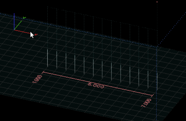

x 1 y 2
x 1.5 y 2
x 2 y 2
x 2.5 y 2
x 3 y 2
x 3.5 y 2
x 4 y 2
x 4.5 y 2
x 5 y 2
x 5.5 y 2
x 6 y 2
x 6.5 y 2
x 7 y 2
G80 (Cancel canned cycle)
G0 Z 0.5000
M9 (All Coolant Off)
M5 (Spindle OFF)
G30 Z 0.5 (Go in Z only to preset G30 location)
G30 (Go to preset G30 location)
(----- End of Pattern Drill -----)
M30 (End of Program)
now when I load this program I can see all of my holes.
Be careful when doing this and I suggest running it without a tool first just to make sure nothing is a miss.
