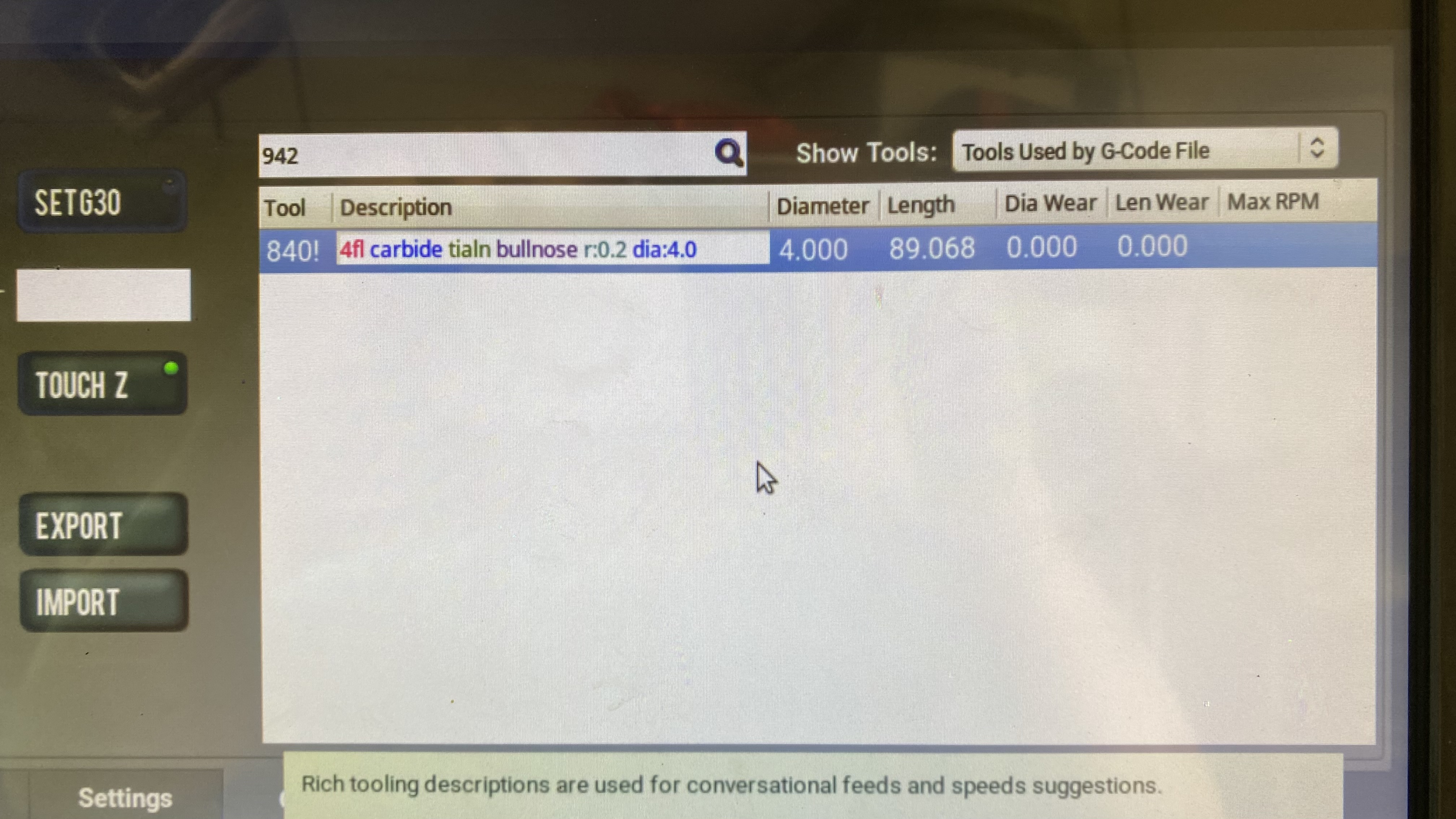

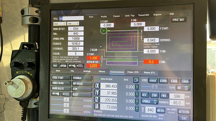

Anyone else get these wrong field auto fills when using radius tools? This has been an issue for at least a year.

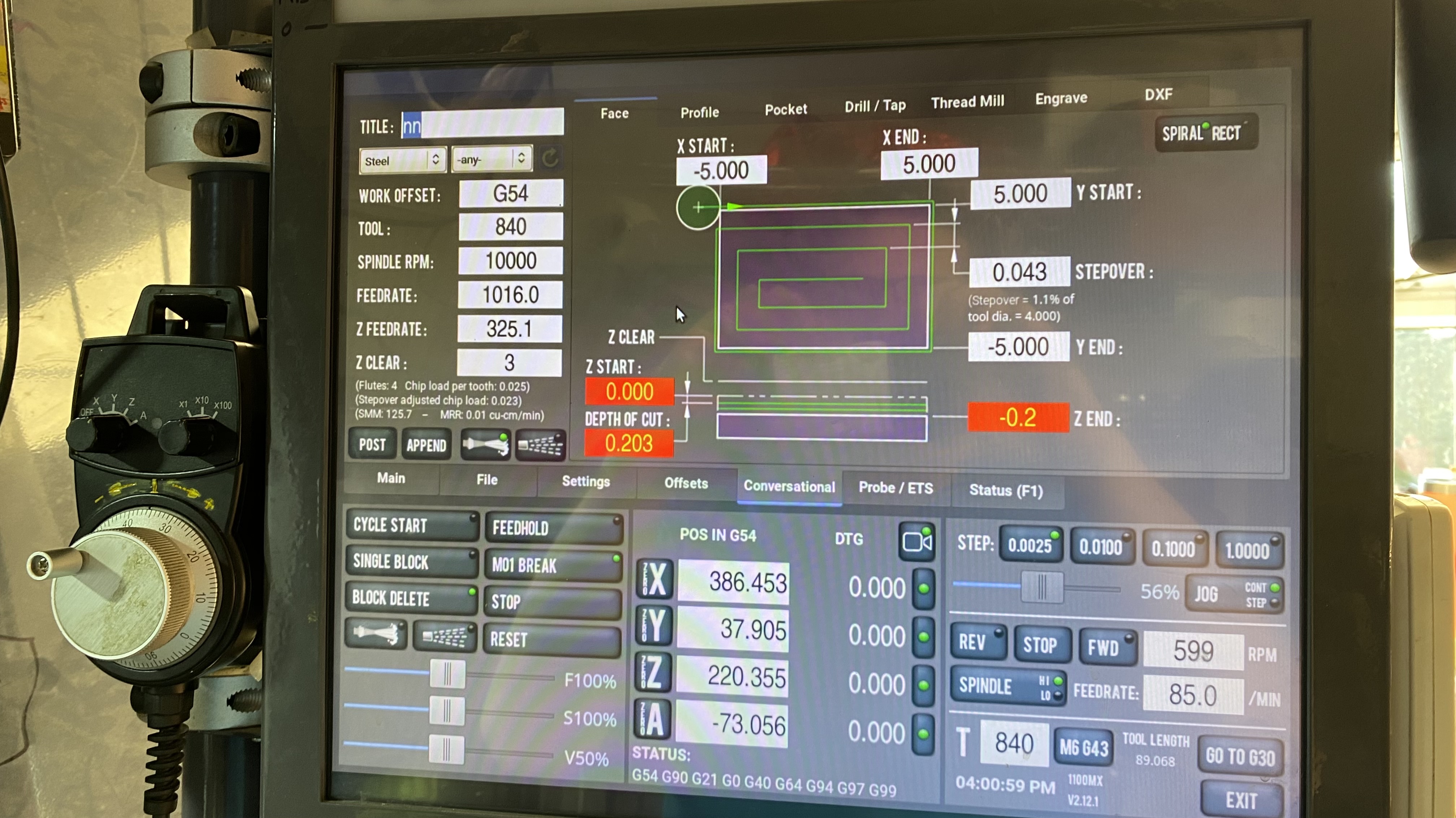

The values in red are from the auto fill refresh button.
Also here is the tool info.
Also the step over on radius tools is in my opinion being calculated wrong but I might not understand something about why the step over is so tiny.

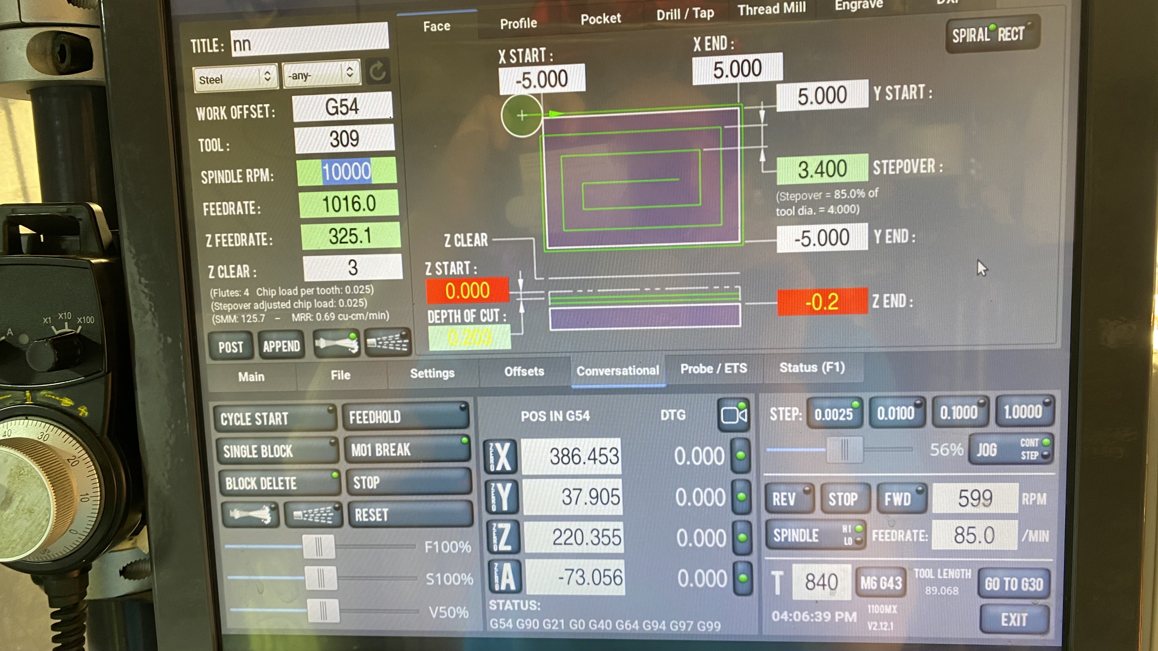

Aso here is a screenshot of the same diameter tool with no radius.
Please advise as the depth of cut is still more than the total cut depth.

I’ve had a similar problem and filed a support ticket in January ( [TS-15463] Conversational programming, recommended stepover bug in metric units). I think it only affects G21. It is reproducible on virtual controller in Pathpilot Hub.
@Joel_Kuusk Thank you for that information, I was able to locate your case and the linked bug report. It looks like our software team is currently testing a fix, which is scheduled to be released with v2.12.3
I would recommend that anyone experiencing this issue keep an eye out for our next PathPilot release.
