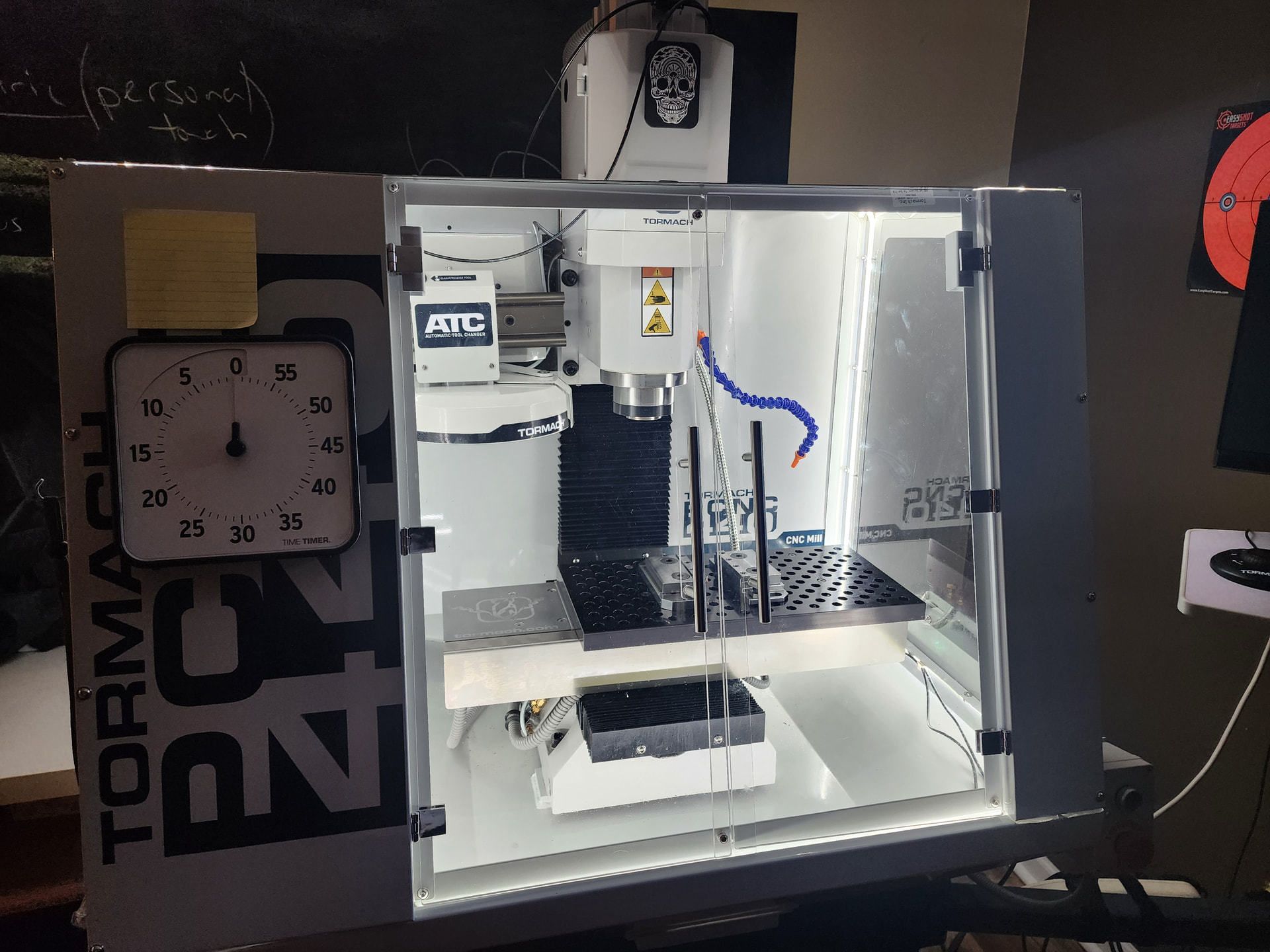

CNC Lighting Option (PCNC 440 )
Here’s a decent solution for improved lighting.
I used two sets of these products:
Power: Amazon.com: ALITOVE DC 12V 5A Power Supply Adapter Converter Transformer 60W AC 100-240V Input with 5.5x2.5mm DC Output Jack for 5050 3528 LED Strip Module Light : Electronics
Lights: Amazon.com: TOPAI 12V COB LED Strip Light 6000K Cool White Waterproof IP65 480LEDs/M Super Bright 4000Lm CRI>90 16.4ft/5M Self Adhesive Dotless Cuttable Flexible for Bedroom Cabinet DIY Lighting : Tools & Home Improvement
Accessory: HAMRVL 8mm Cob Led Strip Light Connectors 2 Pin,Led Strip to Wire Transparent Clips Solderless Adapter Terminal Extension Connection for White/Warm Led Tape 12V 24V (Total 20pcs) - Amazon.com
Take care.
It looks well lit. I don’t know how anyone can function without extra light, even a shop light right over the machine isn’t enough. I have not had peel-off adhesive anything last inside of mine but I run flood coolant…
I have two LED floods in a custom top panel where I cut holes for them. The same could work just putting them on top of the Lexan of the factory top panel.
