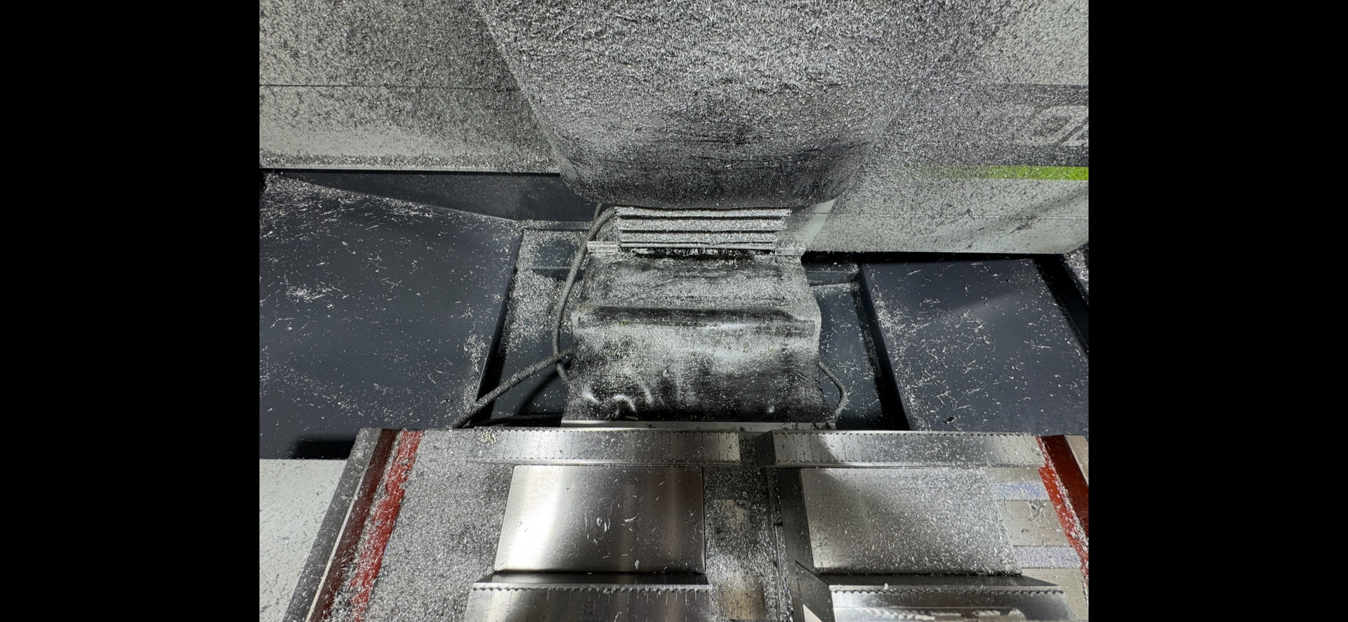

Chips on the rear Y bellow causes part failure
I have so many parts fail because of debris trapping in the rear Y bellow and limit the range of motion. Is there a mitigation for that? Obviously I clean the bellow in between runs, but some runs are long and debris accumulate there. Thanks

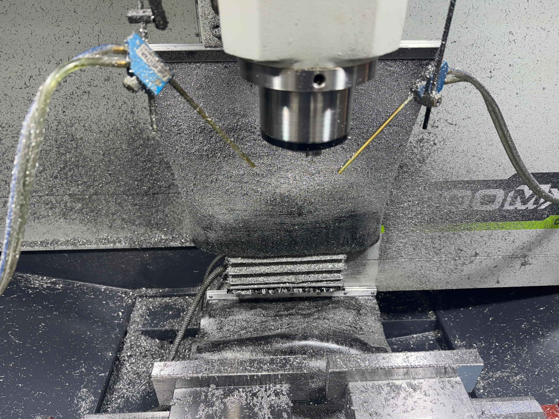

I use a sheet of metal to keep the clips from going that way. Just make sure it’s strong enough that it doesn’t bend down and get into the Z way cover while your running. The chips really pile up on it though and onto the work. You basically need another coolant pump just for the front and back way covers. There’s a lot of room between the Y way cover and the bottom of the Z way cover. If tormach put a 30 degree bend in the Y way cover it would evacuate a lot of those chips. (Wink, wink) :winking_face_with_tongue:

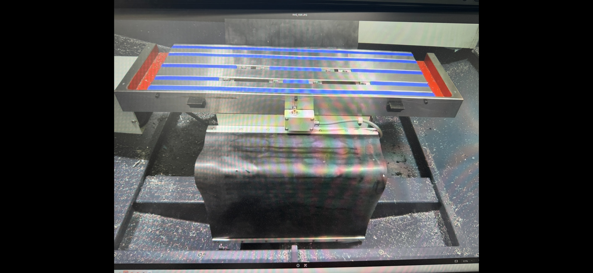

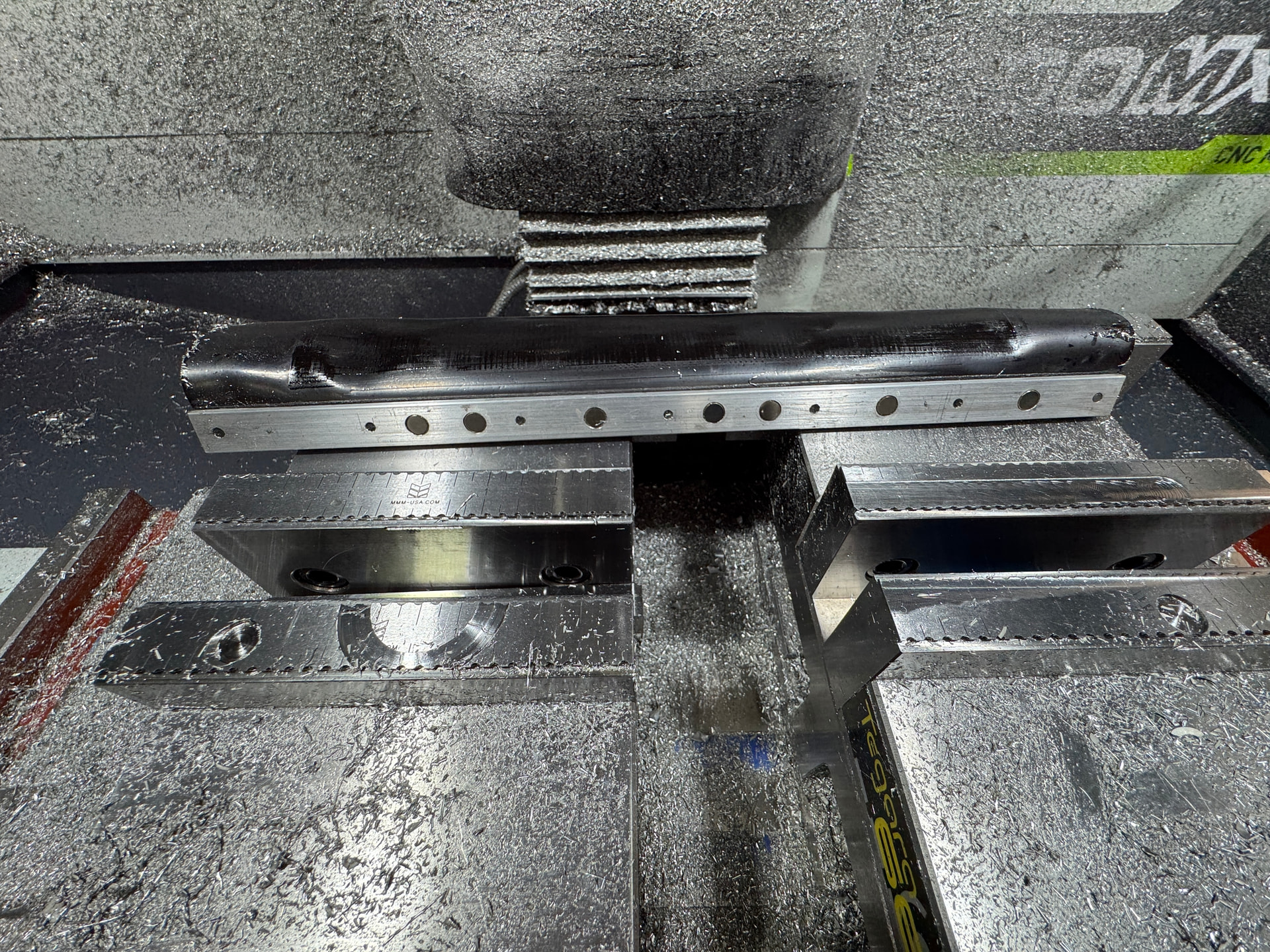

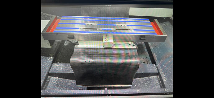

I installed rubber way material over top of the bellows on front and rear Y and Z
Bellows are in as new condition underneath
The chips that accumulate stay right against the table
Ed
I have been using that cover for some time now. Works great so far. Would just have to scale the design up for an 1100.

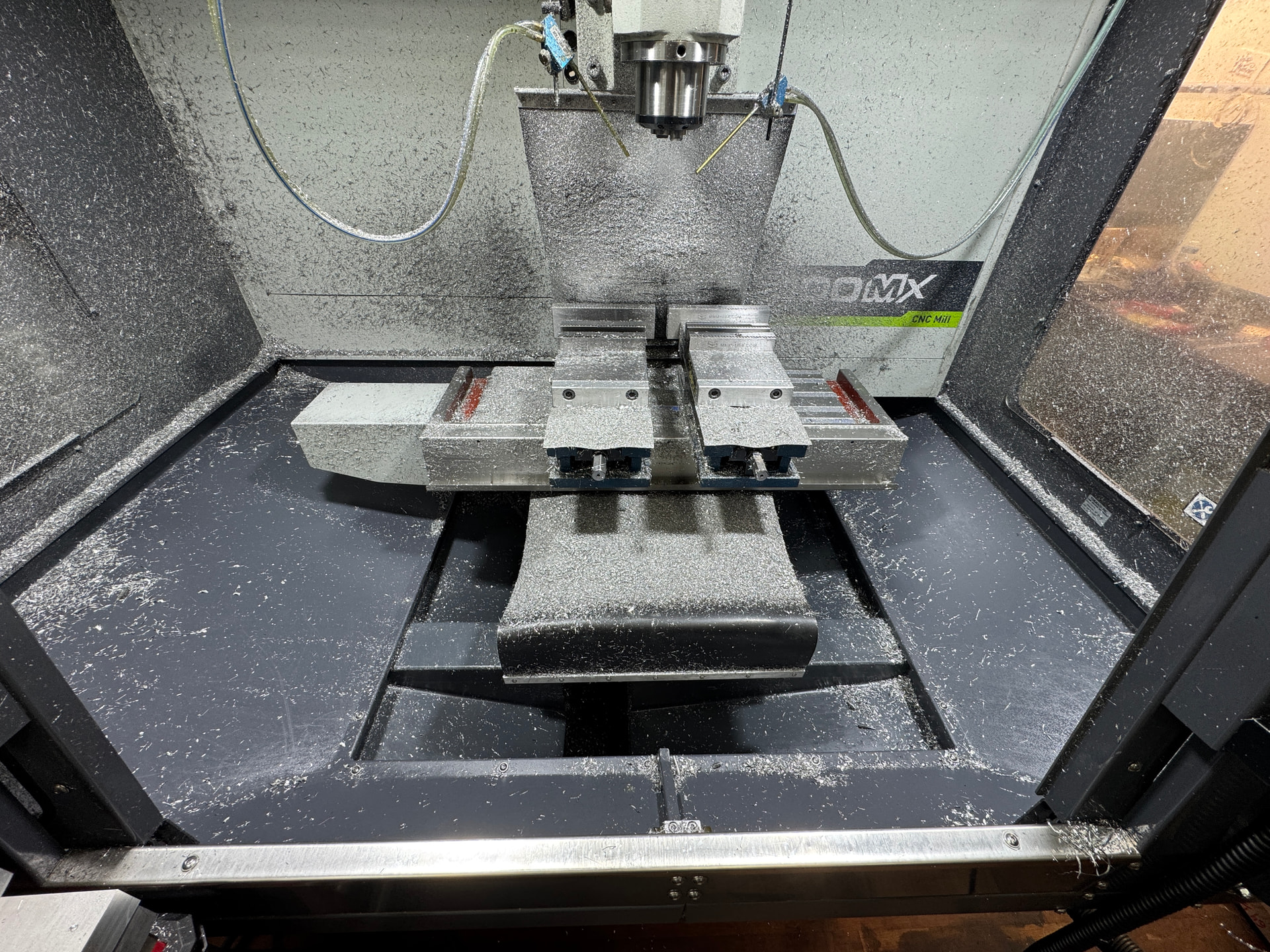

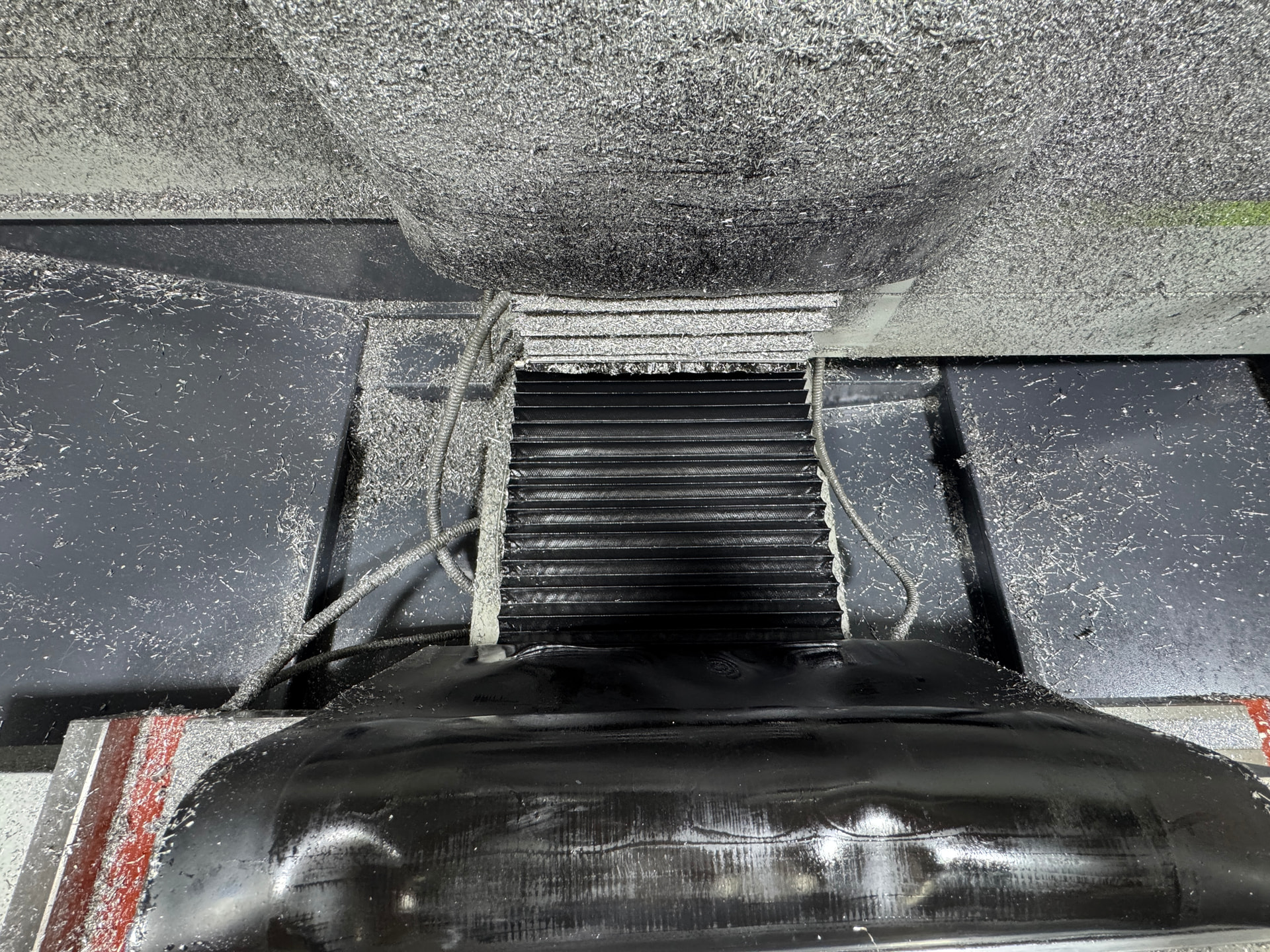

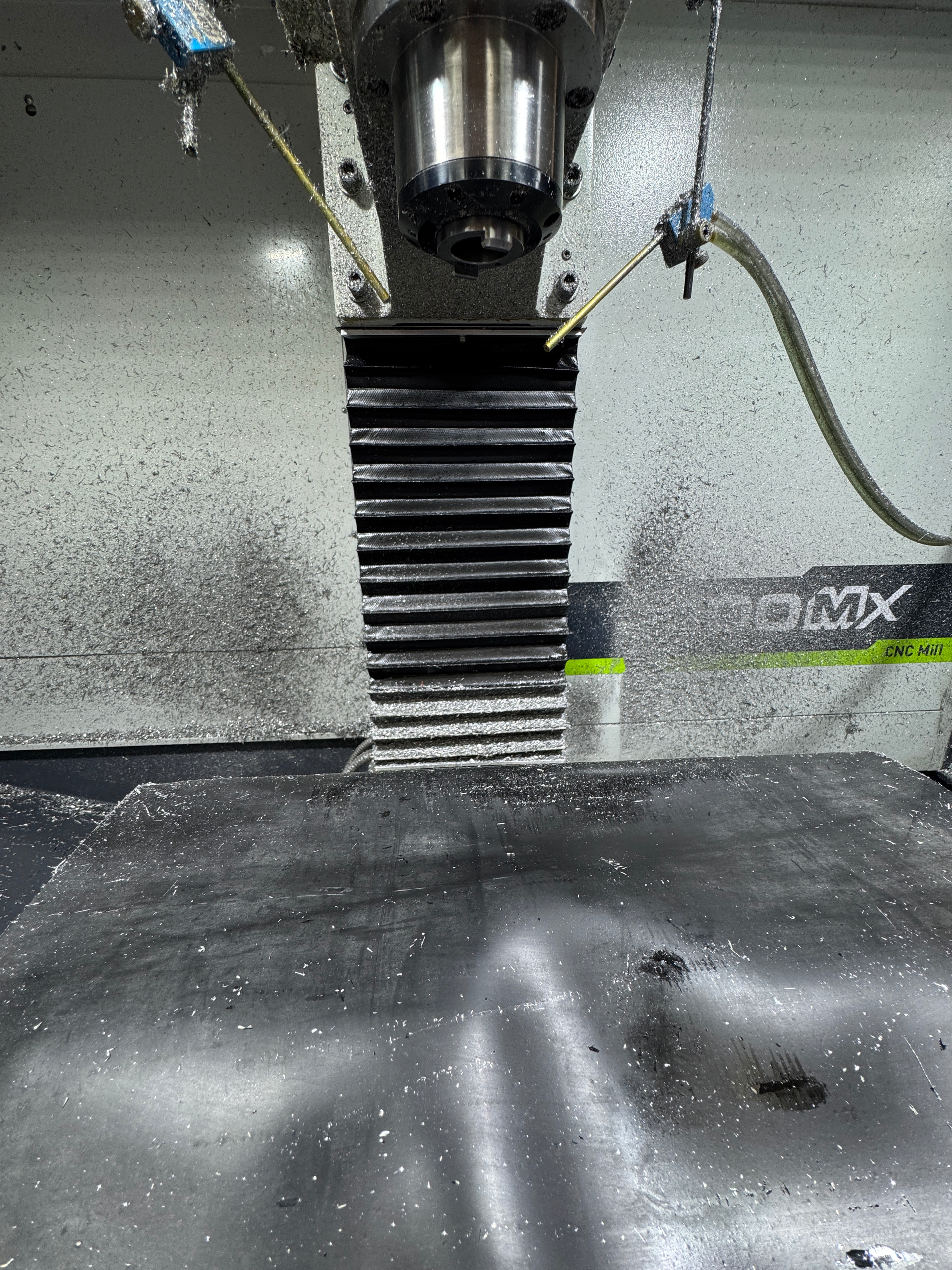

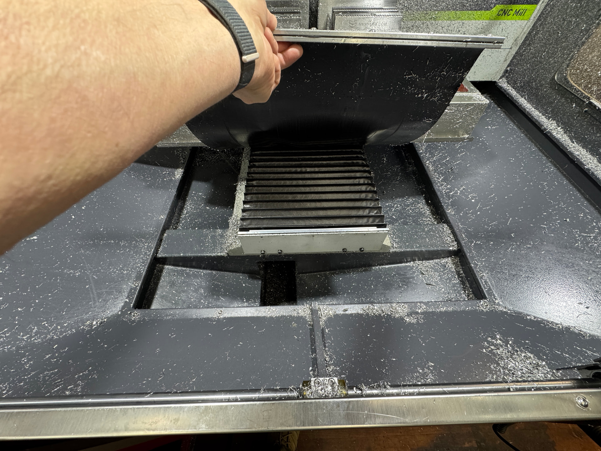

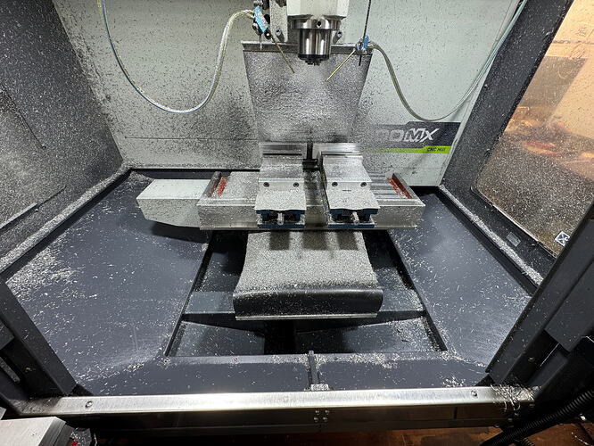

Message me and I will send you the Fusion360 model. You have to scale it up for the 1100mx. Since I don’t have one I don’t feel comfortable charging anybody for it. So if the model gets you started and you can build a working version from it, awesome. I had all the sheet metal made from OshCut and there is some welding to make it work.
Amin,
Hope these pics help
Any questions ask away
Ed
Front Y Axis
Rear Y Axis
Z Axis
