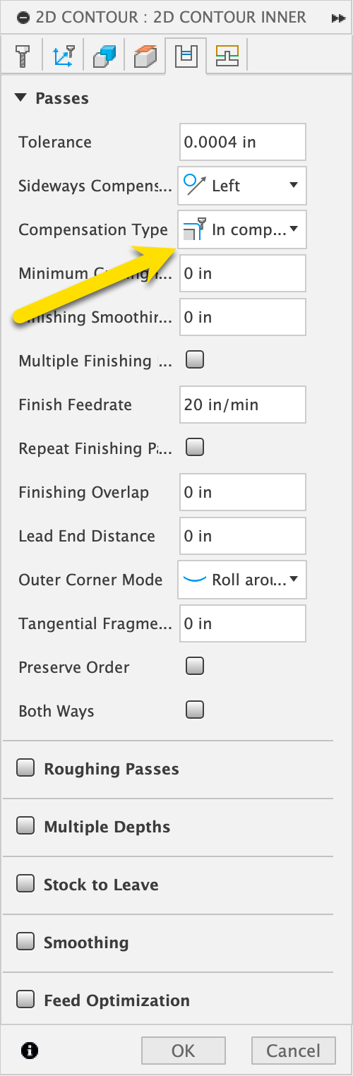

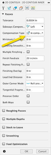

I use Fusion and cutter comp and it works as expected… as long as I remember to turn it on.
Cutter diameter in PP not doing anything is a classic sign for me it’s not turned on for that toolpath-- Fusion defaults to ‘in computer’ (ie: ignore PP diameter) plus doesn’t have it in some toolpaths like adaptive clearing.

I use Inventor CAM on a PCNC 1100 . By choosing “In Control” or “Wear” the CAM output uses cutter comp G41, G42 and reads the cutter diameter from the tool table.
If you are trying to sneak up on a dimension, this is a great way to go because you just change the cutter size and rerun that part of the program. The CAD model stays accurate and no CAM revisions or reposting is needed.
“In Control” uses the size of the cutter i.e. .500, .496 etc. This will sometimes lead to PathPilot erroring out at the compensation line when loading, especially in small pockets because the internal parameters think it won’t fit, even though the CAM runs it fine. To avoid this, use “Wear” and the number in the tool table is the deviation from nominal size of the cutter, i.e. 0. , -.004, etc.
Often I am only making one of something or repairing an item, so there’s no option for setup parts. I will set my cutter size oversize i.e. .510 or +.010 for a 1/2" cutter, then measure and adjust the tool table . Note the second pass will take a little heavier cut if your finish pass was aggressive (like the amount you changed plus a spring pass) but subsequent passes will only take the reduction.
So if you were .010 oversize and you reduce the cutter by .005 the next pass will be .003 oversize (.007 cut). A third pass reduced by .003 will be truer to the change and put you right on size.
