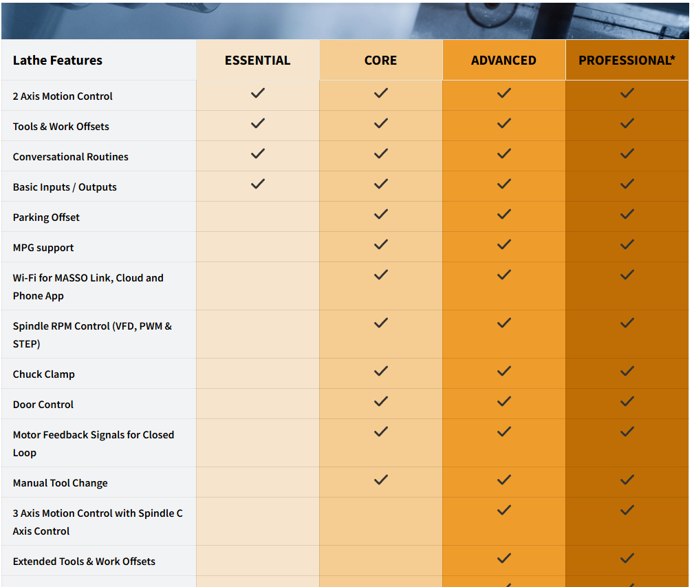

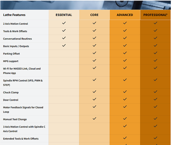

Change from Pathpilot to Masso controller, possible?
They supply lathe controller with touch screen, no computer
Anything is possible with enough time and money. Not sure what you’re hoping to gain from it though, unless you just really don’t like PP.
I suppose if a person had an old machine with a dead controller this would be an option rather than buying a new PP setup from tormach, but for what seems like similar pricing, I’m not sure I’d want to give up the support from the tormach team for an entirely custom setup.

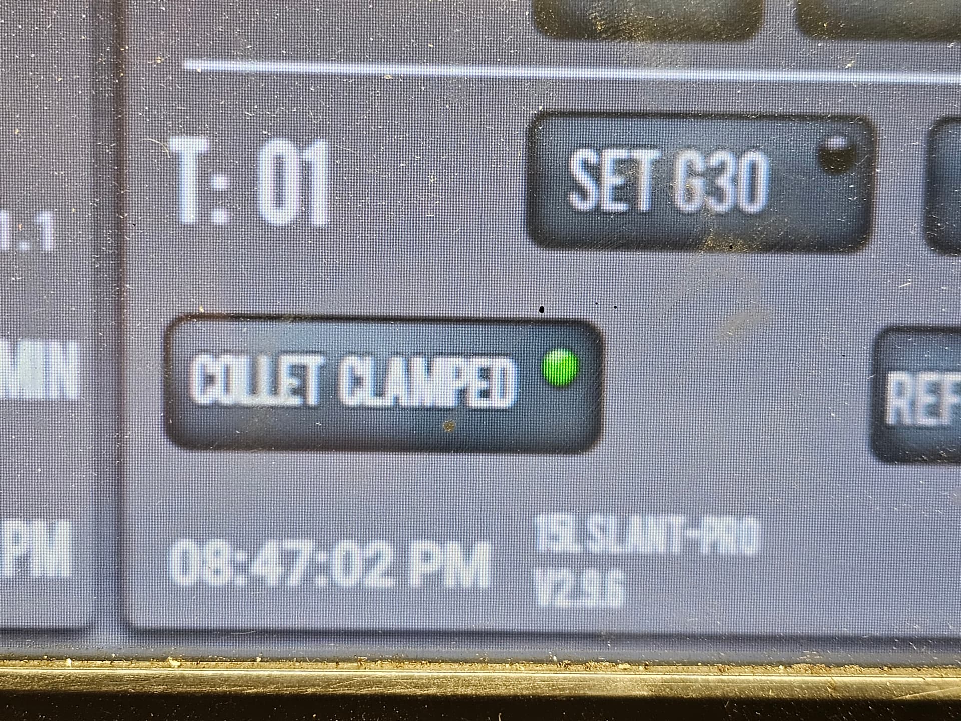

Thanks for the reply, I looked at Tormach website and could not see that option for the 15L. Does it happen to you also when a program stop at the end, and you open the door, and you get a splash of coolant in the face. Asked a couple of times for a fix. Very often, if I ask for tool T0303, the offset number will stay the same, On the screen, it will show T0305, 05 being the last tool I was using.

Coolant splashing when the door open is not a normal behavior. I’d recommend opening a tech support ticket so we can track down what’s happening. Can I also ask what version of Pathpilot you are on?

It’s not really when I open the door, it’s when the program terminates, goes to G30 and then the coolant splash happen, obliviously, if I open the door at the same time, I get some coolant on me.

So aside from not having a pc what does the Masso controller do that the pathpilot does’t on a lathe?
Dave
Just imagine, I’m paying in Canadian dollars and you add 15% taxes and duties.

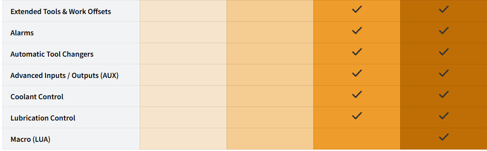

I think I have it for 7 or 8 years. I bought the turret at the same time and the new collet closer 2 years ago. Every time there’s a Pathpilot update and read the PDF, again, nothing for the lathe. That’s why I was asking if anybody replaced the controller. I know with the controller I posted about above, I could use a servo motor for the spindle (C axis)
More stable machine, no computer and no Linux, I know nothing about Linux. More programmable inputs and outputs. Add personalize function button. MPG. The only thing, I will have to learn is if the turret can work with this controller. What each wire do to the turret. They tested it with many tool changers, and it was working. At the end, I was just asking if somebody did something similar.
@Daniel_Jeffrey - the issue you describe with coolant briefly toggling on and off was fixed shortly after we heard about it from a customer and the fix is included in PathPilot versions 2.12 and newer. I recommend updating, which you can do at the controller if your controller is connected to the internet, or by downloading the update file here.
”T0303, the offset number will stay the same, On the screen, it will show T0305, 05 being the last tool I was using.”
If you’re willing to create a support ticket, we can get the log files from you and try to determine what’s happening. We have not heard reports like this from other customers.
I’m using version 2.9.6
