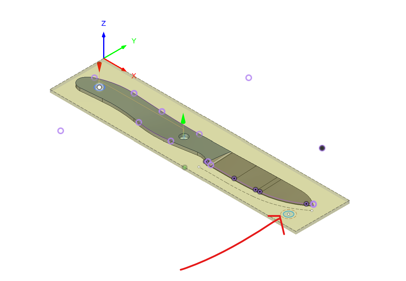

  2. The location of one of the holes that needs to be bored in the knife blade stock is located by a sketch so there is no hole to select. Even if I select this sketch in Fusion (geometry tab), the “Bore” tool path will not bore it. I used a 2D contour command to bore this hole instead. Is there any way to use the Bore toolpath? See image below.

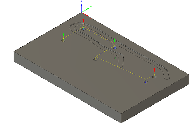

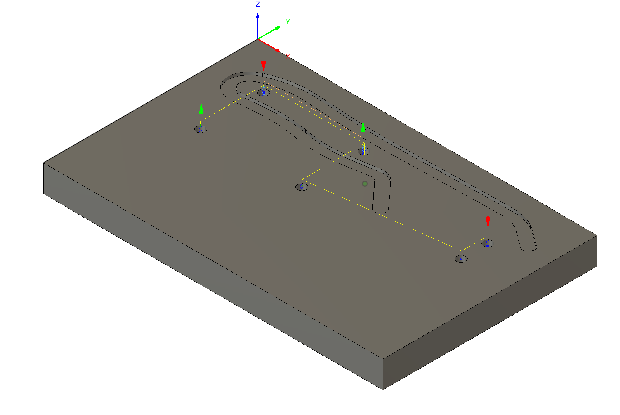

BLADE STOCK:
FIXTURE:

  2. Not without extruding the sketch to make the actual geometry. Bore requires a cylindrical or conical wall. You can achieve the same effect with contour using a ramp entry though. Contour with a ramp is exactly the same as Bore, it just takes a few more clicks to set up.

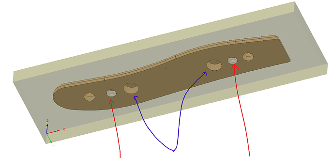

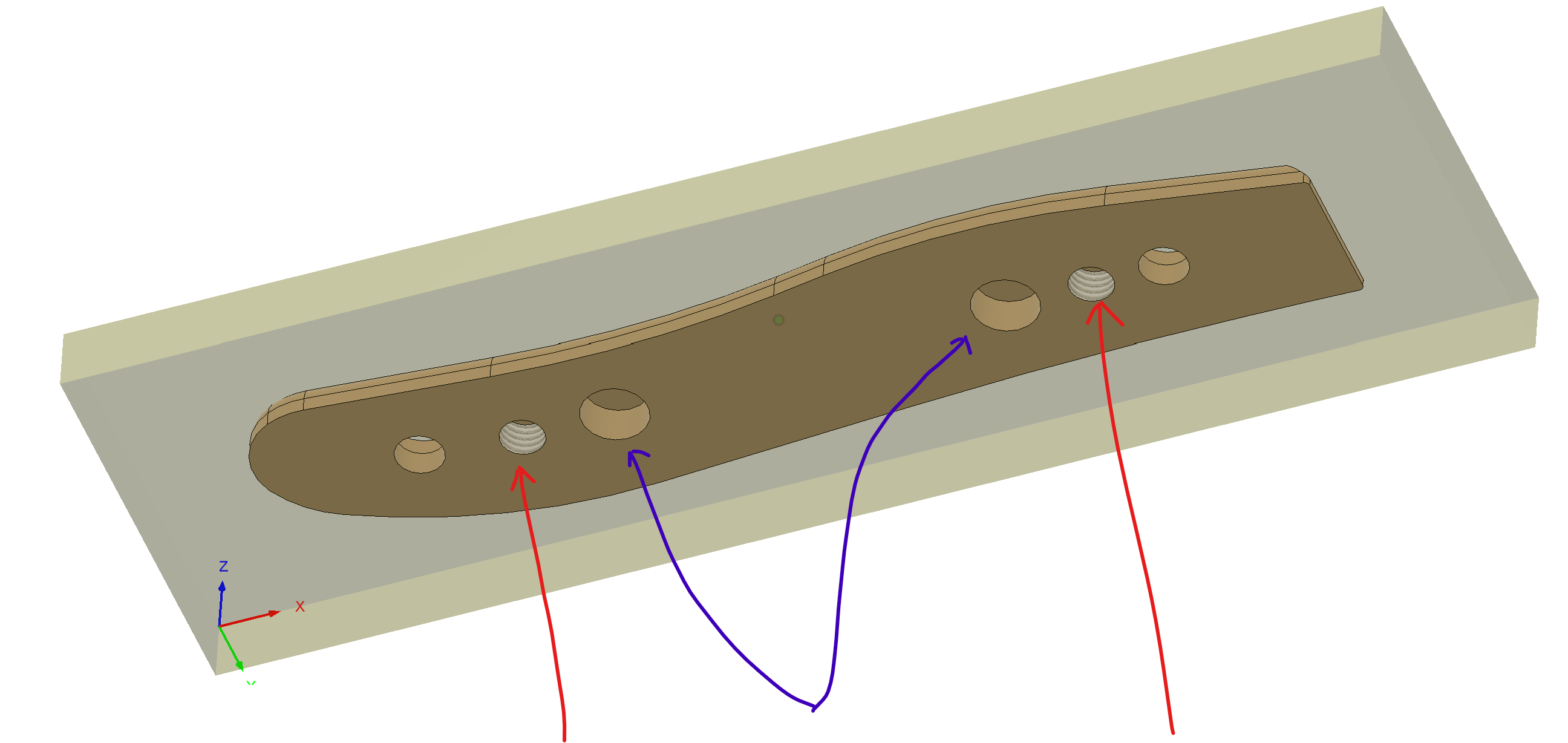

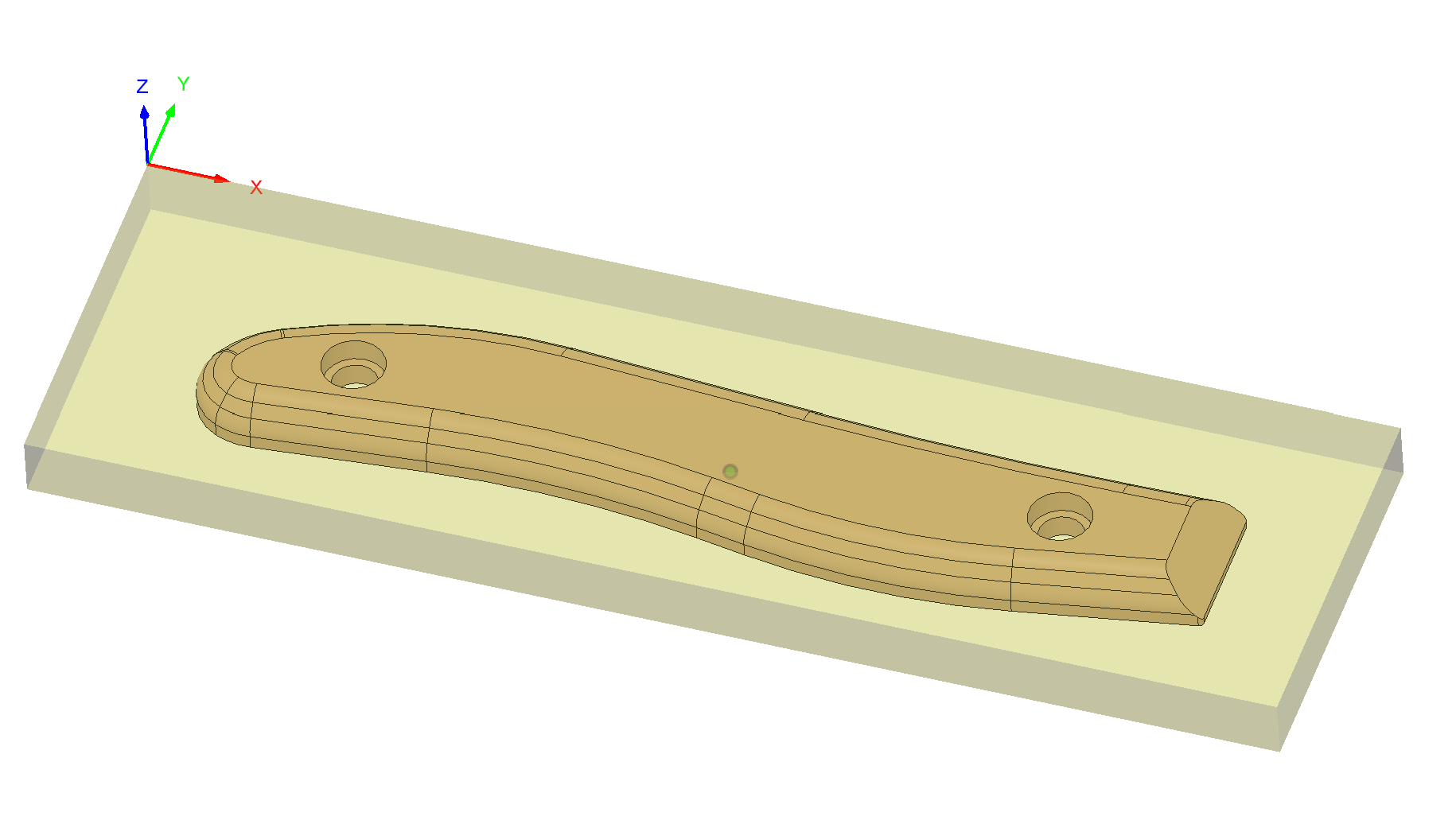

I plan on machining the knife handles sitting on a pedestal to raise them up so the ball end mill can reach. I plan on using m5 screws screwed into the bottom of the handles (red arrows) and registration pins to locate the knife handles (blue arrows). The registration pins shown are 1/4" diameter. Do you think I can safely use smaller diameter pins?
Knife handle - bottom view:
Knife handle - top view:
Thanks for all the feedback… Richard
