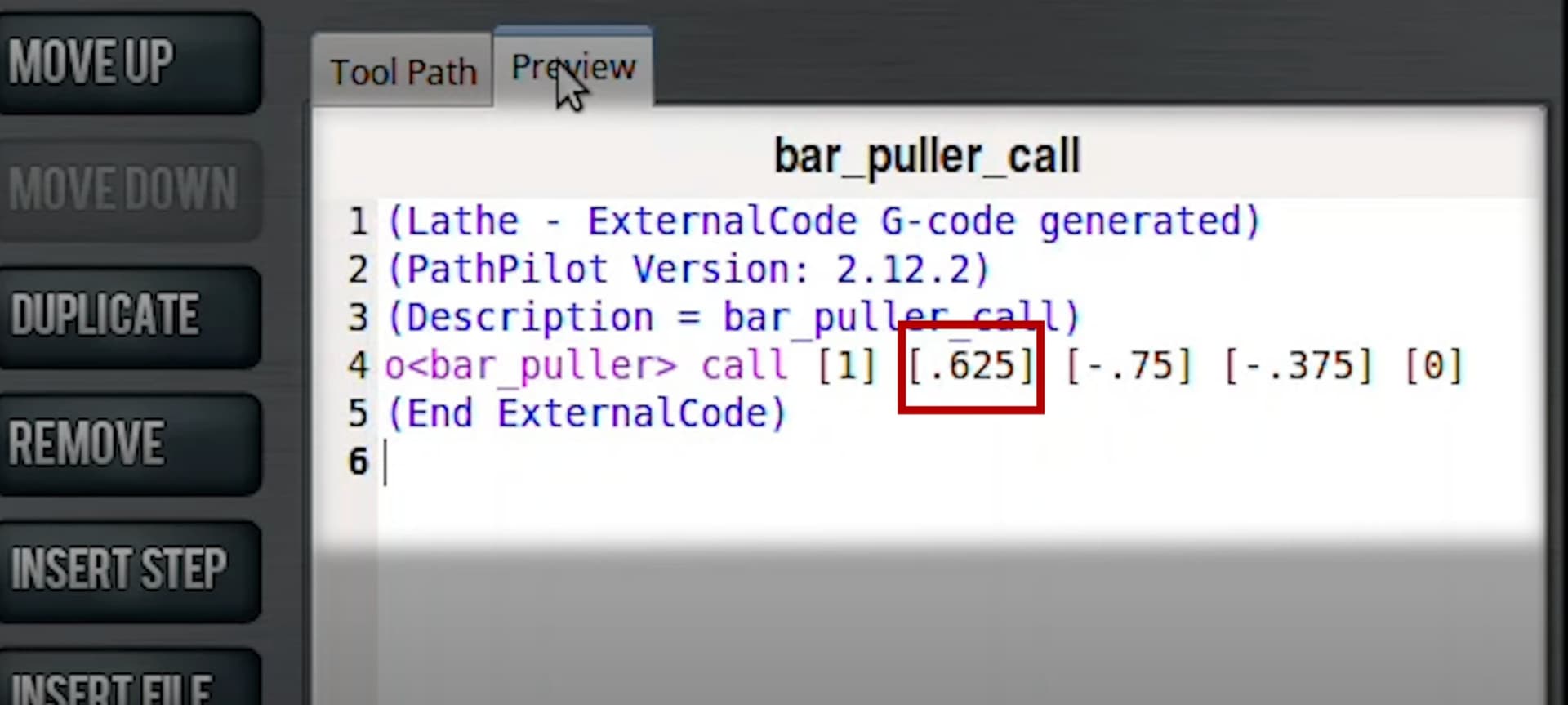

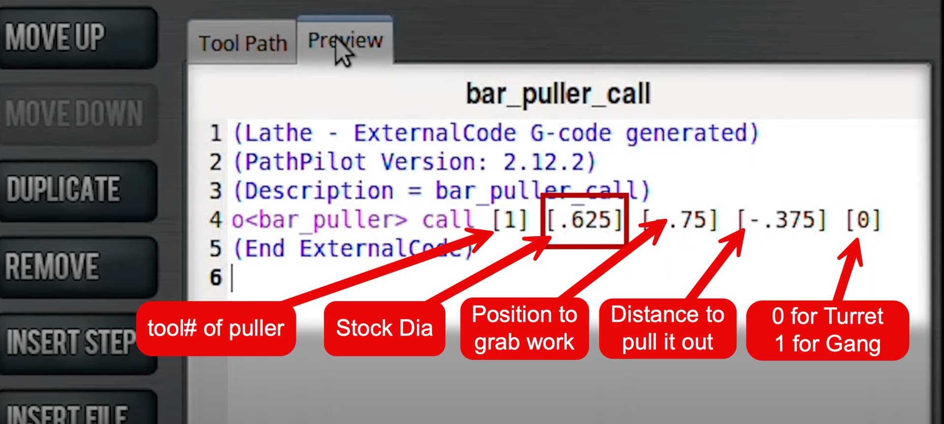

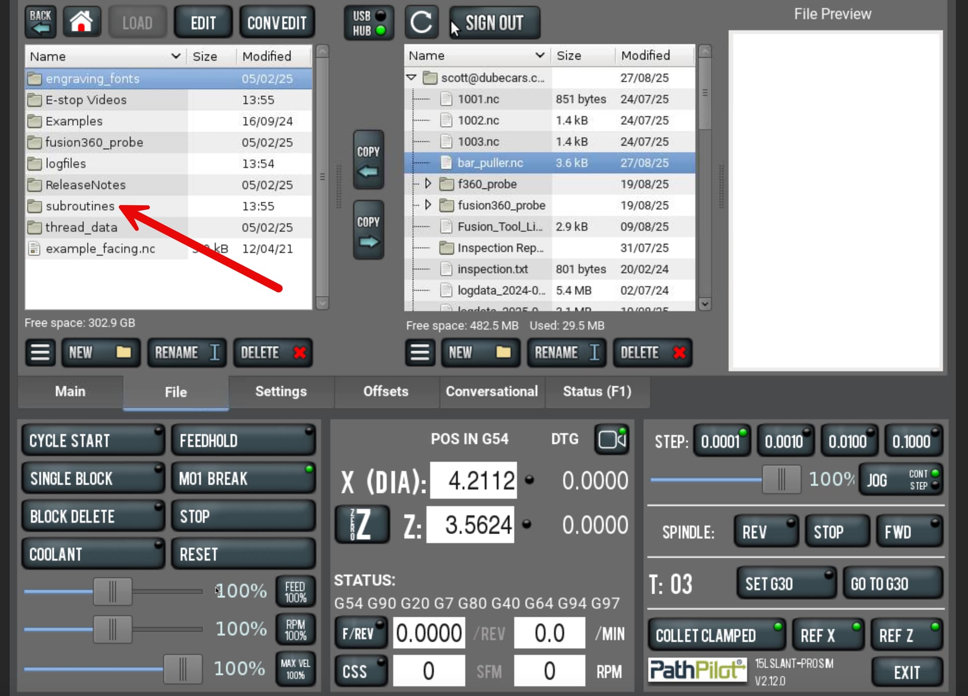

@Christopher, I see about 146 lines in the bar_puller.nc file. I think the confusion arises because you do not need to do anything with that file except place it in the subroutine folder on your lathe. See photo.
The line of code you need to configure for your job is seen in the video and pictured here (line 4).
That needs to be in your gcode for your job.
The other thing is to create the M99 loop as Norman shows in the video. I hope that helps a little.
I spent a little more time on this to figure it out, I don’t have a bar puller so this was new to me. You need to put the bar_puller.nc in the subroutine folder. Then you need the o<bar_puller> call with the parameters in your gcode file.

@Abram_Friesen The bar puller macro works in inches or in metric. I don’t know what you mean by “the one I have do not look like this”. You need to change the arguments of the bar_puller call to suit your setup.

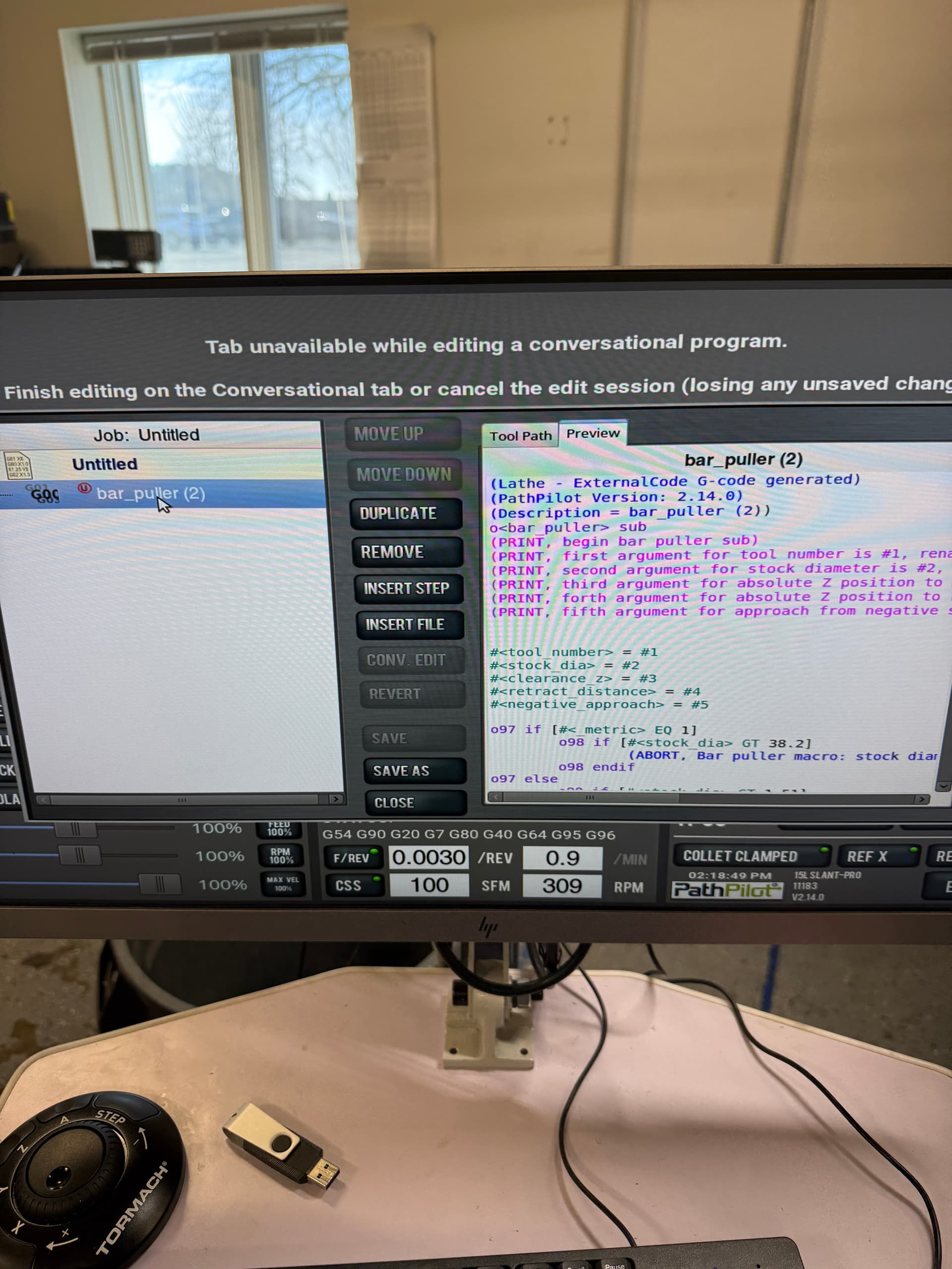

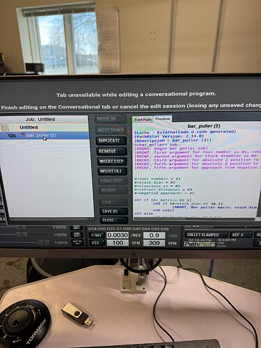

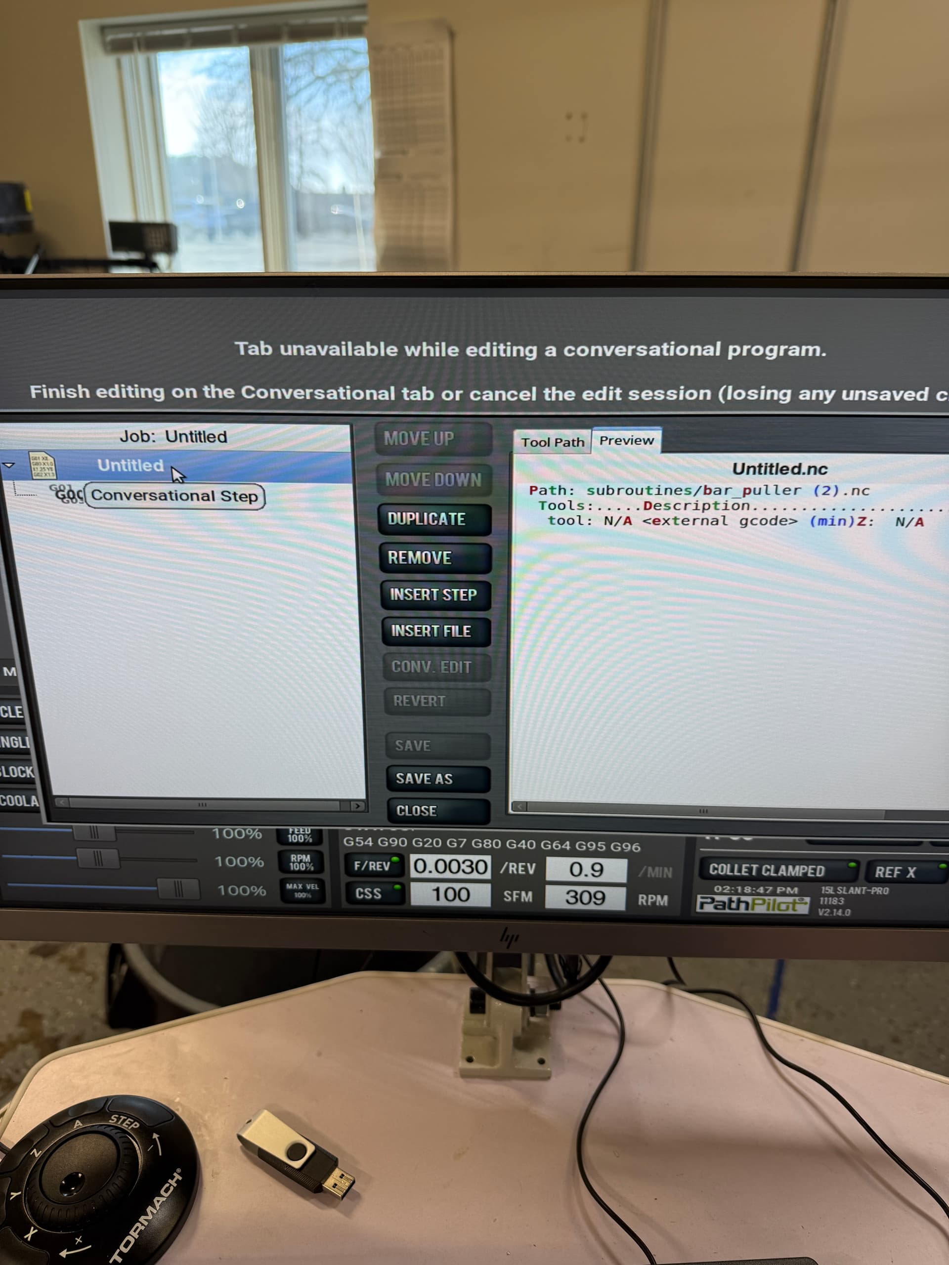

I think I am struggling with the same problem as @Abram_Friesen , here are some screenshots of what my file looks like when I try to conv edit my part file with bar puller.nc. I cannot find a place to add the arguments described in the video
Justin,
You are attempting to edit the bar_puller macro itself, do not do this. If you follow the example in the video we made you make a separate program just with the line to call the bar_puller macro and the arguments. You can also edit the conversational program itself to add the line but I’m not a fan of recommending doing so in a lot of cases, when edits are overwritten vs not is messy.
