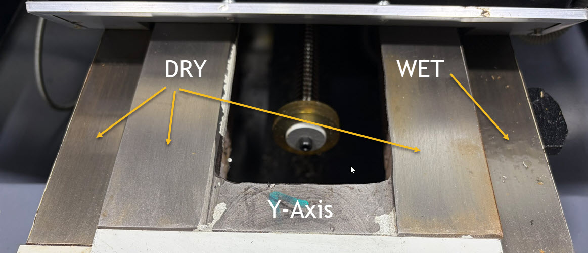

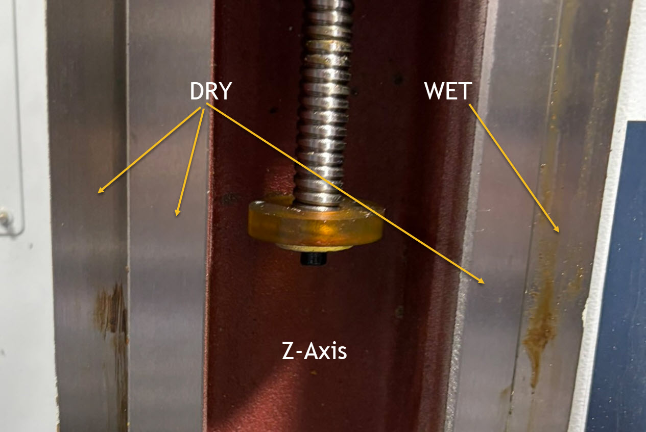

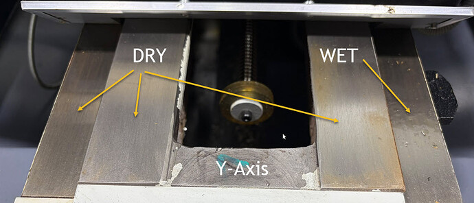

Edit: I realized I could open up the Y and Z bellows. Attached is what I see. It does seem that there’s a problem. Not sure if all surfaces should be “wet” or just outside. Unsure how I would do similar for X. And then of course…what do I do about this?

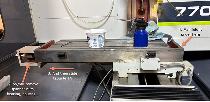

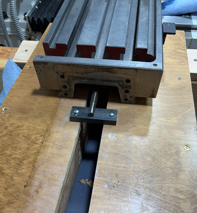

I’ve started the process and I could use some guidance. I’m awaiting hook wrenches to remove the spanner nuts that are in the housing. But in the meantime, I’m now confused as to the plan. I need to get to the oil manifold and fittings that are underneath the righthand side of the table. See below. Is the idea that I remove the housing, etc. on the left and then slide the table further to the left to expose the manifold that’s under the right end? In which case, I should probably start with the table shifted further to the right?
And if above is the idea, then I also need to create some supports (wood) that will hold both the table and the ball screw. Correct?
You should be able to do as you described.. on the 1100 the distribution block is on the other end
You will probably have to remove the casting on the left side to allow further movement to the left
You may want to just pull the table completely since you’re this far… if it can be lifted… the 1100 would need a hoist for sure… also since you’ve gone this far… idk how much time is on this machine but bearings are easy to replace

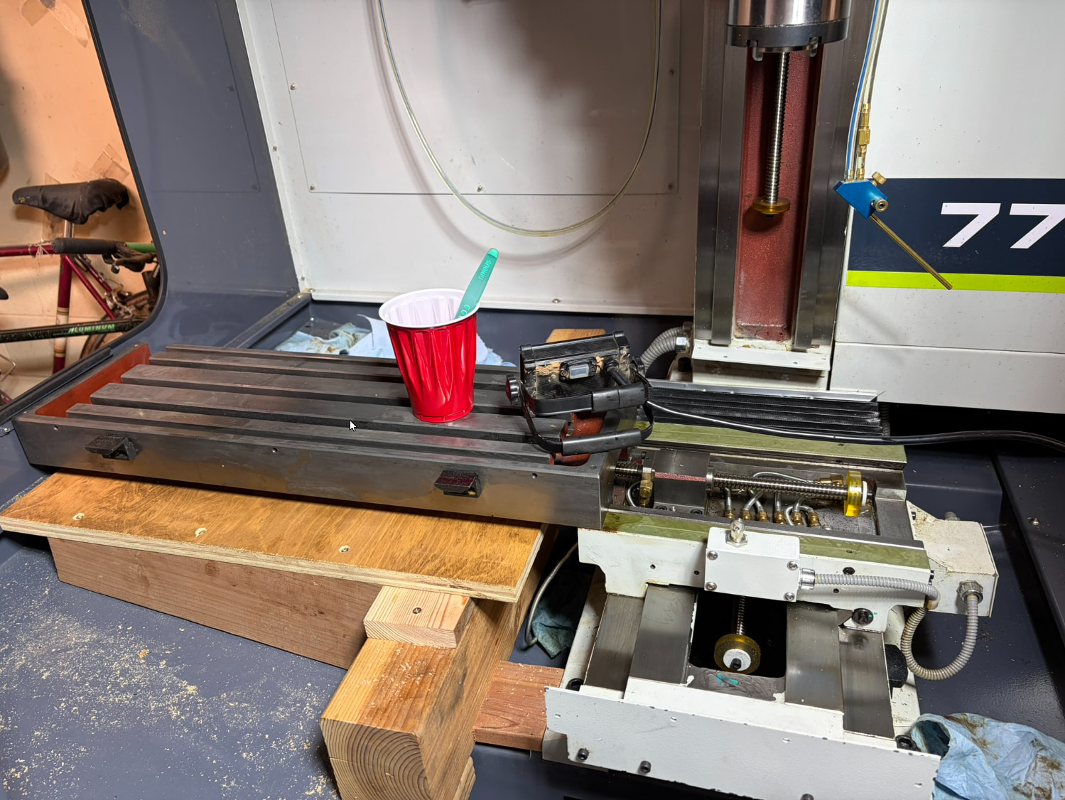

Any idea on the weight of the table. I’m guessing over 100lbs. I don’t know but I wouldn’t remove it completely unless you have to. Seems like a nightmare trying to support it with the enclosure in place. Unless you have a wood platform you can slide it onto as the table comes off the saddle.

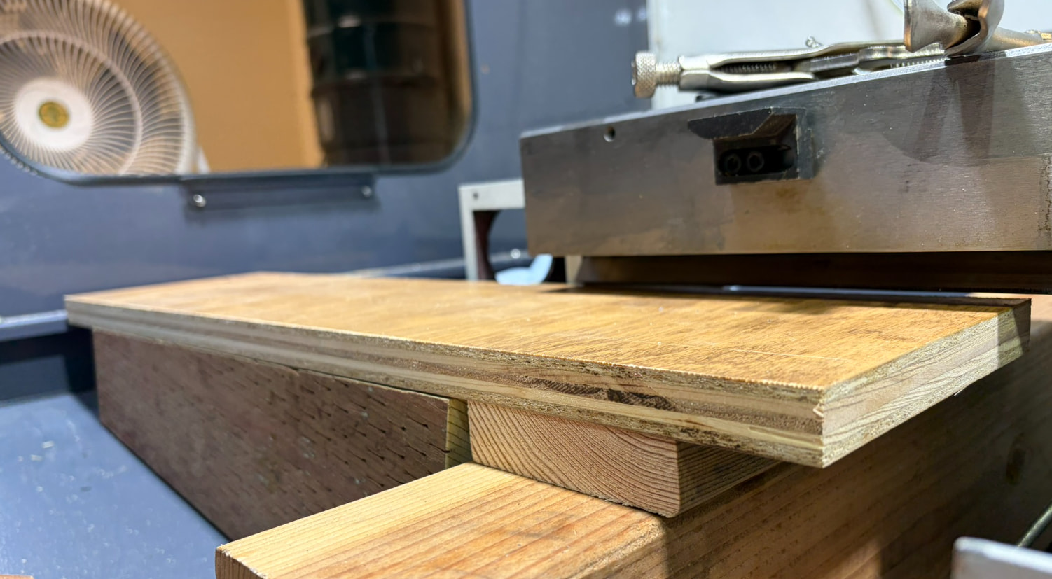

I guess I’m doing this. Support platform taking shape. I’ll put some UHMW tape down for the rails to slide on.
And….it’s opened up. Well supported by the platform which is actually front and rear halves. And between the platform halves there’s a small steel saddle that is supporting the ballscrew.

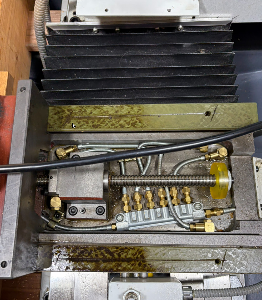

Anyway, now we can see that there’s a lot of junk on the ways but it was also pretty wet. You can see I’ve cleaned up about half of both (my wife’s toothbrush in the solo cup of mineral oil :wink: worked quite well). I’m now running a small experiment with mineral oil on a section without scrubbing to see how well it loosens things as this may be the answer for the Z-axis. This also clarifies something I was clueless about: What the oil channels actually look like. They are literally human scratched channels in the surface. Did not expect that.
Next step: I’m planning to replace all the fittings and hoses. Probably not 100% necessary but on the chance that one or more are gummed up, better to replace everything than to find that something doesn’t work right after it’s put back together. I don’t have pricing yet but I understand the parts are quite reasonable.
The y-axis appears to be quite wet from all the oil I pumped in at the start. More testing needed but I’m hoping to avoid going through this in the Y direction too. It would be a bigger deal because I believe it would require me to (a) fully remove the table and (b) as there’s less front-to-back room, I think the housing would have to be disassembled.
For the Z-axis, I’m still worried. I can pretty easily get fluid to flow to the outer ways but not so consistently to the inner ways. I’m not even sure how lubrication gets to the inner ways as the emitter appears positioning only to address the outer ways. If anyone knows more about this, I’d be grateful for input on this.
Note to those who may read this in the future as part of their own 770 disassembly: Once the spanner nuts and the bearing cover are removed from the inside of the motor housing, the motor housing cap screws can be removed and the housing can be slid off. It can hang up along the way but it’s just a snug fit. Most important thing: Once that housing is off, there’s nothing to support the left end of the ball screw so you have to have something prepared to hold it BEFORE you slide off the housing. I used a piece of half-inch high steel c channel, flat side up, screwed down to front and rear support platforms and positioned against the flat part of the ballscrew. Once the ballscrew is supported and the housing is off, the table can slide to the left pretty much unimpeded. Fortunately I was very careful about making the platform level with the ways and so movement was easy and very smooth. I have not removed the gib and don’t plan to (one less thing to have to get right on the way back together).

Sorry, I guess I wasn’t clear enough. You didnt have to take all that apart. Unbolt the motor / cast iron frame from the table while supporting it. Remove gib. Slide table to the right a bit. Table comes off.
Looks like the ways are riding heavy on the left side. Gib adjustment probably. Look for the little straight slot plugs. Clean everything and pump oil till it comes out everywhere. No need to replace lines unless they are kinked or really old. Snug all fittings. Remember gib adjustment changes everything. Recheck tram etc. While you’re at it, adjust the other gibs too. Might as well before you check everything. Play with snugness. You can put an indicator on one end and lift. See how much it moves. You won’t get rid of all of it.
Bruce - “Looks like the ways are riding heavy on the left side…” What makes you say that? If it’s that you see that on the right the ways are clear, that’s just because I cleaned that area before the photo. The entire ways looked as that carmelized area when I first opened it up. Am trying to avoid taking the table off because (a) it seems really heavy and I don’t have a lift, (b) more alignment work to be done if I do and (c) doesn’t appear to buy me a lot that I can’t already do with sliding it to the left.
Ah, ok. As long as the turcite looked uniform when you slid it over.
No table alignment necessary. Gibs do it all.
Thanks to everyone’s help…as of this evening my 770MX is back to making chips. Many hours invested in disassembly, cleaning out the lubrication system, recalibration and reassembly but we’re back. Thanks to everyone’s help. A lot learned here…perhaps most importantly not to let the mill sit for 5 years!
Charlie
Not too bad huh. Where you can run into trouble is messing with ball screw nut position. Gets a little sticky unless there were locating pins. Alignment of those need to be pretty close.
