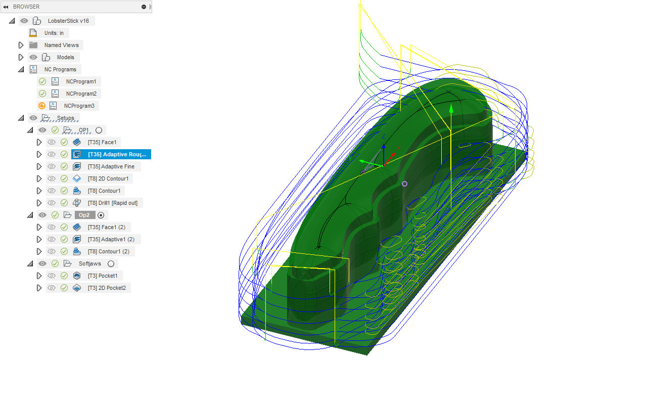

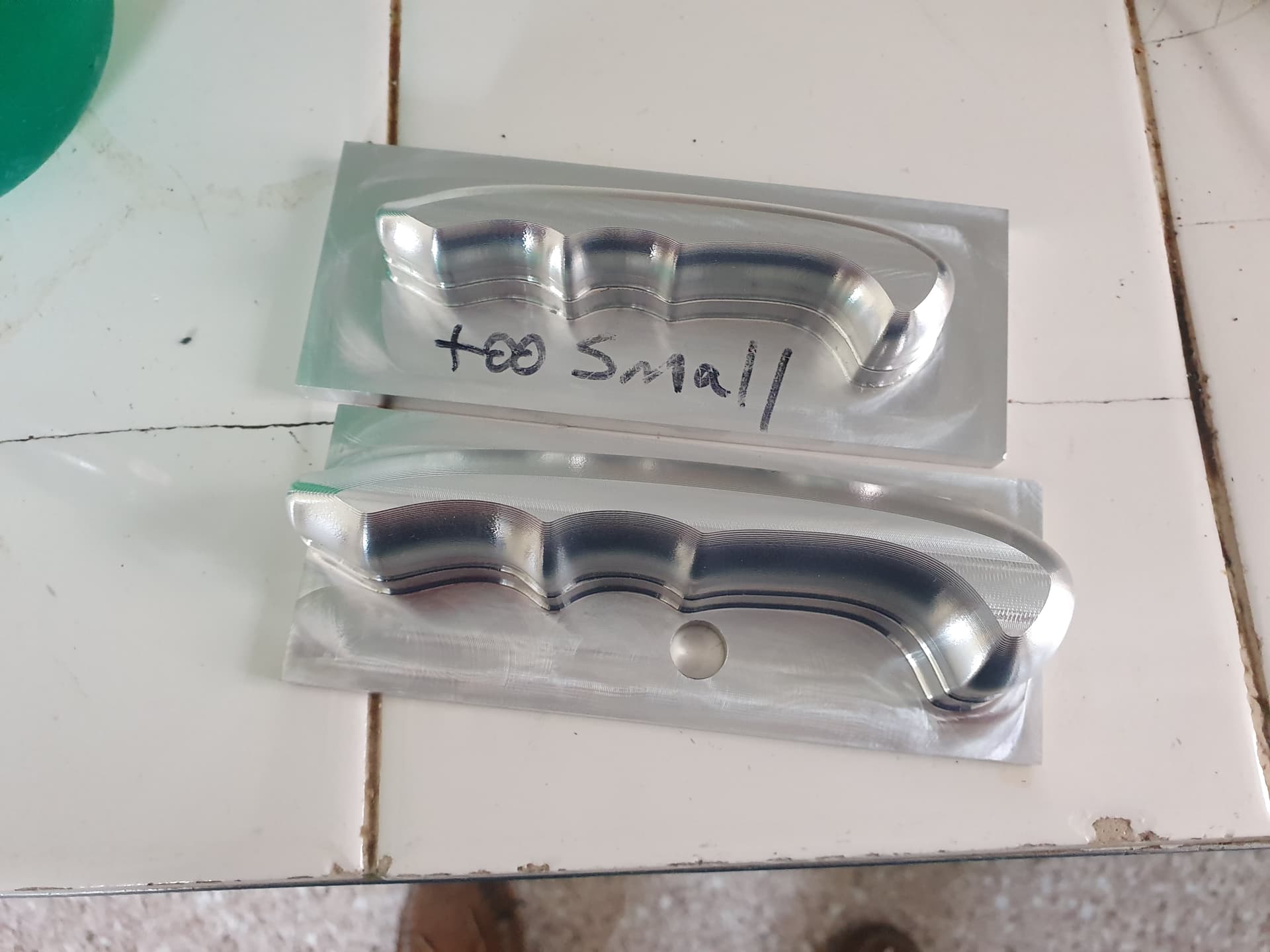

For the local makerspace I did a presentation on how I duplicated a “lobster stick” for my dad by sketching on top of a picture he sent me and then running CAM against the part that I made.
Here is a video of the process and I will put the slides from that presentation below. This is intended as a high level overview of duplicating a simple geometry part on your CNC machine using Fusion360. please excuse the dorked up audio on the video
