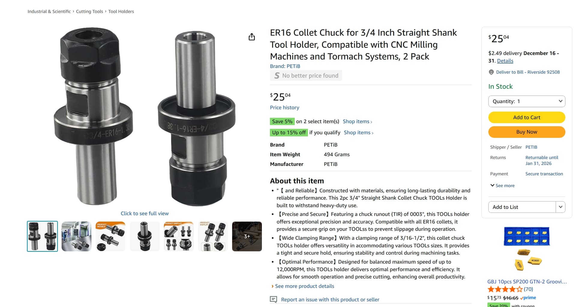

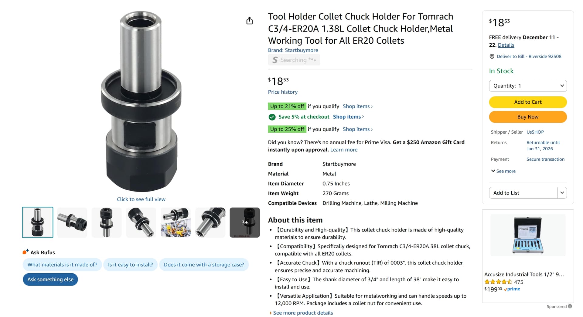

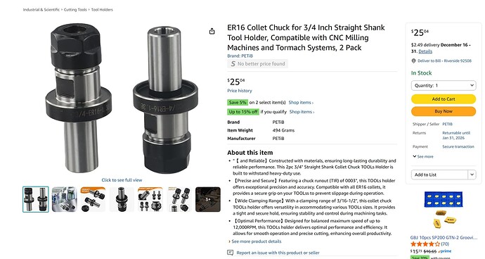

Anyone using these China off brand TTS holders?
Curious to see if anyone is using these? Are they cheap and good or just plain cheap and no good? Downside is they would not be compatible with ATC since they dont have the fork slot. ER-20 one is listed as Tomrach, :joy:
Nope. I break enough carbides without wondering if the tool holder is good.

One of the things that I like about the iCarbide holders is the 1/8in and 3/16in set-screw holders. In my experience, the reduced bulk at the nose improves coolant flow, but I concur with the above posts that the runout isn’t nearly as good.

If you’re using off-brand tools, make sure they match the standard TTS height — flange face to top of shaft should be 1.46". mine were 1.50 and 1.54…
PathPilot (PP) is programmed in the constants/py folder for a tool height of 1.46", with a lift amount of only .010" above that. I’ve asked the factory to increase that clearance, but they won’t.
So I modified mine.
I changed the tool height constant TTS to 1.55" and set clearance to .375". Yes, it requires a restart and you’ll need to redo it after each software update — but it’s worth it.
With the extra 3/8" clearance:
  • Non-Tormach tools no longer scrape the R8 taper
  • I haven’t broken a single fork
  • No more damaged screws
Since making that change, it’s been solid.
If you’re running mixed tooling, the extra clearance makes a big difference IMO.
Alternatively, what we did when I had TTS was machine the toolholders or flange-added-tools to the length spec. The ā€œhardenedā€ steel ER-16 extensions turned fairly easily on the lathe with carbide tools.
I use a bunch of these. I dont have ATC so ots fine.
BUT…. Its hard to find good ones. Majority I had to send back. The collet nut was always off centered. So be prepared to inspect & send back. If the collet nut isnt drilled center your tool runout will be crazy. Try different vendors. You will find one that sells good holders.
