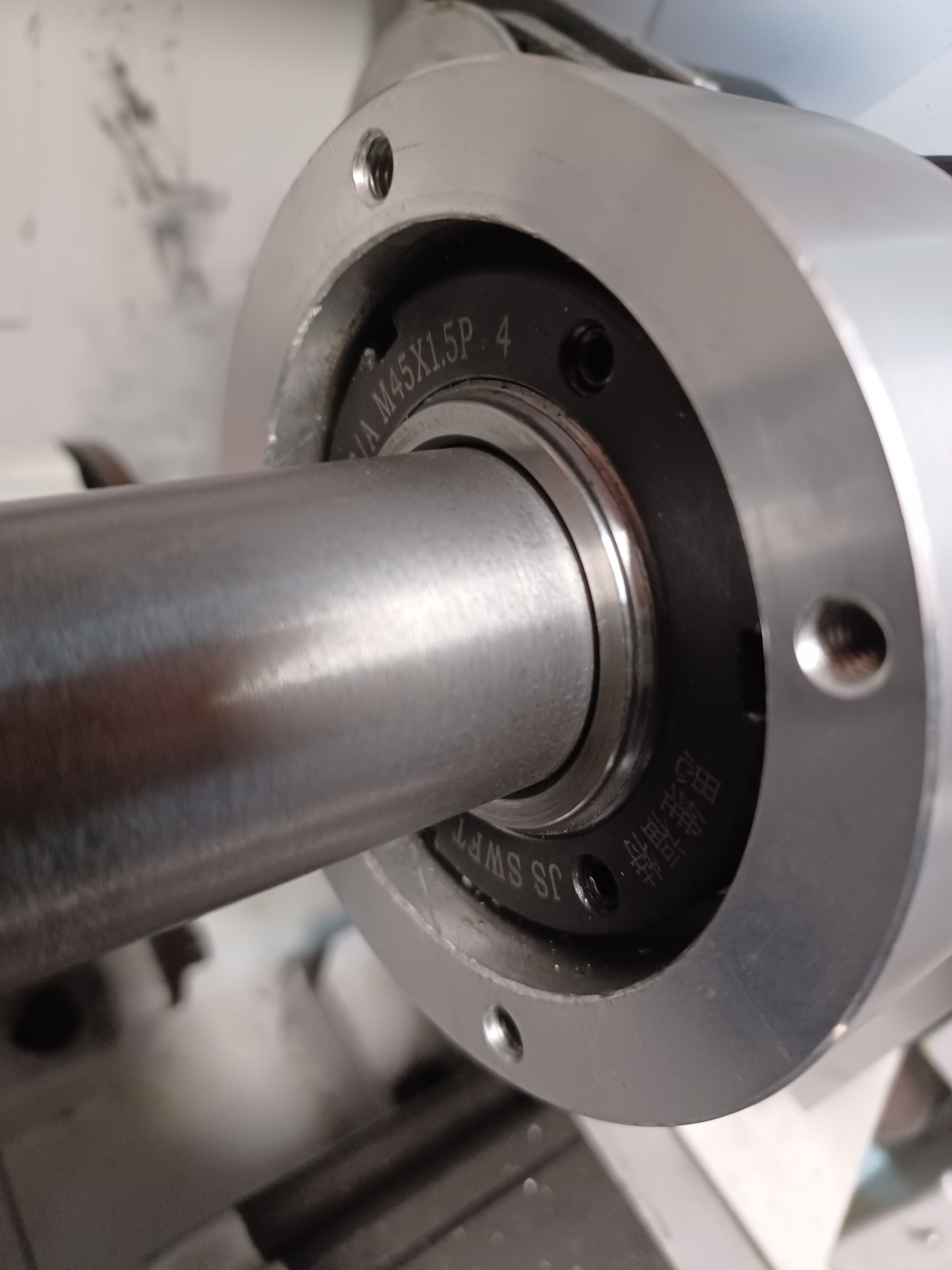

Well, I’ll reply to my own topic – I set up a support request and got an answer that supported my thought that you can adjust the play of the spindle by tightening the rear bearing retention nut.

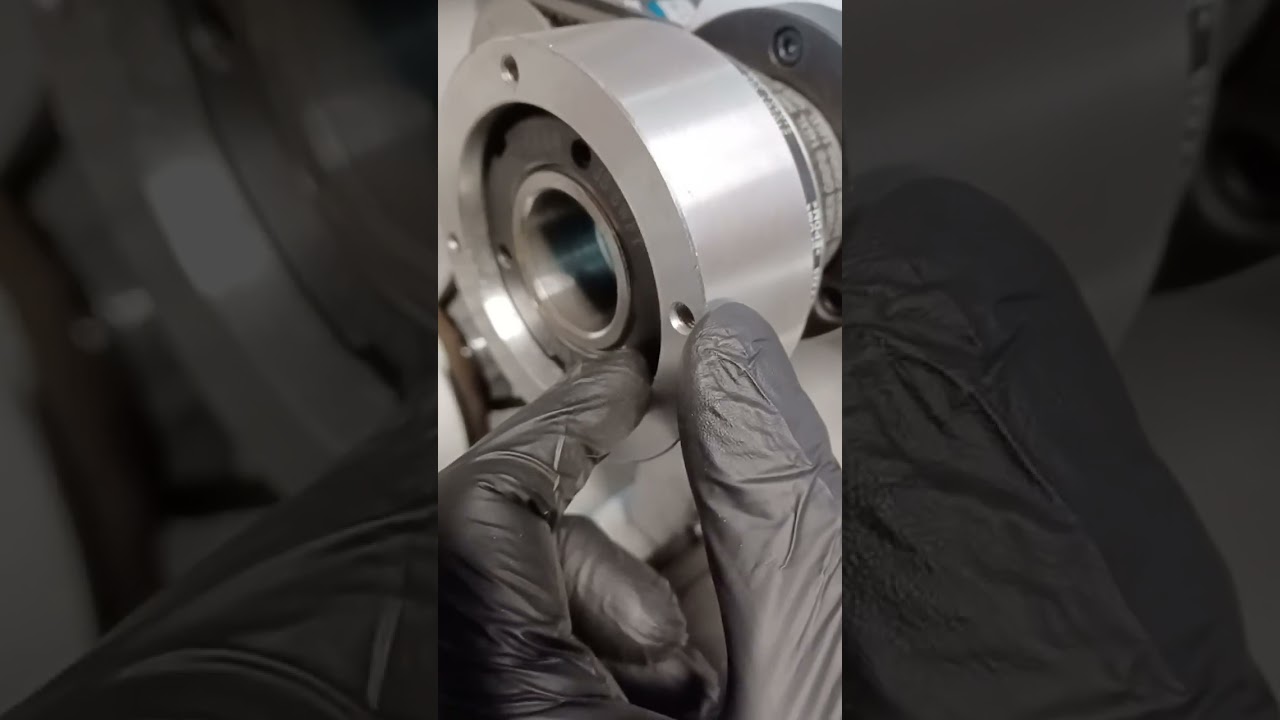

A special spanner is needed, ideally, but it can also be adjusted with gentle taps using a flat nosed punch on the two notches in the nut. There are a bunch of retention screws going through the perimeter of the nut that need to be loosened first. I’m going to take a look at doing this tomorrow and will see how it goes.

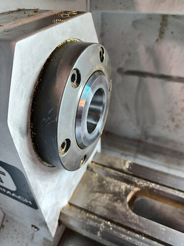

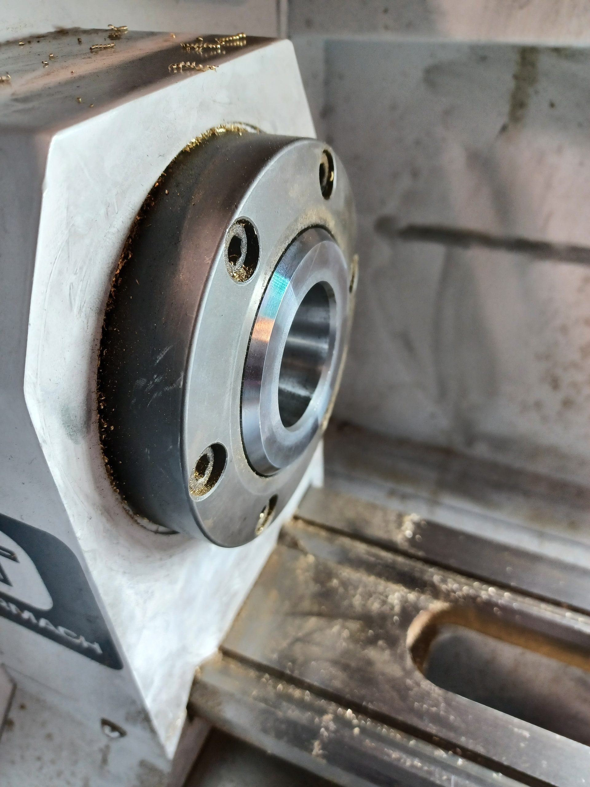

This is the way you adjust it. Completely fixed my issue!
You can see by comparing the attached photos to the video (which was before I was done, I made more adjustments) just how “out” the spindle was. The business end is now flush with the front retention plate. The spindle now is much more exposed through the rear bearing nut.
