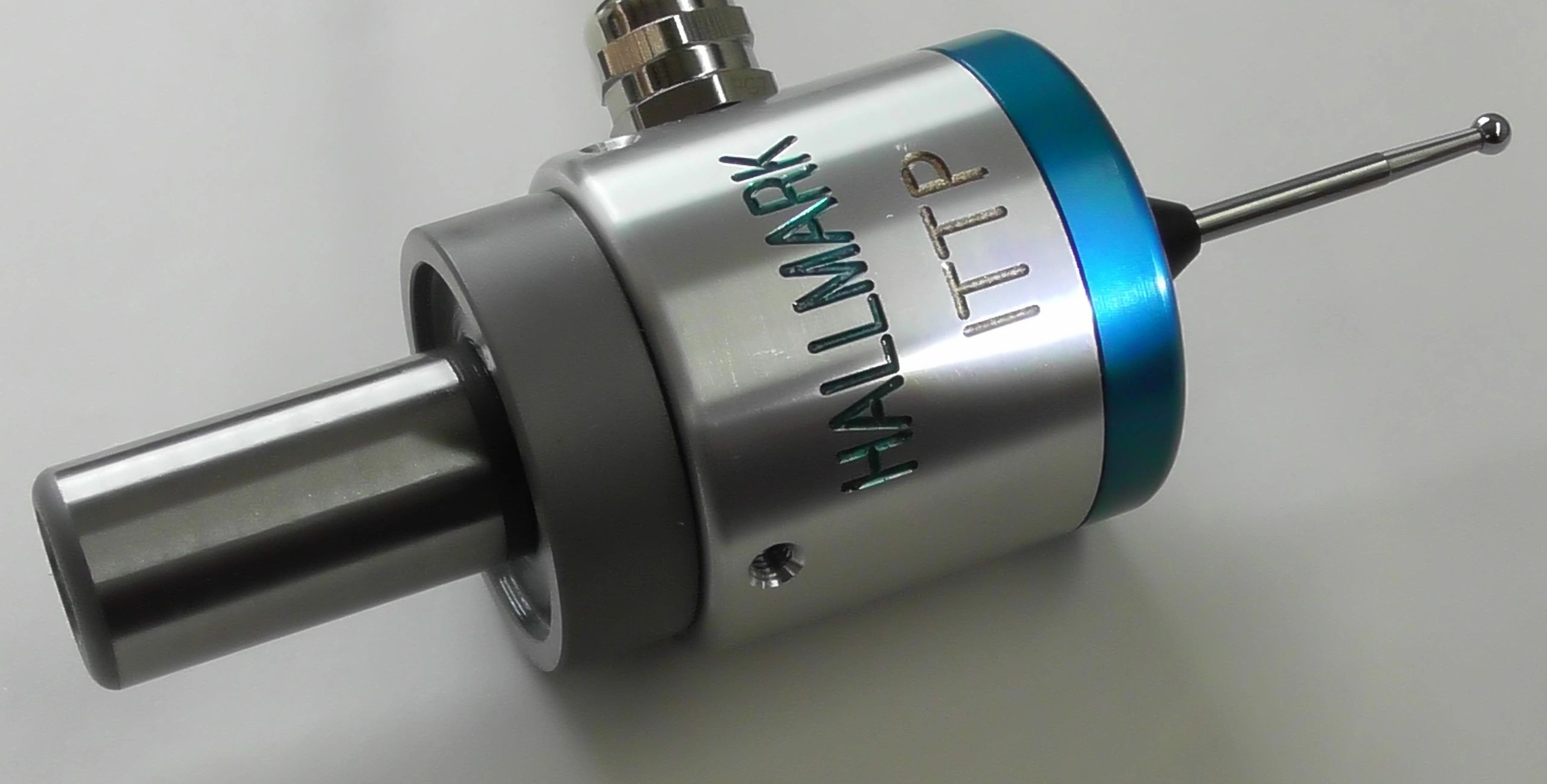

For a lathe tool, you have to touch off in both X and Z dimensions. That requires the equivalent of a high end mill ETS that can measure both tool height and the diameter. The one I saw was mounted on an arm that swings out to touch off and swings out of the way for turning operations. Not sure that you can mount an ETS somewhere that won’t get in the way while turning or not be reachable by the tool post.
They seem to use a mill probe in one of the tool locations of a 15L style lathe with an offset probe tip to probe the work.
Otherwise, you take a conservative cut on the OD and mic it (or the bore) and set your offset for facing…which is what I would understand is the normal process for a manual lathe that doesn’t have a probe or tool touch off…
Cliff Hall of ITTP touch probe fame sells lathe toolsetters that can help make this process more palatable:
