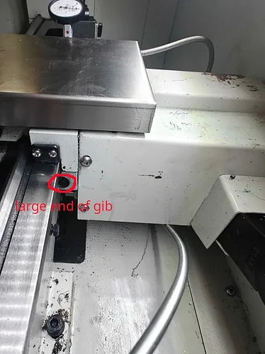

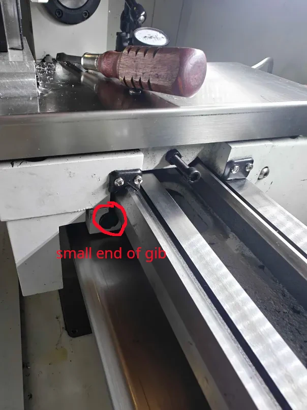

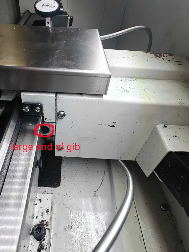

  1. Remove both gibs and ensure there are no burrs/nicks. This shouldn’t be necessary unless the machine is heavily worn. For reference my machine is from 09/2023 and I could still see all the scraping marks on the gib with only one or two small wear patches. The side with the notch for the retaining screw is the large side of the gib so it will slides out from that side. Clean as best you can and set aside.

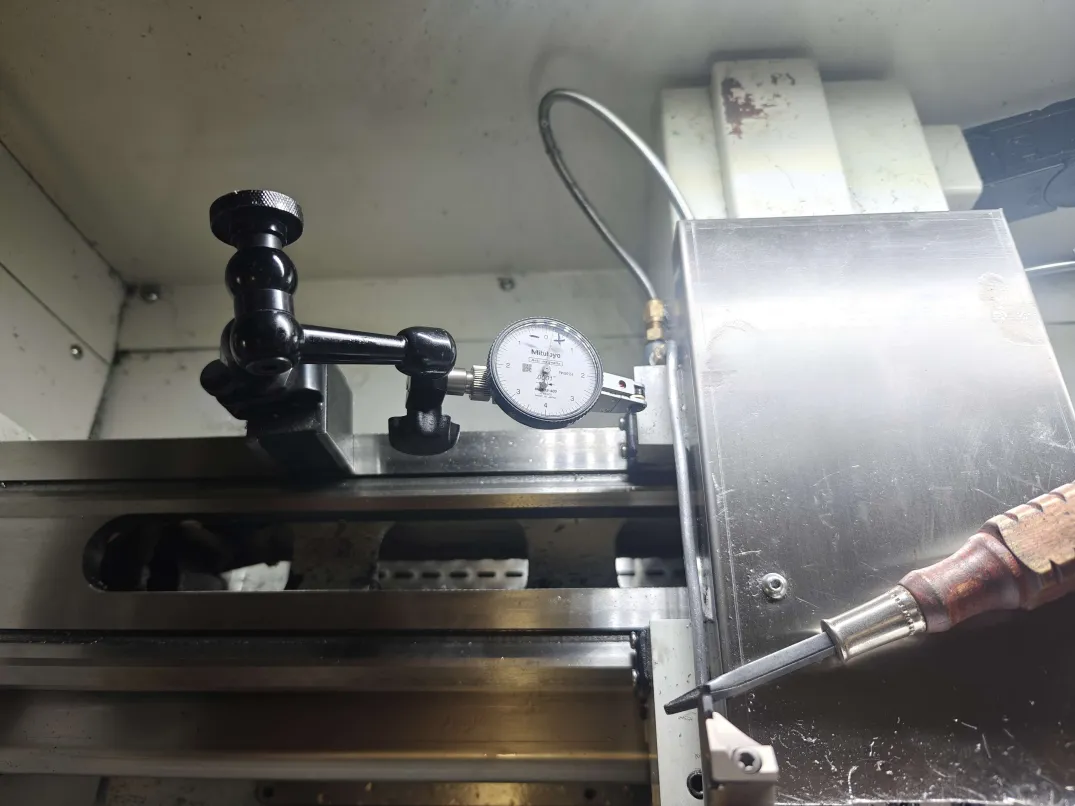

  2. Set up a dial indicator on the bed ways to check backlash in the movement of the machine with no gib influence. I used a 0.0001” finger dial for the increased sensitivity, and used the machine in the lowest step movement possible as well. Record the backlash number on a scrap to reference later.
  3. Before installing the gibs ensure you oil all bearing surfaces generously with way lube.
  4. With the indicator in place install the gibs and check the backlash as you tighten the gib. As soon as the backlash increases you know the gib is too tight and needs to be backed off. Back it off in small increments until the backlash just goes back to the previous recorded number.

Pictures of gib locations and which end is large/small, and showing the finger dial on the carriage to record backlash numbers

I should add for anyone referencing this that the 0.0001” indicator I was using was maybe a tad too sensitive for the adjustment. Using the method I described above I still found issues with the gibs being too loose. I further tightened them up and my surface finish vastly improved and you can’t hear any strain from the axis motor when moving the machine.
